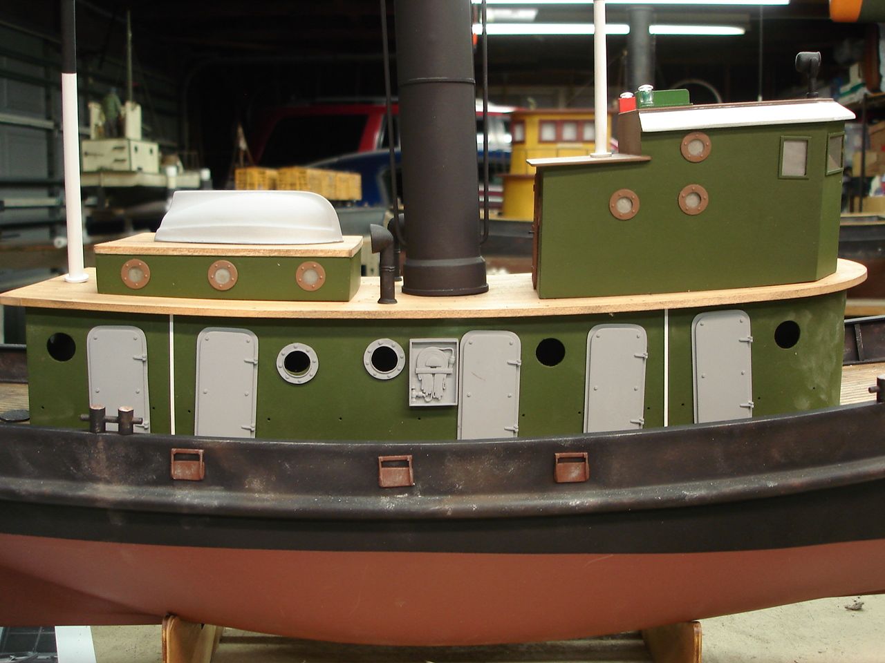

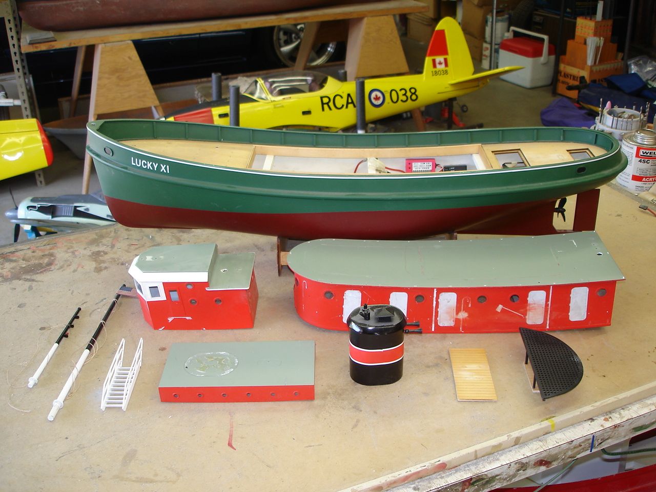

Hello out there,
I'd like to share with all of you a conversion I finished recently; a late steam period railroad tug. Scale is 1/32nd, length is 32". The model started out as a rc "ready to run" diesel semi scale model. The hull is fiberglass, with the the cabins being styrene. I wanted to back date it to the late 1930's. After disassembly, I began rearranging some of the fittings that came on the model, added more from the spare parts box, planked the upper deck with basswood strips to match the printed main deck. New resin watertight doors, and portholes were added, along with new brass railing stanchions. A piece of plastic sink pipe was used for the funnel, with Evergreen strip added. Styrene was also used for the scupper doors. Everything was repainted using spray can colors. Weathering was done using the basic wash/dry brush methods. Model car tires from the parts box were used for the fenders, and the front bow fender came from a mop. I also added a steam engine/horn/whistle digital sound unit.  Thanks,

Very cool!
But I have a suggestion for you. The deck planking looks great, but there are no fasteners visible. You can create "nail heads" with a sharp lead pencil. Just put the pint of the pencil down on the spot where the nail head would be, and "twirl" the pencil to make a dot. It's a little tedious to go through every plank and add all the "nail heads," but it looks much more realistic than no fasteners showing.

Thanks guys. Harry, I thought about the nail heads, but thought even the pencil point might be too large in 1/32nd scale.
