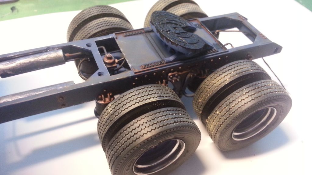

Hi guys.... Let me introduce me some photos of my newest project - KW W900 Aerodyne Snap Tite.
Chassis will be extended for 2cm. The reason is that I decide to make a version with 4 fuel tanks. It will be in matt blue so as fuel tanks.
The body will be in white combinated with modeltruckin decals (thanx to Jerry). I´ll use also awesome PE parts from CTM for KW W900.
Ready is wiring and some plumbing.
I also decide to make a new wheels "snowman" in cooperation with some older Italeri part, like rims and middles.This conversion were necessary because there are used Italeri 1:24 tires. Now are wheels more deeper, before it was very "fleet".
To be continued...Paul.

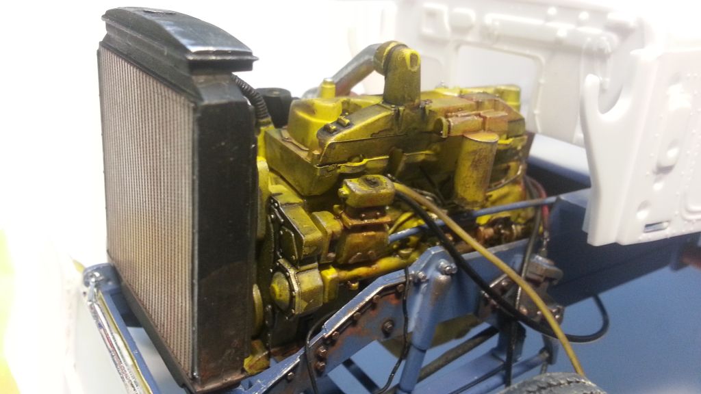

Posted 09 October 2013 - 04:45 AM
As I promised here are some new photos. Light rust weathering and engine is placed in engine bay. Cables are not connected yet. Front of intercooler is made from radiator mesh PE part from Czech Truck Model. Paul
Attached File  20131009_155853.jpg   94.16KB   1 downloadsAttached File  20131009_160035.jpg   87.95KB   1 downloads
Edited by Pavel A., 09 March 2014 - 08:02 AM.

Posted 09 October 2013 - 06:19 AM
Yep, it's lookin' really good! I like your detailing and weathering. your Italeri tire conversion is making this look so much better than the kit's tires, it's a natural change and the tires are the right inner diameter to do it.
What I'd like to know is, did you actually add another Italeri rim half to the inner part of the rear wheels also or just on the outer side?

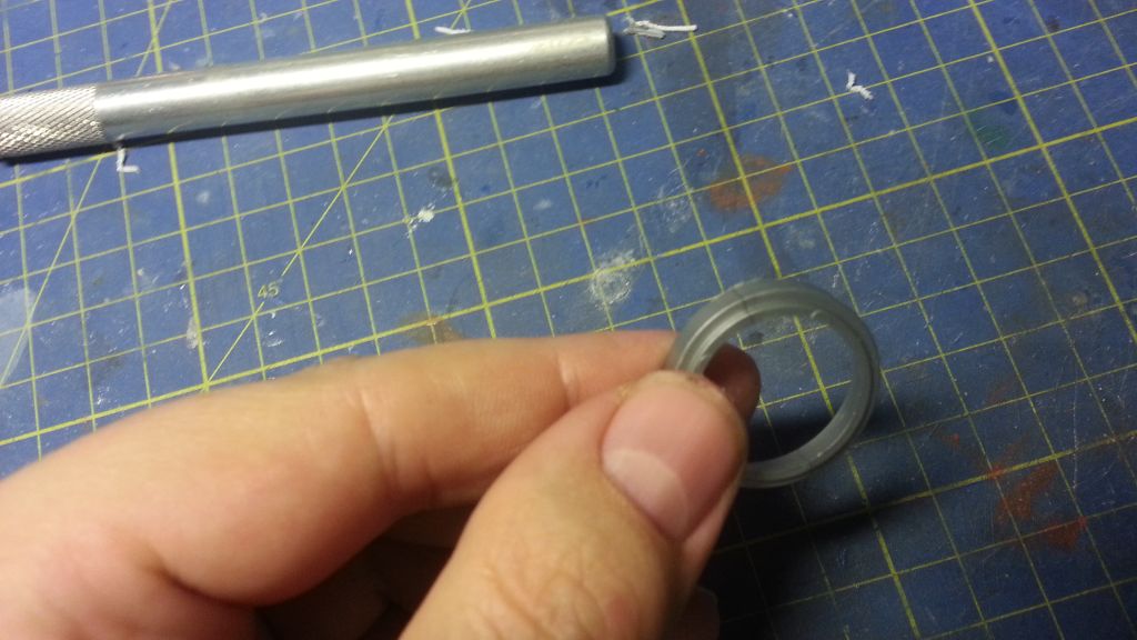

Posted 09 October 2013 - 07:21 AM
Robert, yes. If I can remember I used over there three parts from italeri. So it is - rim (italeri)-snap out.rim-middle (italeri)-snap inner rim-italeri rim. Center from italeri you must little grind.
Front are also Snap out-italeri middle-snap in. This centre makes on front wheels I can say "rim" where the tire is good locked...
#10 Pavel A.
Pavel A.
  • PipPipPipPipPip
  • 365 posts
  • Location:Nitra, Slovakia
  • Full Name:Pavel Amrich
Posted 09 October 2013 - 08:24 AM
Rob, here´s some photo of this center part from italeri, which I used...
Attached File  20131009_192537.jpg   93.64KB   1 downloadsAttached File  20131009_192542.jpg   74.98KB   1 downloads

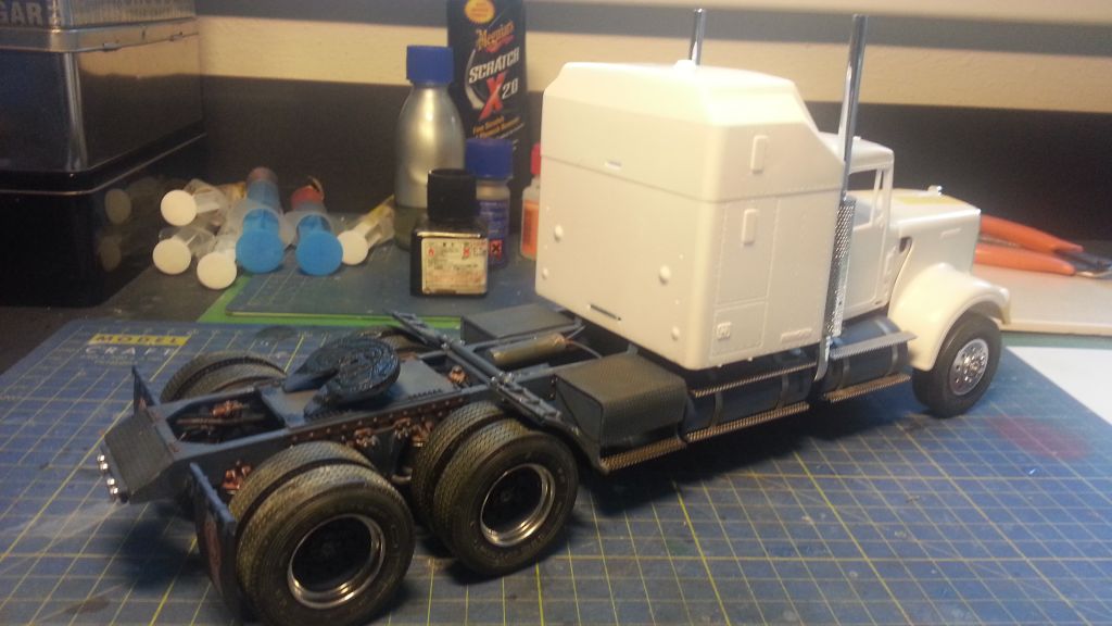

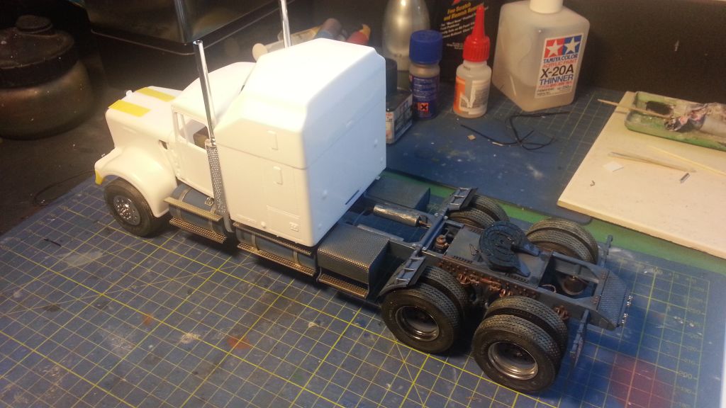

New progress: mudflaps and battery boxes...
Edited by Pavel A., 09 March 2014 - 08:03 AM.
#15 Pavel A.
Pavel A.
  • PipPipPipPipPip
  • 365 posts
Posted 14 October 2013 - 09:27 PM
I worked last days on fuel tanks and chassis. Here are some actual photos. Pavel
Edited by Pavel A., 09 March 2014 - 08:04 AM.
