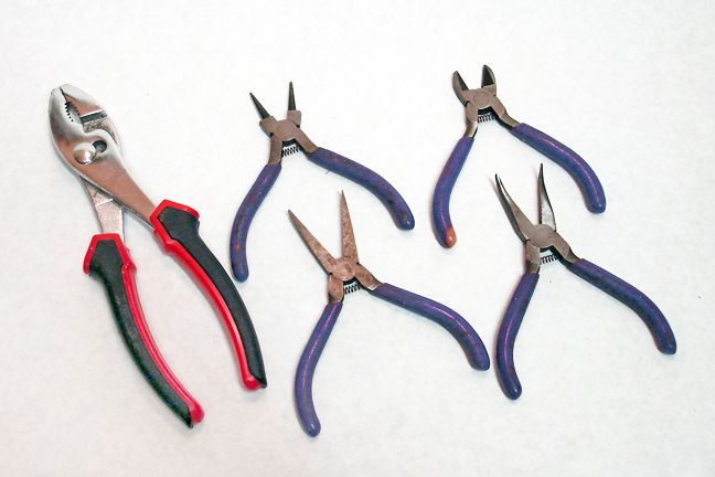

Here's a tip for you guys. Most of you already know this, but you can never have too many tools. I couldn't have built the engine in the previous photos without tools... and some of my most-used tools are these little guys:
I found them sold as a set in the jewelry making aisle of Hobby Lobby. They weren't expensive, maybe $10 or so for the set. The set consists of round-jawed, flat jawed and bent needle nose pliers, and a cutter. They're all spring loaded (meaning the jaws open when you release pressure on the handles), they're about half the size of "regular" tools like the full-size pliers on the left, and I couldn't get along without them. If you build without tools like these, do yourself a favor and buy a set. You will not be sorry. Once you have them you'll wonder how you ever got along without them.

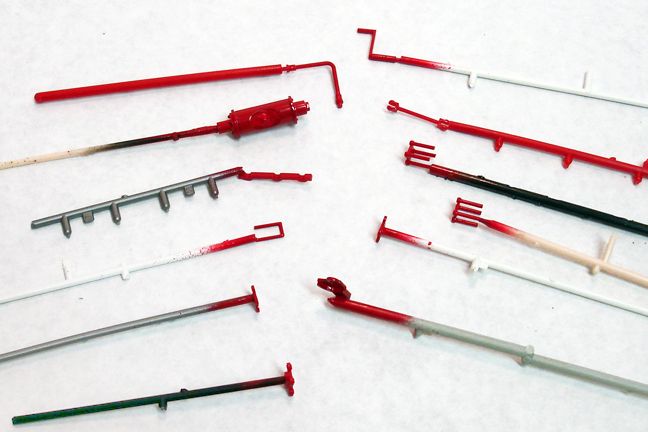

All of the various small parts were removed from the sprues. Mold lines, sink marks and other imperfections were cleaned up, the parts were attached to bits of scrap sprue, and spray painted. Note that every part is attached to its sprue "handle" at a point that won't show on the finished model. The same process was used for various small subassemblies that would all be painted one color. This kit has dozens and dozens of small parts like valves and handles and brackets and things like that... so the process is pretty time consuming. But the payoff is that once the parts come out of the dehydrator, all I have to do is snap them off the sprue handle and install... no further cleanup or touchup needed. This is only a small sample of the parts treated this way...

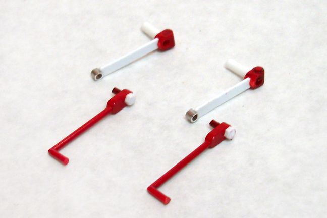

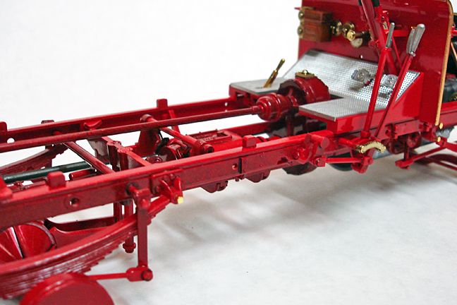

The rear brake mechanism was a problem. Out of the box, the rear springs were in the way of the actuator arms. I didn't find that out until I had painted the parts and tried to install them. I had to rebuild the parts using portions of the kit pieces, styrene and aluminum tube, and strip styrene. I had to extend the rods so that they come down outside of the rear springs and don't interfere with them. Since I had to rebuild these parts anyway, I decided to add bolt head detail made of hex-shaped styrene rod:

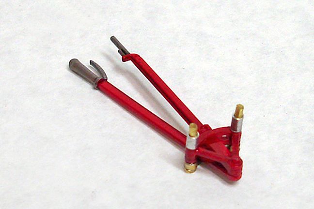

I've been working on the chassis for several days. There are a lot of small parts... all sorts of brackets, linkages, control levers and rods, etc... all of which have to be cleaned up and painted individually before assembling to the frame. Everything is fitting together almost flawlessly... whoever engineered this kit really knew what they were doing. But it hasn't all been trouble free, as I showed you in the above photo regarding the rear brake levers. Another problem I found is with the shifter/handbrake assembly.
The floorboard extends out horizontally, beyond the faces of the frame rails... so much so that the molded-in mounting pins on the brake lever assembly are too short; the inside of the assembly contacts the side of the floorboard before the pins reach the frame rail. I found this out after I had assembled and painted the handbrake assembly, but this time the fix was easy. I slipped some short lengths of aluminum tube over the mounting pins, then added some longer pieces of brass rod into the aluminum tube sleeves. These pieces of brass rod are now the new mounting pins. A drop of CA holds the aluminum and brass to the kit piece. All I have to do now is brush paint the aluminum extensions to match the rest of the assembly, and install on the frame rail:
