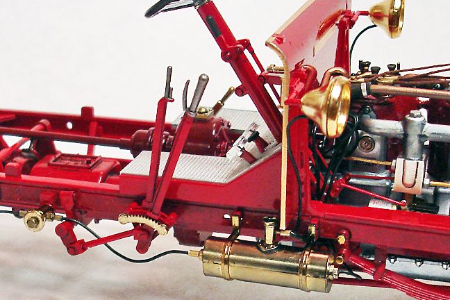

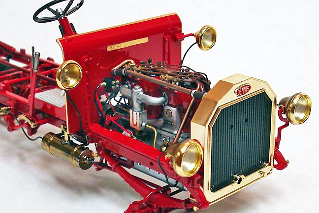

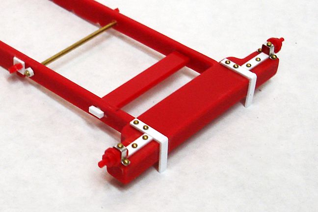

Some progress!
This kit is very tedious to build because there are so many small parts that have to be individually cleaned up and painted. And for some reason a lot of parts are molded in halves–for no reason that I can see. They could just as well have been molded in one piece. But because they are split down the middle, that means more parts to clean up and then glue together before painting them as a unit. I have no idea why so many of these parts are molded in two pieces, but that's the way it is. On the plus side, most everything fits perfectly, no reworking or re-engineering of parts needed to get them to fit. However, many of the split parts have no locator pins or any way of positively aligning the halves. You have to line up the halves by eye. And for some reason almost every part has visible ejector pin marks! So a LOT of tedious cleanup on this kit.
Here's the chassis so far. Of course, most of the chassis components and detail will never be seen once the bodywork and fenders are in place, but oh well…

Here you can see my reworked rear brake rods and the extensions on the handbrake assembly I added to reach the face of the frame rail. The holes you see in the frame rails are where the fender mounting brackets will go.

The instructions mention gauge face decals, but there were none in the kit... so I had to hand paint the gauge faces. Not an easy job, as the speedometer is maybe 1/4 inch across! The gauge "glass" is clear 5-minute epoxy. The gold trim on the dashboard's edges is gold BMF.

Here's the rear pump. The gold trim on the rear platform edges, on the pump and on the fire extinguishers is gold BMF. The brass handles on the extinguishers were scratchbuilt of brass rod and sheet styrene, because I thought I lost the kit supplied parts. Of course, after I scratchbuilt the replacements, I found the kit parts... :rolleyes: ... but since I had gone to the trouble of scratchbuilding replacements, I used them! At the upper left of the photo you can see the two valve handles are missing... I only have one, the other one is missing. I'll have to scratchbuild the missing one somehow. Also, the hollow vinyl tube supplied in the kit for the extinguisher hoses and various other hoses was way too stiff. I found some soft rubber tubing in the jewelry making aisle of Hobby Lobby that's just the right diameter, has a nice flat black finish, and is very soft and flexible.
I also added a black wash to all of the chassis components, like the large nuts you see here on the pump, for example. Adding the wash adds depth to the details and makes the model look a little less like a model and more like the real thing. I also "dirtied" the chassis, all the undercarriage components, and most of the brass-plated parts by spraying them with my old standby, Testors Transparent Black window tint.

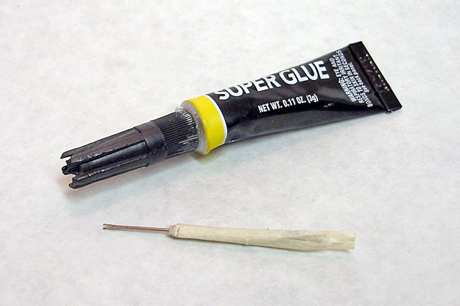

Here's a little tip for you...
I use CA glue a lot when building. Most of the time, I need just a tiny drop, applied to a very specific spot. Trying to use the tube to squeeze out a small drop is almost impssible... it just doesn't give the control I need.
I use a homemade CA applicator. All I do is use a flat Dremel sanding wheel to remove the top half of the "eye" of a large sewing needle. That leaves me with a tiny "Y" shaped opening at the end of the needle. I wrap the needle with masking tape to make it easier to pick it up and handle (and so I don't poke myself with the sharp end!  :lol: ).
To apply the glue, I place a drop of CA onto a disposable surface (a small piece of paper, plastic coffee can lid, whatever). Then I dip the open end of the needle into the CA, which leaves me with a "just right" drop of the glue suspended between the two "arms" of the open-ended needle. Now I can apply a precise amount of glue to a precise spot without worrying about too much glue spurting out if I used the tube to apply the glue directly. After use, I just wipe off the tip of the needle with a paper towel. If any CA builds up on the tip, all you have to do is scrape off the dried CA with the tip of your X-acto blade and you're good to go.
Cheap. Simple. Effective.

Nice work so far. Nice tip on the window tint. The photo of the rear pump shows the effect nicely around the bolts.
