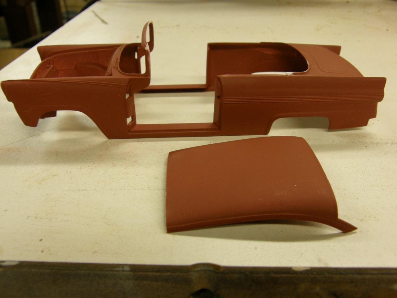

AMT started as a hardtop, so it had to come off.
Attached File  PA180001.JPG   78.15KB   1 downloads
I have to thin this out a bit yet, I can see...

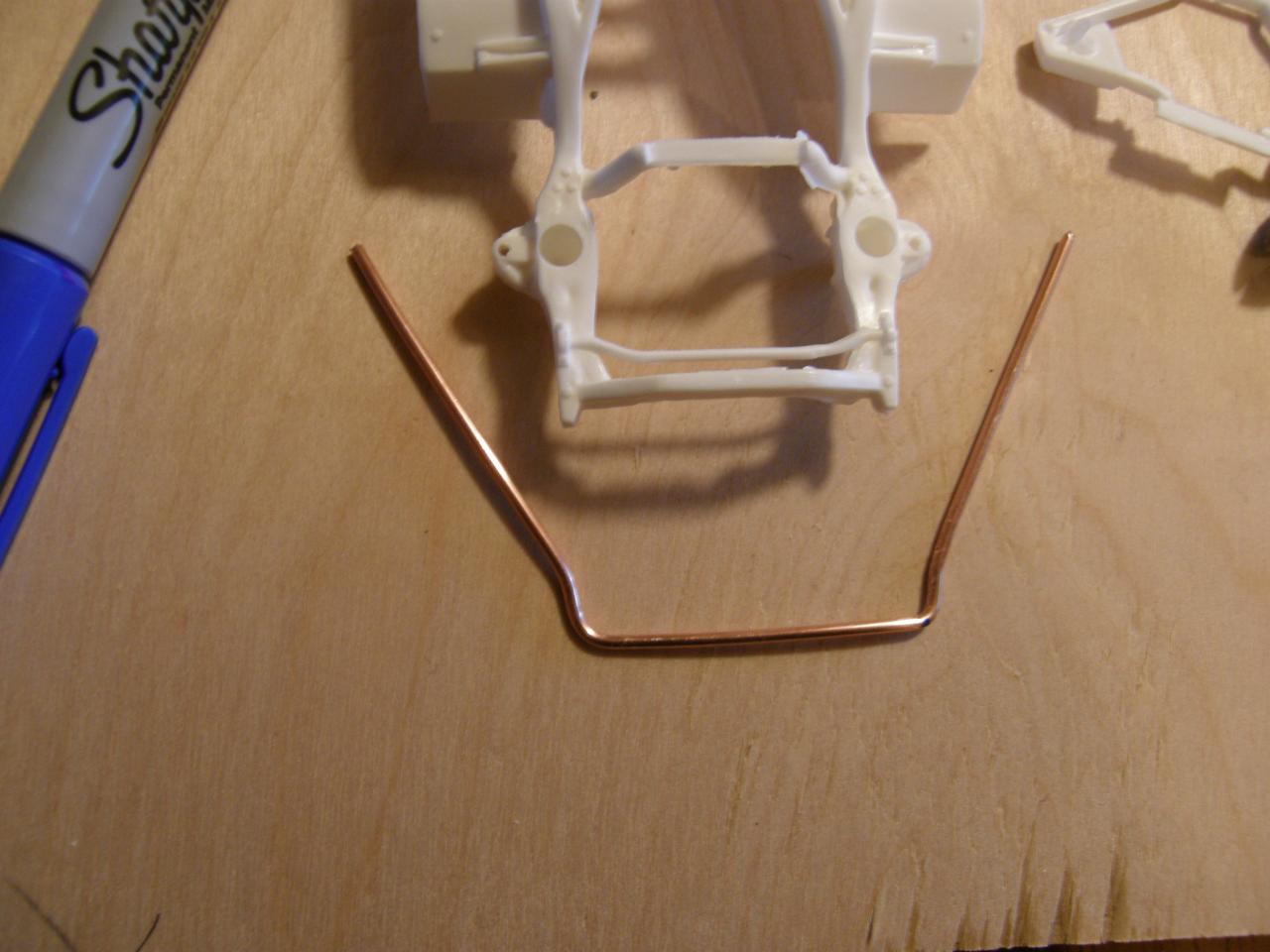

I started on the engine, but got hung up on making a "real" sway bar after I found a reference pic on the internet.  Started with 14 gauge house wiring, which is .060" OD which equates to about 1-1/5" OD.  This is a little "heavy" but I think still looks believable, scale-wise.
Attached File  PA200002.JPG   95.84KB   0 downloads
Bent the thing to approximate the pic I downloaded, then "squashed" the ends with a pair of vise-grips, filed them round with my Dremel tool, then chucked the wire-gauge ferrule and drilled the holes to mount the "stand-offs" which are yet to be figured out.

Great start so far Doug, welcome back to the hobby! The scratch-built sway bar doesn't look bad at all, it may be slightly large, but unless you have some 18 gauge wire around, it'll do the trick. I'm not even sure if 18 gauge would be in scale either, but it would be a bit smaller...I'm gonna have to try some!

According the the wire-gauge tables, 18 gauge is .0403" in diameter. This equals right at 1 inch in 1/25 scale, which is just about perfect for a sway bar.

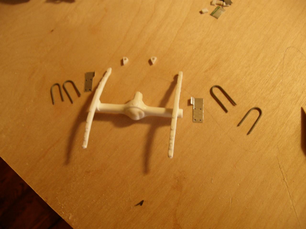

Also working on u-bolts/shock mount plates on the rear...

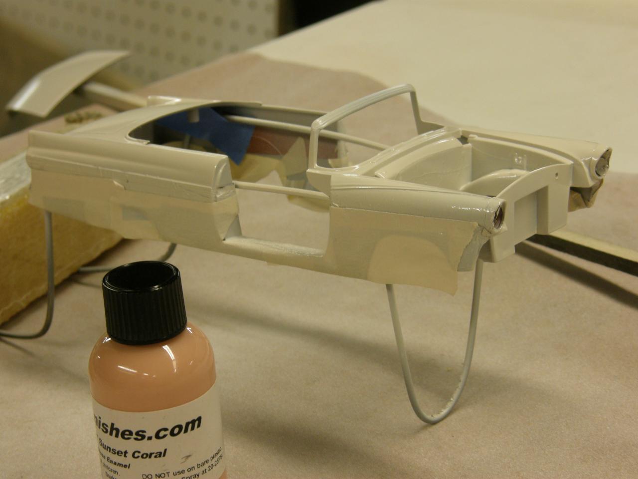

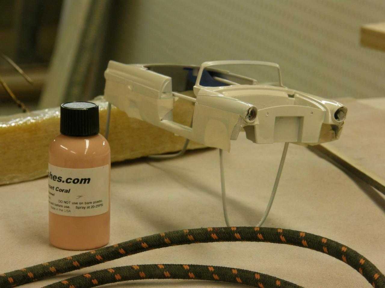

Thanksgiving and Christmas are now behind us.   Just wanted to post some pics so you know I didn't quit the hobby already!!
Next on the body is sanding, clearing, then foil.  Gotta figure out how my eyes and hands will work trying to detail the dash.
