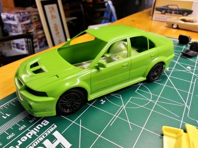

Going with dark wheels. here they are test fitted with the completed chassis.

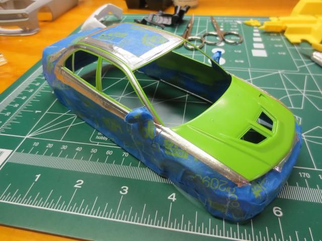

I used an old sheet of foil to mask around the widow trim and hood. I like this method but it'd get pretty spendy buying foil just to throw away,
After the trim and hood were painted I taped over all the trim.

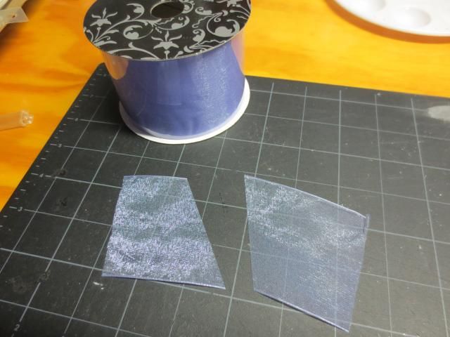

I cut ribbon then sprayed it with a little adhesive. I cut it into two pieces at an angle to simulate a cabon weave design.

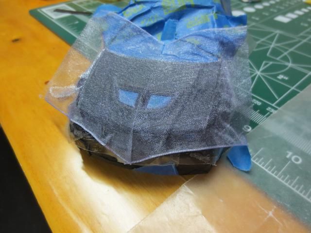

I laid two sided tape along the sides and front of the hood and put a piece under the vents and along the back of the hood to help hold down the ribbon. Then tucked it along the contours. the adhesive held just enough!

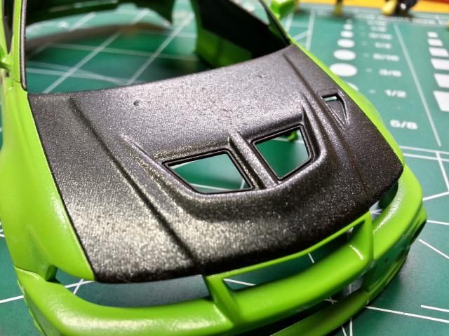

After a light coat of a dark metallic grey I had a nice carbon fiber like pattern. The pattern didn't show up as great in some areas but I think the process yielded a convincing carbon fiber hood.
On to clear coat and polishing. should be finishing the EVO soon!

The color looks great on that and the hood looks even better. Great work!

Good job on the hood! Looks cool!

The hood looks good!

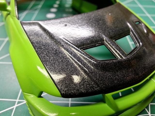

Thanks, I'm learning a few new techniques on the few projects I have on my bench right now.
The first coat of clear gave the hood much more contrast and helped show off the carbon fiber pattern.

Very nice work. Love the carbine fibre effect.

I like that idea for the carbon fiber.  Somtimes the decals are a pain when you have contours or hood scoops.  This is coming along nicely.  Very cool.
