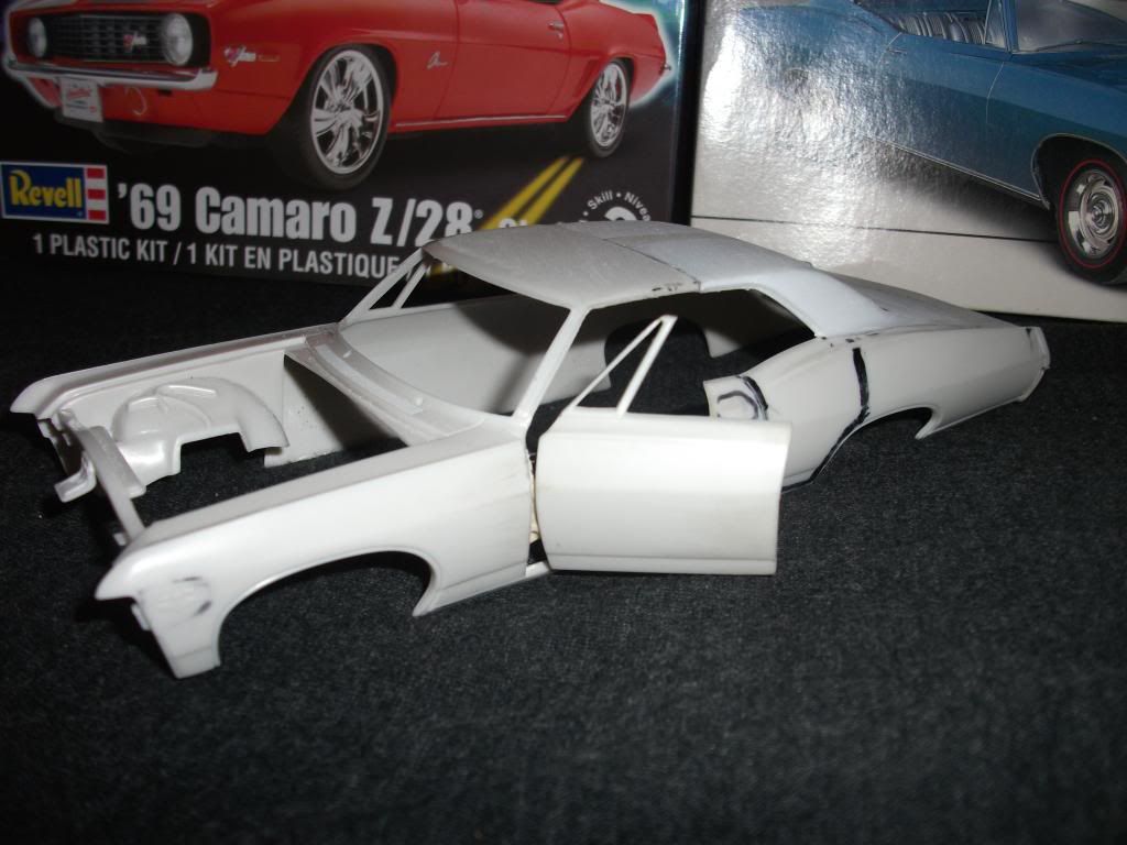

I am making the supernatural impala again, i was planing to do this later on in the year but other projects have stalled, so this will be my main build and i will finish other projects in between, i have done this before (link if your interested: http://cs.scaleautom...9/t/107258.aspx ) so i know what to do, i will also be making this one very very detailed with all 4 doors hinged and trunk/hood also hinged.
Here's my start:

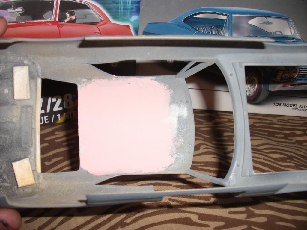

I decapitated the camaro (camera was playing up so i didnt' take any pics of how i joined the roof.)
These were braces to hold the roof in line while i could glue it, i will remove these and clean it all up once the bodywork is done.
It took 2 afternoons to get this at this stage (i removed the front door months ago then got sidetracked with other things) and its all roughed in at the moment, i will alter things as i go.

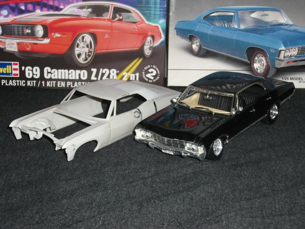

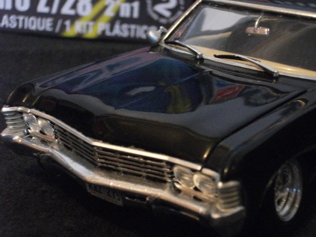

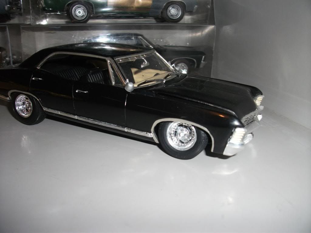

Comparison with my first build:

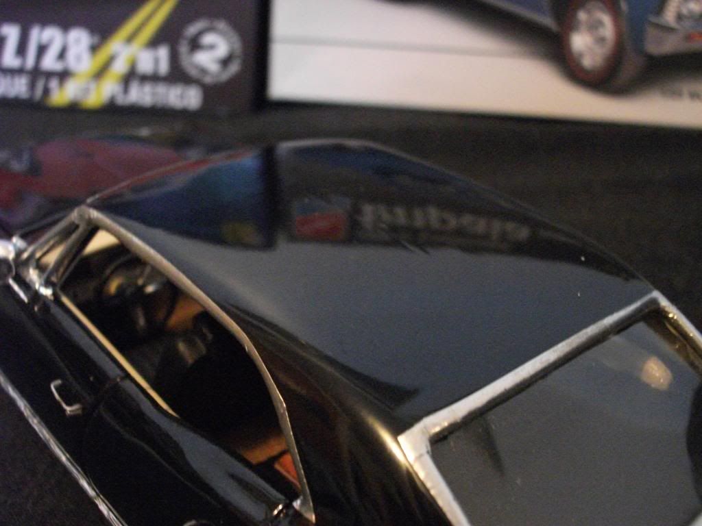

The roof is in the same position and everything as the finished one but it looks odd for some reason, Ii think its because of the door lines i drew (they are way off except the front one i cut out, i just scribled them on to see how its coming along...
here was a major problem with the first one, the lines where the camaro roof joined the impala showed through a few weeks after completion (i think the putty/paint shrank too much) anyway it looked good for a month or so then they showed up.
You can see what i mean in the center of the roof...
Another thing was were i modified the hood has cracked and sunken in over time.
big sink mark were the 427 ss bulge was.
I will possibly cast this in resin if it turns out good, not sure yet.
Let me know what you think.

If you get your body work correct and mold it at least you won't have to worry about the the bodywork shrinking years later. However you may have a a problem getting your body out of the mold without it breaking. I would suggest, when you take the first car that you pour out of the mold preserve it as a new master just in case the mold wears out and you need more of them.

It looks like the sail panel/C-pillar on the new one is wider than the old one? Could be why it looks funny? Or it could just be an optical illusion.

The c pillars i used on the first one came from an old monogram? camaro and was 1/24 so size and shape may have been different.also i did reshape the inner roof line (where the drip rail is) a little on the black one to get a better shape. I have it primered and it looks fine, i think all the scribble made it look weird...

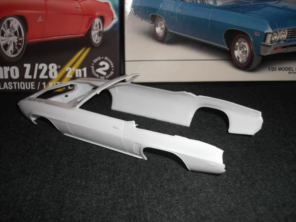

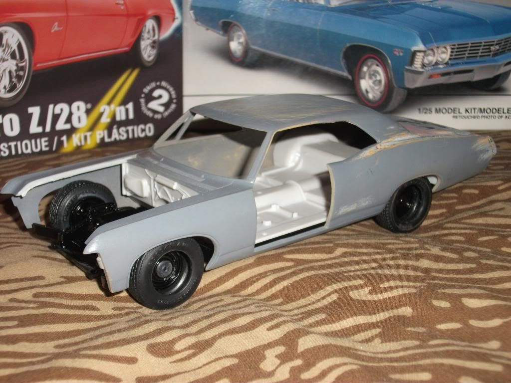

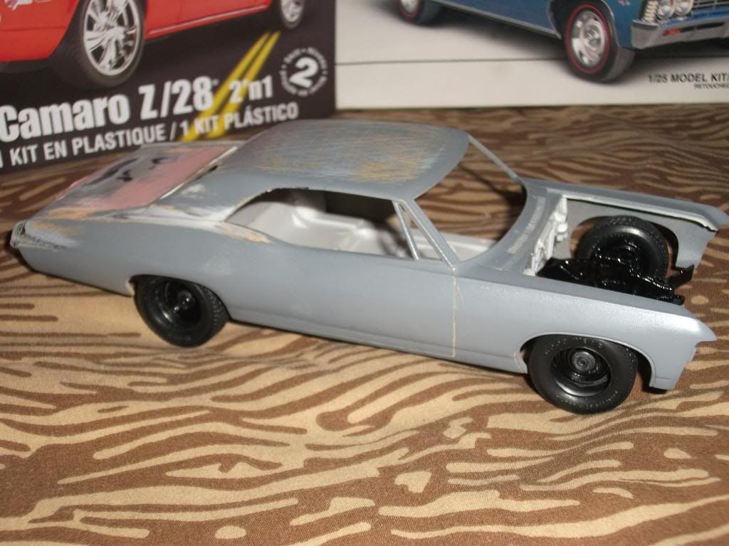

I got stuck into the chassis and got the ride height where i want it and got the bodywork mostly done (trunk is still in need of sanding and shaping)

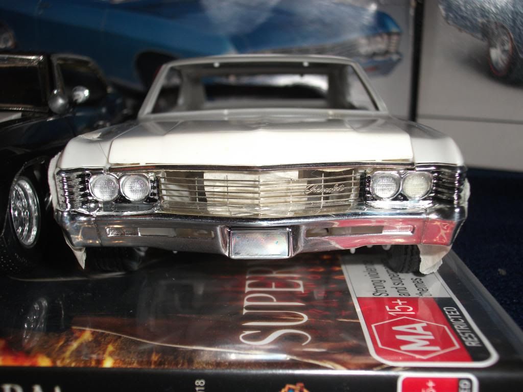

I also got a couple stock of resin hoods of ebay and got a little done on the grill/bumper.
This spare body was used so i can still work on the 4 door body:

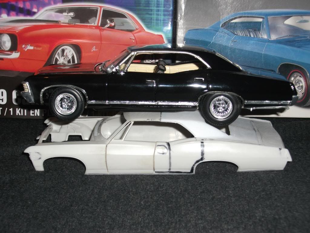

Heres the old one:
The trunk is still in need of work but i think i got the roof done.
The grill of old one:
The still incomplete grill of new one:
all comments welcome.

Nice Gril work too..
