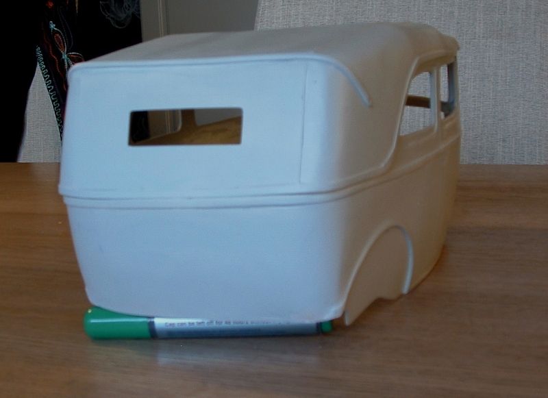

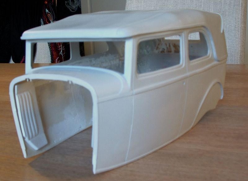

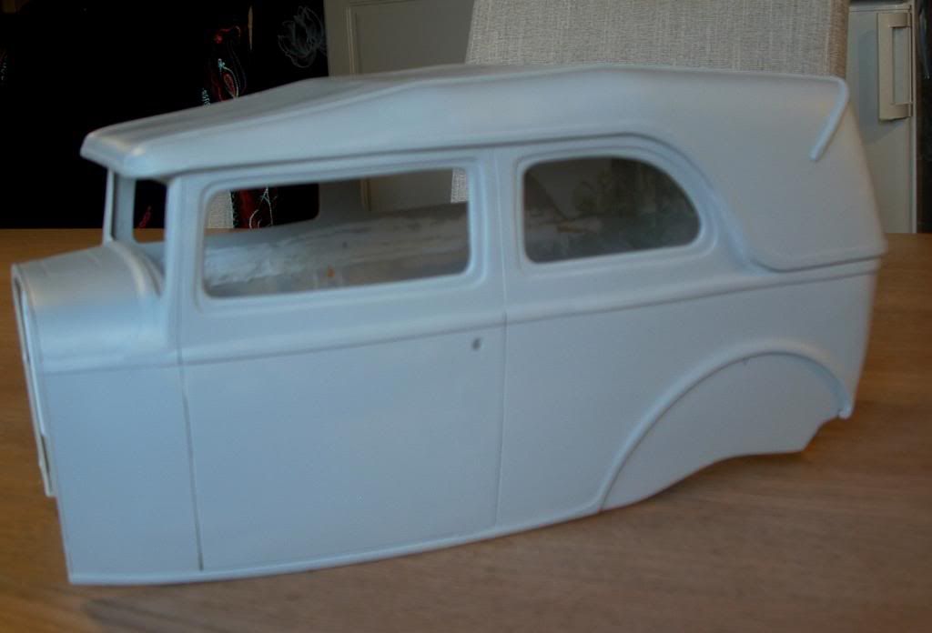

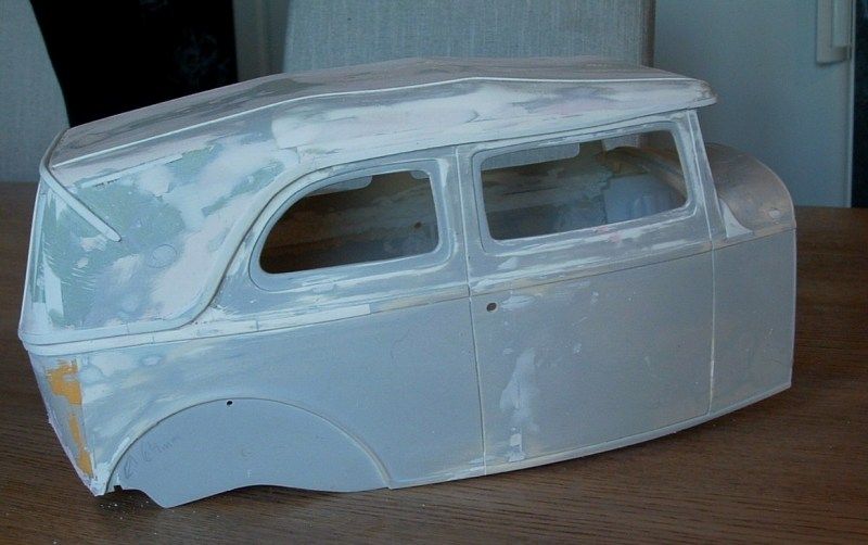

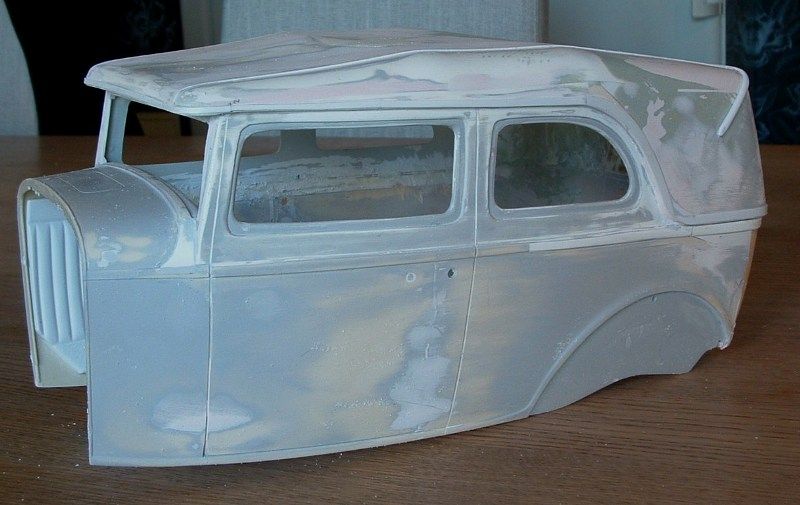

Have not posted anything here for a long time and would like to make a change on that here. I´ll started to work on a B400 early this summer and a spare roadster body was cut down after the door lines. I used plastic card 3mm for new sides and used pieces of a Jaguar front fenders for the curved end off the new body style.
Plastic card was used to make the new sides with windows. I sandwished  an 2,5 mm and an 3,5 mm. I´ll made the windows smaller on the inner card than the outer card to get that profile around the windows.
The ground for this build is a Flintstone 25-scale Hot rod body so I cant go stock with this build but that's fine with me do I´m more off a rodder..
The roof section comes from the new Tub kit and was cut down to fit. And with some plastic card the roof was fixed so for the moment there´s a lots off sanding and checking the angles.

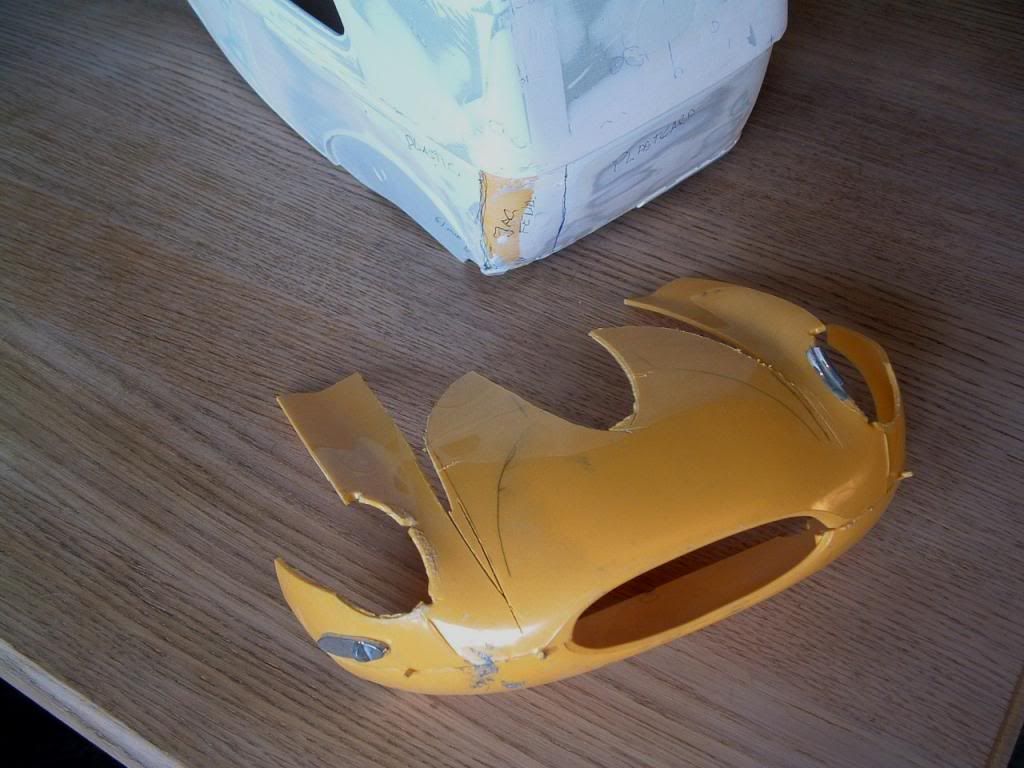

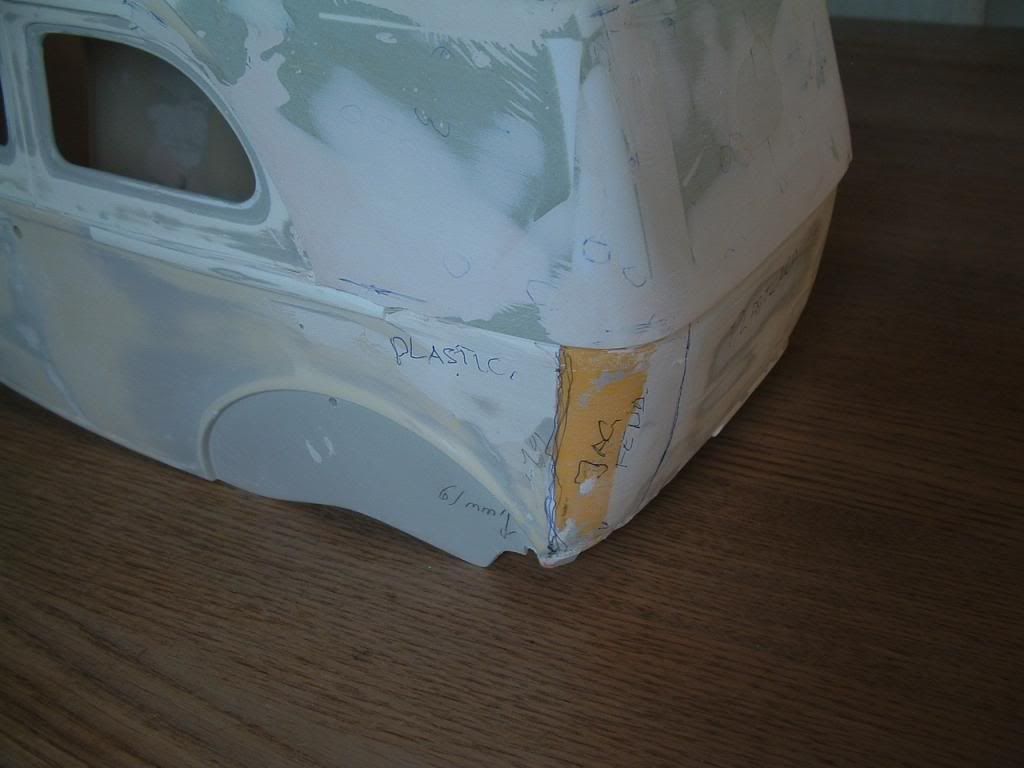

Hi
Yep the Flintstone i darn nice and I´ll sell this 25 scale body when I´m done with it. I used a rounded section from the headlights and back from the front of the Jaguar fenders for the curved back quarters. My sample of the Jag was coloured yellow, you can see the back corners off the body in this pic where the primer is sanded off.
Here´s what's left off the fender. I did this so I had the same curvature on both corner.
LarsaQ
#14 oldschool
oldschool
    MCM Regular
  • PipPipPip
  • 56 posts
  • Location:Sweden
  • Full Name:Lars Qvarfordt

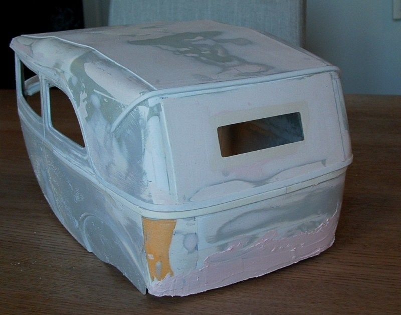

Posted 01 December 2013 - 04:22 AM
Hi folks
Still working on the B400 body and now the roof is almost finish just some detail to fix in the rear end where the body meets the fuel tank. So, next thing will be a thin coat off primer and  a windshield frame will be made from plastic card.
Regards
LarsaQ
