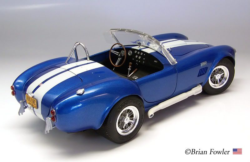

It's been a few years since I built it, not the best kit,but not the worst either. I changed a couple things on mine, and reworked a few others to get it to fit together a little better.

That one looks mighty fine to me! Good Job!

That is one sweet looking Cobra.

I didn't realize there were different versions out. Mine has the full bumper tubes and dual carbs with individual air filters. I'm wondering if yours was a different run?

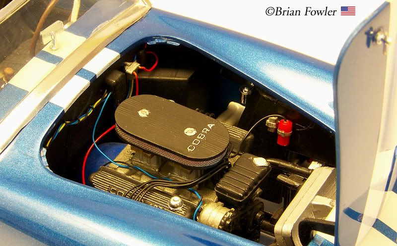

Same kit, I used the air cleaner from the AMT Mustang, and I made the jack plates instead of the bumpers. Also made the roll bar from aluminum tube.

It's a nicely done air cleaner-BUT-the carbs shown on this kit are totally bogus. They're neither Webers, Holleys or AFBs. That style a/c was only used on Holleys.
Brian's model is very nice because it's evocative of early Cobras and is beautifully assembled and finished.
But the kit requires massive corrections to be close to an accurate model.
