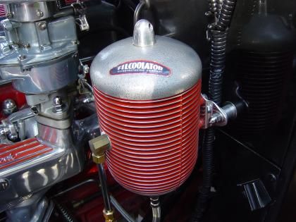

Some actually have a real mold line:
3F653155-9B57-47AA-AF48-21F66E3677D9_zps

Posted 11 December 2013 - 07:18 AM
Erik's made an excellent point!  Most, if not all of those "classic" beehive oil filters were cast aluminum--back in the day when scrap aircraft aluminum was extremely plentiful (from almost half a million airplanes being cut up and melted down after WW-II).  Many items, such as the beehive oil filter he shows, were diecast, meaning that the mold used was very much the same style of mold used to make the model car part--just 25X larger and made for accepting molten aluminum alloy instead of styrene plastic.  That would make for the mold parting line seen on the one Erik's shared here.
About the only way such a cast aluminum part could be made without any mold parting line would have been to sand-cast it, which of course would have meant a lot of polishing and finishing of the raw castings.  Of course, CNC machining didn't exist "back in the day",  but that would have resulted in nary a mold parting line.
My thinking here?  I'd leave the mold parting line on the kit oil filter, because chances are any vintage cast aluminum accessory such as this would have a mold line or two on it.
Art

Posted 11 December 2013 - 07:36 AM
Art also makes an excellent point, but it really comes down to period. Some of these things being made today have machined ribs, and an early cast unit could easily have been chucked up into a lathe and the fins cut pretty and smooth. Just depends on the exact look you want.
