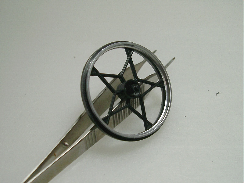

I want to paint the wheels the way they are on the box art and elsewhere in the kit. I've never tired to do a two-tone (silver/chrome rim with gray spokes and center) spoke wheel before, and so far have only come up with (I found nothing on line) some kind of template to fit over the rim and then one for the center. Will this method produce good solid lines? Is there a tried and true method for doing this? Help!

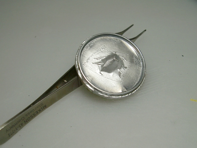

I use a compass cutter to make circular masks
Attached File  IMGP3186.JPG   172.93KB   0 downloads
Attached File  IMGP3187.JPG   162.72KB   0 downloads

Here's how I did mine. Nothing fancy, I just stripped off the chrome plating. sprayed them with Testors Aluminum Plate Metalizer and brush painted the spokes with Testors Burnt Metal Metalizer. The hub cap is a pin head. The rears also were stripped of chrome plating and finished in Testors Aluminum Plate Metalizer.

LOL, well I know I can use a paint brush, duh. I'm trying to find a way that produces more stable results. I think I will investigate the compass cutter.

I love my compass cutter and find lots of uses for it.
