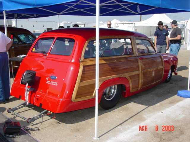

Personally I REALLY like the red one with the subtle top chop & one piece quarter glass.

IMHO my caveats about the kit is lack of wood grain texture and no flattie. A couple of surf boards or early camping goodies would be nice too. Other than that it is a nice kit my sample had fair amount of flash on the new parts but it is easy to clean up.

Please, no woodgrain texture on woodies!!!  The wood is buried under about 30 coats of varnish on the real things and is just as smooth and shiny as the metal.  Plus maple (the light-colored wood used for the framework)  doesn't have a discernible grain as it is in 1:1 scale, much less in 25th.  The only 1:1 woodies I've seen with visible grain have been restored using oak for the frames, and that's not what the originals used.

That's either maple or birch (another hardwood with a very fine grain pattern).  FWIW, oak was never used by Ford (or for that matter any of the other makers of wooden station wagon bodies, due to its weight and oak's tendency to break easily when cut into thin, small sections).   As produced, all the wood "framing" on the last series of Ford and Mercury woodie station wagon bodies (both marques used exactly the same station wagon body, only the front doors being different due to the styling differences in the front clip) was made by bansawing hard maple into thin, flat strips which were then coated with glue, and placed into molding dies and pressed into the curves needed for the shape of the body shell, under heat to cure the glue quickly.  After removal from the molding press, each piece was then milled slightly to give the rounded edges, and hand-fitted to the molded plywood panels, then sanded and varnished.
The plywood panels were made in the same manner as the framing--thin layers of birch, with an outer layer of Honduran mahogany were coated with glue, then placed in a molding press which formed them into the curved body side panels you see on that car.  This was not a new technology for Ford--their Iron Mountain MIchigan factory produced hundreds of wooden gliders along with other molded plywood components for the US war effort during WW-II, and molded plywood furniture was very modern, very popular from the late 30's until at least the early 1970's (ever sit at a grade school desk in those years?  Those molded seats were made by the very same process!)
The confusion can come very easily from the efforts of early restorers of these, and other woody station wagons, as furniture-grade hard maple in sections large enough for milling such dramatically curved parts isn't easy to come by, where many woodworking shops can access oak pretty easily.
Why were these wooden panels so hard to come by as restoration parts years ago?  For starters, those panels are absolutely not structural:  Once made, they are simply that, panels, and were fastened into recessed areas of what was otherwise essentially an all-steel station wagon body, where from 1929-48, Ford station wagon bodies were entirely wooden construction, built using hard maple structural frame work glued together with common cabinet-working dovetail and mortise & tenon joinery, then attached to flat plywood panels by means of plated "jail bolts".
A note about the finished look:  Maple, being a very fine, close-grained wood, does not have the very prominent "light-dark", closed-open rings that oak and other larger hardwood trees have.  Therefore, especially when molded as these '49-'51 Ford Motor Company bodies were, even in the few areas (at the exposed ends of some of the framing sections) where the end-grain is visible, there isn't all that much variety in color to be visible--certainly almost none along the flatter surfaces.  Another confusion that can come from looking at the picture Bill Barrett has put up here comes from the "swirling" grain on some areas of the framing.  By the time these bodies were built, the parts had to be made as described, simply due to the depletion of furniture-grade maple in any serious quantities from the vast forest holdings of Ford Motor Company in the Upper Peninsula of Michigan, resulting in some of the less desireable grain patterns that can be seen on these wagons.
The color of the wood panels is also darkened/enhanced by the use of spar varnish, which isn't water-clear, but rather has an amber hue to it.  Several coats of varnish were applied at the factory, and the owner's manual recommended a light sanding and re-coating with fresh spar varnish every year.

mrknowetall: "Is that oak or maple in your posted pic?"
Almost positive it's maple.  Maple has very distinct figuring when it's quarter-sawn.  Might be birch, too, as Art said. Birch usually has a much wider and more wavy figure than maple, which can be very tight and straight (known as "tiger maple")
This is an oak-framed woody, you can see the visible grain on the tailgate, it's not glass-smooth like maple or birch.  I don't know if oak was original on this Buick, but I know it wasn't on the Ford/Mercury.  It probably is, since it's so thick and sculptured, it's been cut from one solid piece of oak, not the laminated strips on the Merc.
