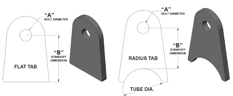

ScaleDale Posted January 10, 2014 Share Posted January 10, 2014 (edited) (Image of tabs wouldn't quote...) 1:1 shops like Allstar Performance and S&W Race Cars have bunches of chassis tabs like this, and it would be great to have them in scale for attaching stuff to scratch built chassis. Dale Edited January 10, 2014 by ScaleDale Quote Link to comment Share on other sites More sharing options...

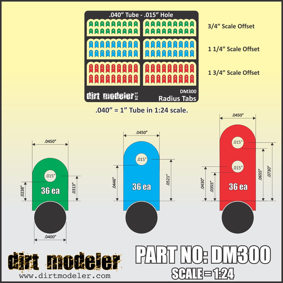

DirtModeler Posted January 27, 2014 Author Share Posted January 27, 2014 (edited) An update on this project. I've recently completed the artwork for a large number of new parts, including this Tab and Bracket line. I'll have more pictures and info for the other items later, but wanted to touch base on the Tab and Bracket line. The first wave will be about 75 different frets of tabs and brackets.. radius tabs, flat tabs, bent tabs, etc. 75 frets with about 3 different sizes on them. To help customers find exactly what they need, i'm doing dimension drawings of each of the parts frets, the drawings will look like the attached image. ETA on the new parts is mid to late February. This whole series has the exact same size of fret, and the same price ($2.49) I wanted to keep these inexpensive and something people would want to have an assortment of on-hand for whatever project you're working on. Edited January 27, 2014 by DirtModeler Quote Link to comment Share on other sites More sharing options...
ScaleDale Posted January 27, 2014 Share Posted January 27, 2014 The reference drawings are a great idea. Really lets me know what I'm ordering. Will this new run solve the Out of Stock issue with rod ends? Dale Quote Link to comment Share on other sites More sharing options...
