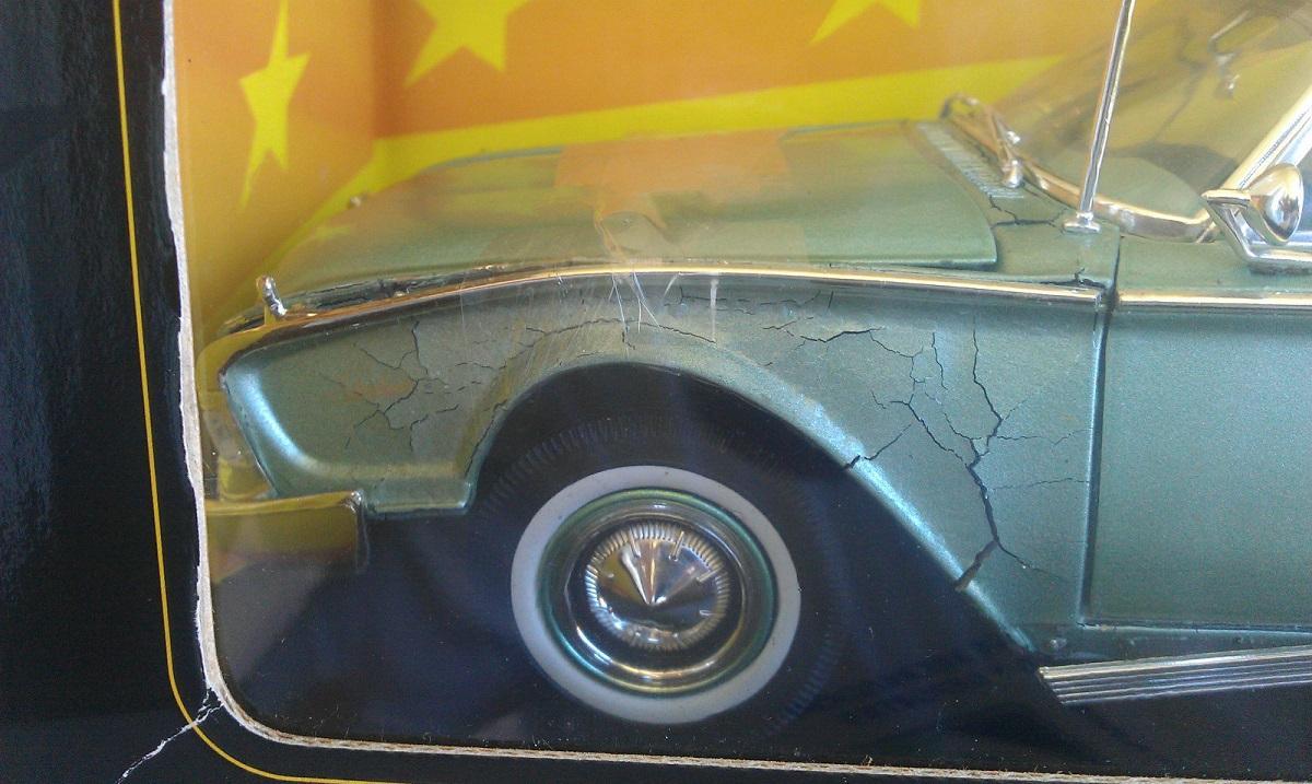

Opened one of my Cobra cabinets and noticed this bad cracking on this die cast. It is an Ertl brand. All others are fin but this one has split very badly. I have another in kit form and that body is fine. Anyone else see this on one of their die cast ? Any idea what happened here ? Seems kind of weird to me. I have some much older in the same cabinet and they are fine. ???????

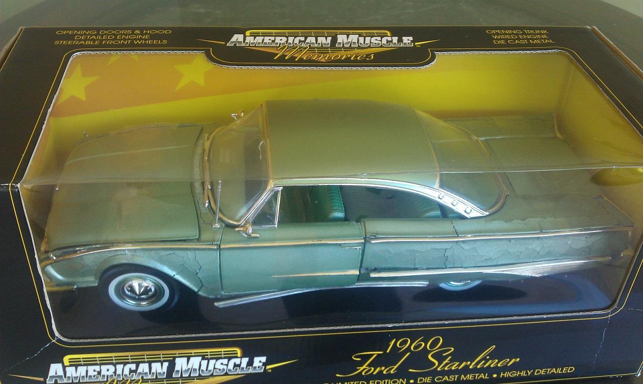

I had an ERTL 1:18 scale Chevrolet Cameo Pick up that literally fell apart. Firts the doors just came of, the the paint started to follow from the truck, and in a couple of weeks the body was loosing pieces.
I have some diecasts, and the only ones that have no bubbles on the paint ar a '67 Fairlane by GMP, a '68 Mustang by Auto Art a '71 Lada by IST, and a '58 Edsel Bermuda by Dambury Mint. All others have at least some tiny bubbles on the paint.
My advice to you is to put your love on the plastic models. Another point in favor of them is the fact that you built them and not some diecast company.

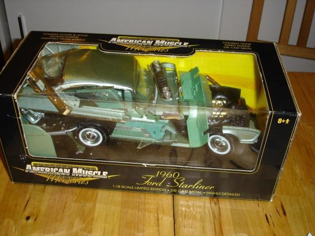

In your case, most likely a bad batch. I had it happen to a 1:18 '60 Ford.......that thing looked like a warped promo! I still say that humidity does play a role, but perhaps Tom is right, it may facilitate it's outbreak.

The paint on the roof of my black 1/18 '60 Starliner is cracked and flaking off, but the rest of the car is mint, and the roof is plastic, try to figure that one out. Makes me mad, because the black version with dog dish hub caps was a hobby store exclusive and is kinda rare. At least I can repaint the roof...  but I probably wont.

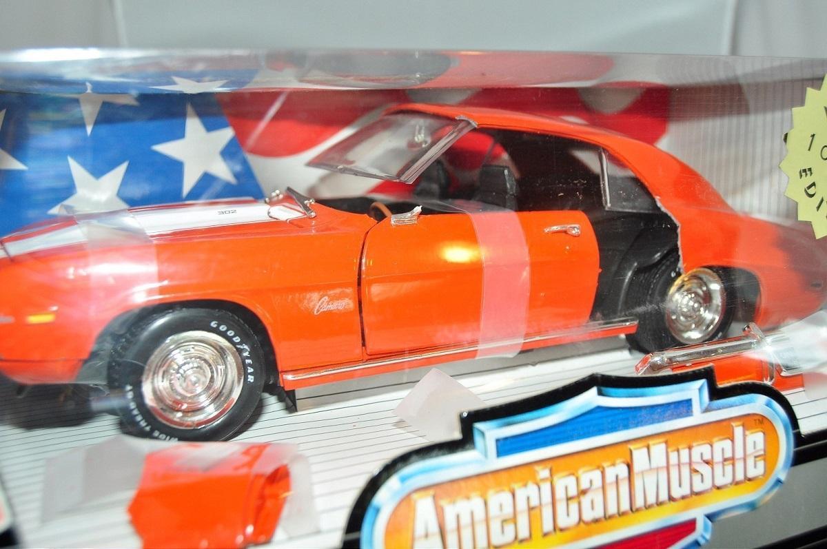

I stashed some of the Ertl 69 Camaros away in the original master carton when they came in new direct from Ertl. I had three each of the white with orange stripes and three of the orange with white stripes. The were up on the top shelf of our climate controlled stock room four about four years. I opened them and all the white one were cracked up in pieces and the orange ones were perfect. This has happened on numerous cars of mine where I packed them away when new and certain ones are now junk and other in the carton are fine.
Most times it's not the entire car.  Some may be the doors and hood while others in the same run could be the body bad and the hood and doors are fine.
Here is a bad hood on a perfect car. You can see the rough finish and blisters. I broke this one with my thumb.

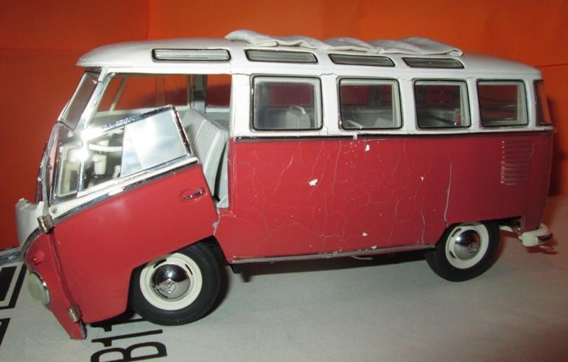

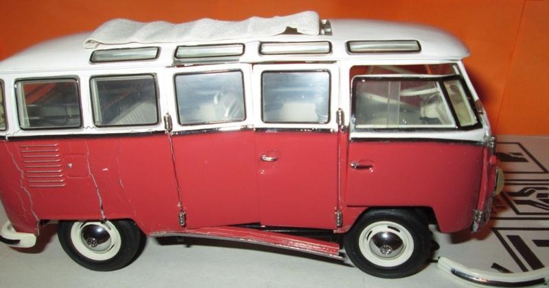

It's a bad batch of diecast. I have a Franklin Mint 60 Rolls Royce that broke in many pieces just sitting on the shelf. Also a Kyosho Audi wagon that broke in half when somebody tried to open a doorand then the door fell off. The Rolls is a total loss and the Audi is glued with a do not touch sign on it. .
