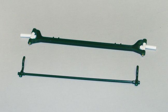

I want posable steering, so the first order of business is to remove the molded-in front spindles from the axle. The way they are molded in place, there's really no way to cut them away and save them for reuse, so I just cut them away and used a grinding bit in my Dremel to finish the job. Once I had the spindles out of the way, I drilled a vertical hole in the axle to accommodate a length of brass rod that will serve as the pivot for the new scratchbuilt replacement spindles, which I made of styrene rod and tubing. Here's the axle with the new spindles installed. The brass rods will be filed flush:

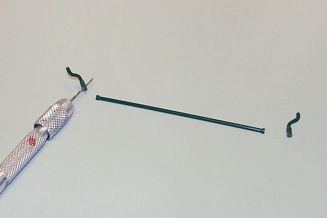

As you can see in the above photo, the kit's tie rod can't be used as is in a posable steering setup, so I cut it apart and drilled small holes in the spindle arms:

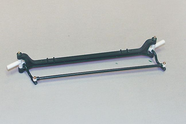

Then I glued the spindle arms onto the scratchbuilt spindles, and rebuilt the tie rod with new ends that allow for posable steering:
Presto! Posable steering!  :D

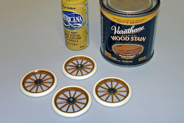

Unlike the painted wheels on the car in the photo above, I wanted to go with varnished wooden wheels, like on this Model 14:
To get that look, I first brush painted the wheels with acrylic craft paint "Ochre," then when dry, I just dipped each wheel into the can of "Golden Mahogany" wood stain. No brushing, no muss, no fuss... just literally dipped the wheel into the stain, took it out, dabbed off the excess with a paper towel, and let it dry. It gave me what I think looks like a pretty realistic wooden wheel, and the gloss level of the dried stain looks right to me. No further work needed! All I had to do was paint the wheel centers to match the chassis, and done! The kit tires are a nice soft vinyl, in white, which look cool on the wooden rims:

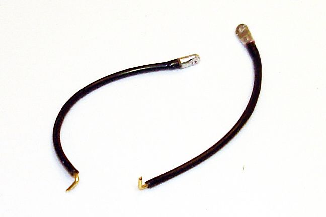

Posted 19 January 2014 - 01:49 PM
Lots to show you guys on the Buick. The chassis and engine are about 95% finished.
First... I scratchbuilt some ignition wires... terminal ends are aluminum tube that I crimped flat and drilled a hole to attach to the plug. The other end has a 90 degree brass elbow that will be glued into the magneto. The spark plugs themselves will be brass rod, with the insulator painted white. Here are the ignition wires:
