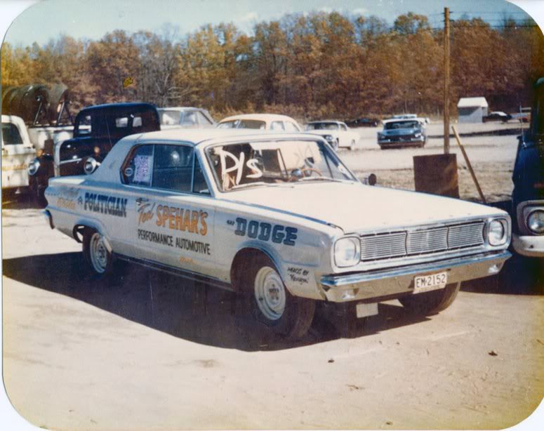

1966 D-Dart for sale :
http://www.mecum.com...D=SC0513-153163
Ted Spehar's '66 'D' .

RE: 1966 Hemi-prepped Darts : There were a few A/FX Darts in '64-'65-'66 which were "factory" prepped with the Hemi . The extent of the factory's affiliation was that of providing the parts / part numbers via "Hustle Stuff" ( predecessor to 1972's "Direct Connection" ) in order for whomever to modify their Dart to accept the 426 . Typically , the entire front suspension was replaced with leaf springs and a straight front axle , right from the A-100 truck and van models .
Back to the 1968 Hurst Hemi ; some racers cosmetically-updated their 1968 Hemi Dart or Barracuda to 1969 parts . These cars were ostensibly no longer "stock" , no longer current year . They were run in A/MP or -this was news to me- some pre-Pro Stock class from 1969 , whose class I can't recall at this time .
