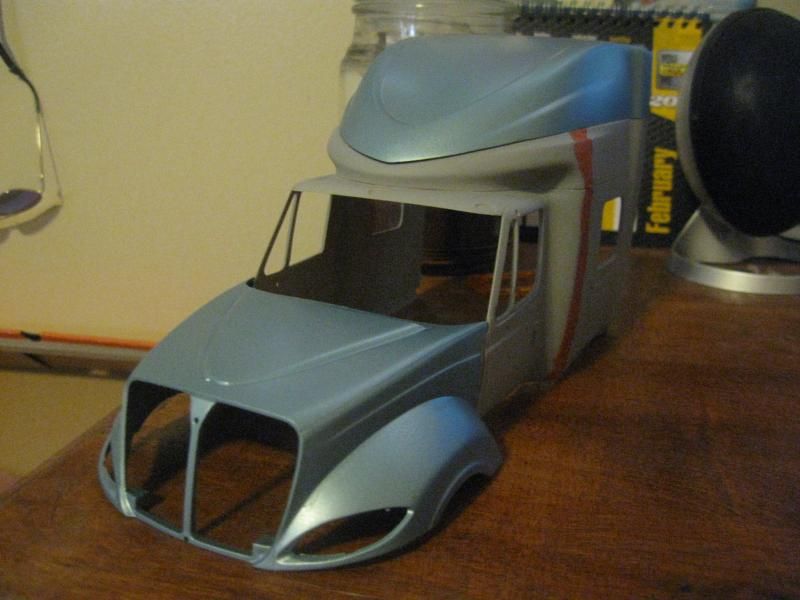

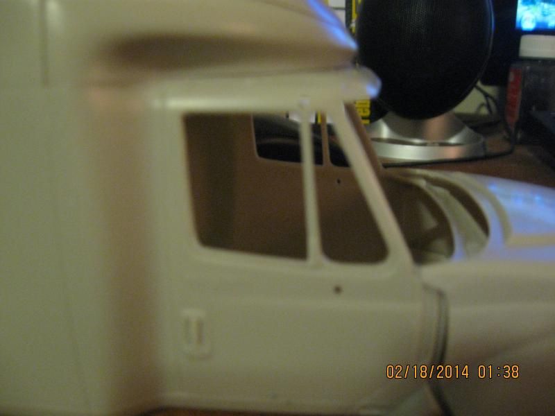

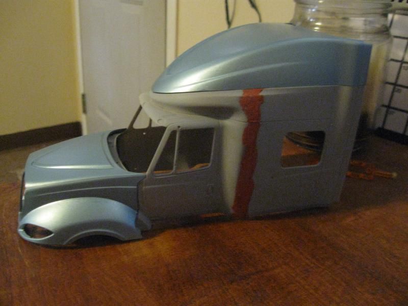

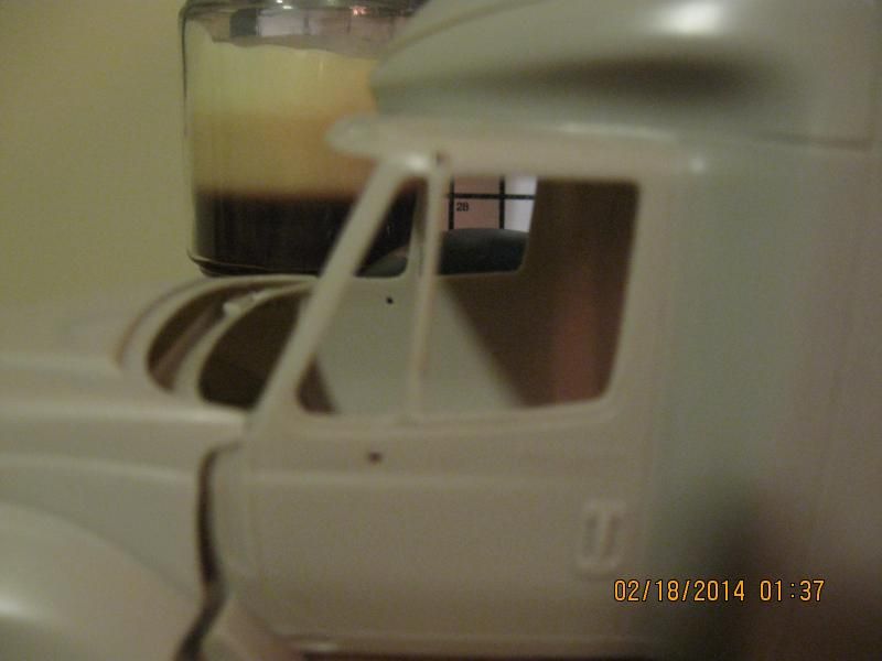

I finally got one. I opened the box and felt that old feeling that I wanted to build something again. It's been a long time since I've built anything without losing interest in it.

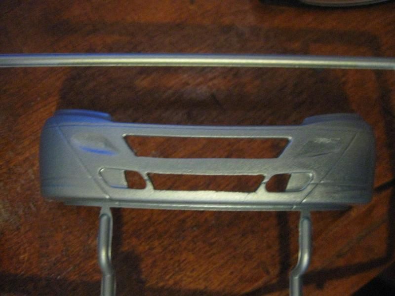

So far I've made a couple of corrections to the body and front bumper. I have a picture of the last truck I drove, and noticed some differences between the kit and 1:1. I've already got most of the truck cab painted, but still working on filling in some panel lines that weren't on my real truck.

Here's the pictures...

Nice progress and bodywork. Looking forward to more.

Glad you finally got around to getting onto this one, Man....I've been waiting on this one.....Can't wait to see more.....Great job on the fill ins....Looking good....

Thanks everyone. The temp outside is a bit cold to paint, so the truck cab won't get painted today. I did get the panel line filled in and ready though, so I'm happy about that.
I found out why the wheelbase looks so messed up J.T. It seems that Moebius modeled this kit from the redesigned 2013 ProStar. I'm building a copy of the truck I drove, which is a 2012 ProStar... There is a vent between the hood, and the doors that make the cab 3 to 4 scale inches longer, and pushes the cab back as well. it looks as the the sleeper is longer too, but I don't have the measurements to compare.

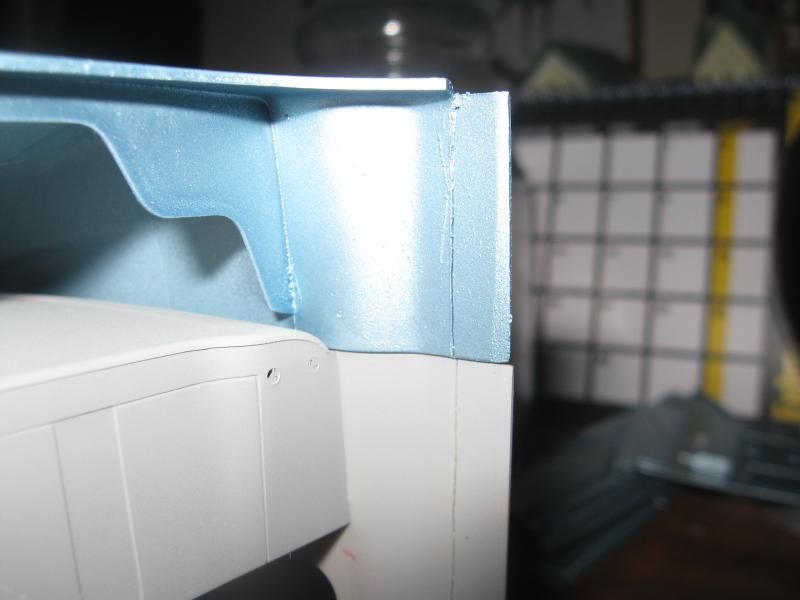

I take it you did not have any fit issues with the cab roof?
Sorry about not answering the first time Jonathan. It had a spot on the lower edge of the lower roof piece. I layed it on the cab, and eyeballed the parts, and then used a sanding stick to even it out. you have to use the old take a little off at a time, and then test fit it again and again... A pain, but it works!

Hey, Bud, you gonna paint that front bumper half and half and remove that RH fairing piece like your old 1:1....???? :rolleyes:

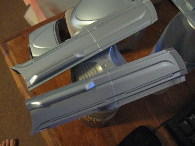

LOL!!! I thought about it, but then I thought NAH!!! :lol:
I did cut in separtation lines on the inside the fairings, and sharpened the edges to correct the fairings...
I did test fit several times , for some reason my roof cab was out of shape just a little bit

That's a great idea about the scribing of the inside of the cab fairings....I wondered about this detail omission, myself.....But in the end, I decided if I tried to make it just "a little bit better" as my dad always puts it, I'd just screw it up.....Something me and my dad do often...."Tried to make it a little bit better, didn't you..." I can hear him, now.... :) You're braver than I am....

I used a piece of blue painters tape to mark the edges. I laid the the tape on the fairing that is supposed to be rubber. I matched the tape edge to the scribed line on the outside, and then scribed a line on the inside. If I had to do it again(and I may still do it), I would use the scribe line on the outside of the fairings, and cut them completely off, and then either glue them back on after painting, or use some correct thickness rubber gasket material. For the life of me I couldn't figure out why they didn't have a line on the inside...
The fairing edges were also sanded down on the back edges to a knife edge. The 1:1 rubber fairing are not the same thickness all the way across.
