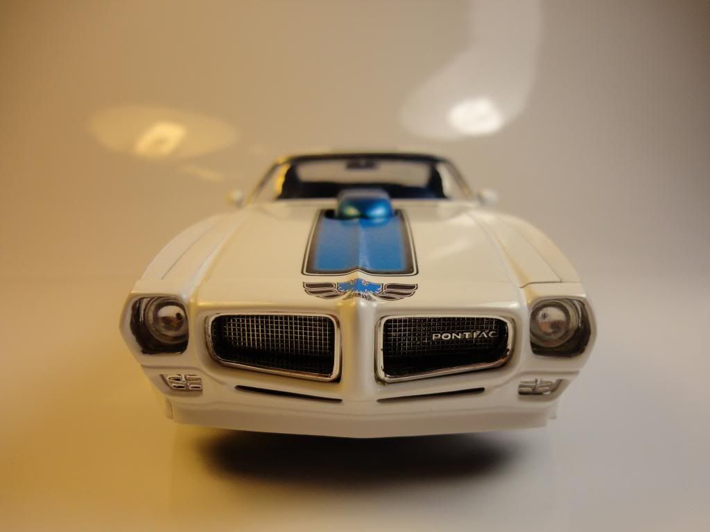

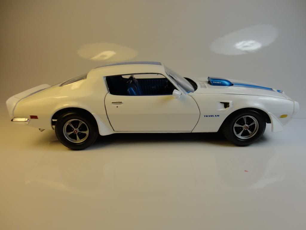

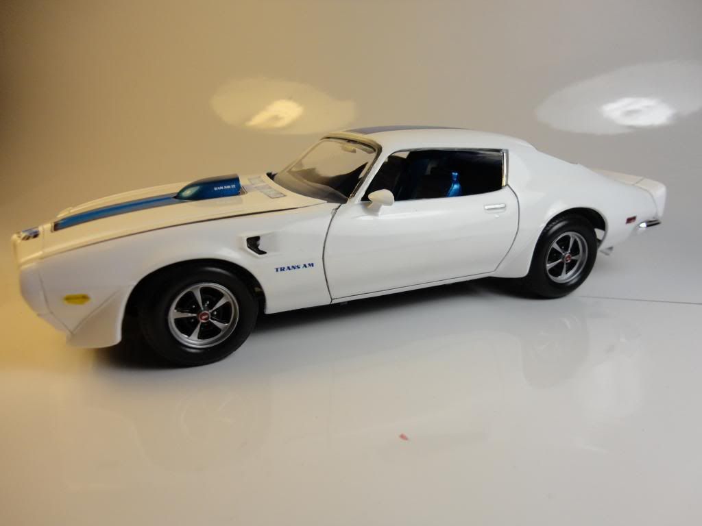

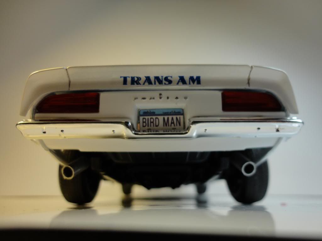

Finally off the bench, Revell 'Motor City Muscle' kit from 2006.

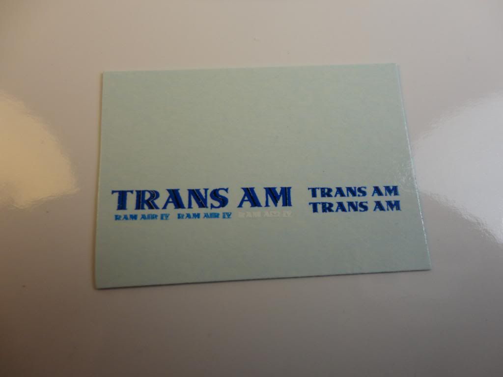

I read somewhere due to a licensing issue the 'Trans Am' decals were not included, so I had a friend make some for me and a fantastic job he did too!

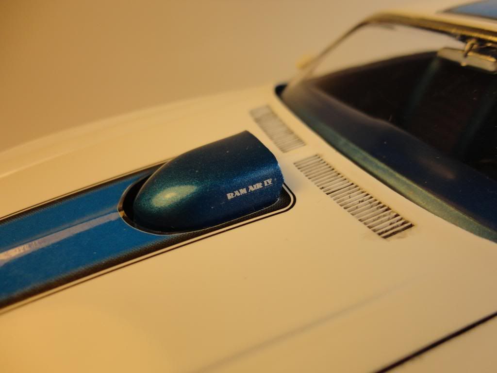

After looking at countless pictures of this car, I settled for the gloss white paint & blue stripes. rather than using a clear coat, I decided to polish the paint using the Tamiya coarse then finishing compounds.

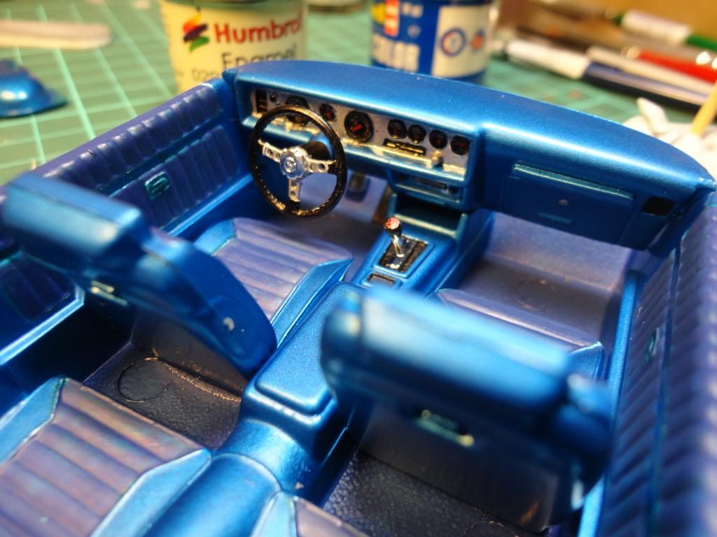

Colour is 'Mr Colour ' white and the interior is 'Tamiya' TS-54 light metallic blue (with a dull coat) also using a Revell flat blue as a secondary colour.
Engine was enhanced using a pre-wired dizzy and dominator carby from 'Pro-Tech' and I did a subtle 'drop' at the front end. I was going to use Pegasus Chrome Ts for the wheels but settled for the factory rims which were de-chromed and repainted silver.
Thanks for looking guys :) .

Looks great! However I think you have the spoiler mounted backwards?

Looks very good!Nevertheless it is necessary to change the spoiler.

Thanks Ross, must had a 'Homer' moment during construction, nevertheless all sorted now with updated photos....thanks mate ;)

Nice build! Love it in white...What's the paint used for the interior?
X2 i did a '69 glacier blue camaro with a blue interior and i did not get it quite as nice as yours. I plan to recreate the scheme when i do the 1/12 version.

Looks great. I particularly like the inrterior, and the polishing worked great.

Very nice. Other than the spoiler, I noticed seams on the seats.

Tamiya TS-54 Light metallic blue with a dull coat guys
