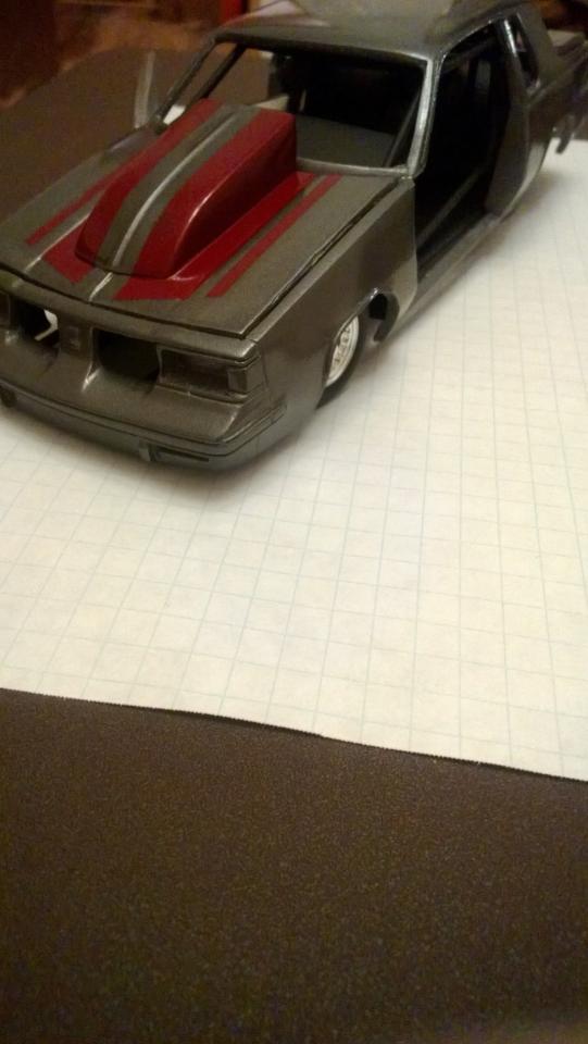

well its all most done for the show on may 4th n stl Attached File  CAM00126.jpg   46.66KB   0 downloadsAttached File  CAM00129.jpg   67.12KB   0 downloadsAttached File  CAM00137.jpg   61.89KB   0 downloadsAttached File  CAM00138.jpg   73.24KB   0 downloadsAttached File  cid:737.jpeg   49.52KB   0 downloads

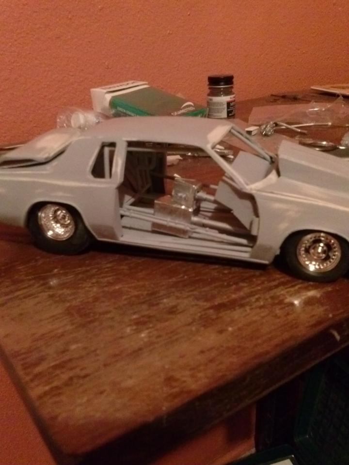

Well its painted now so one to geting the turbo satup riteAttached File  cid:436.jpeg   49.1KB   0 downloadsAttached File  cid:61.jpeg   43.5KB   0 downloadsAttached File  cid:373.jpeg   50.86KB   0 downloadsAttached File  cid:781.jpeg   53.51KB   0 downloadsAttached File  cid:485.jpeg   49.8KB   0 downloadsAttached File  cid:985.jpeg   49.85KB   0 downloadsAttached File  cid:165.jpeg   53.85KB   0 downloadsAttached File  cid:69.jpeg   41.41KB   0 downloads

Well had som time since the wife an kids our gone lol got the turbo setup lookn rite now som paint an thn the little details.Attached File  CAM00144.jpg   79.82KB   0 downloadsAttached File  CAM00142.jpg   76.54KB   0 downloads

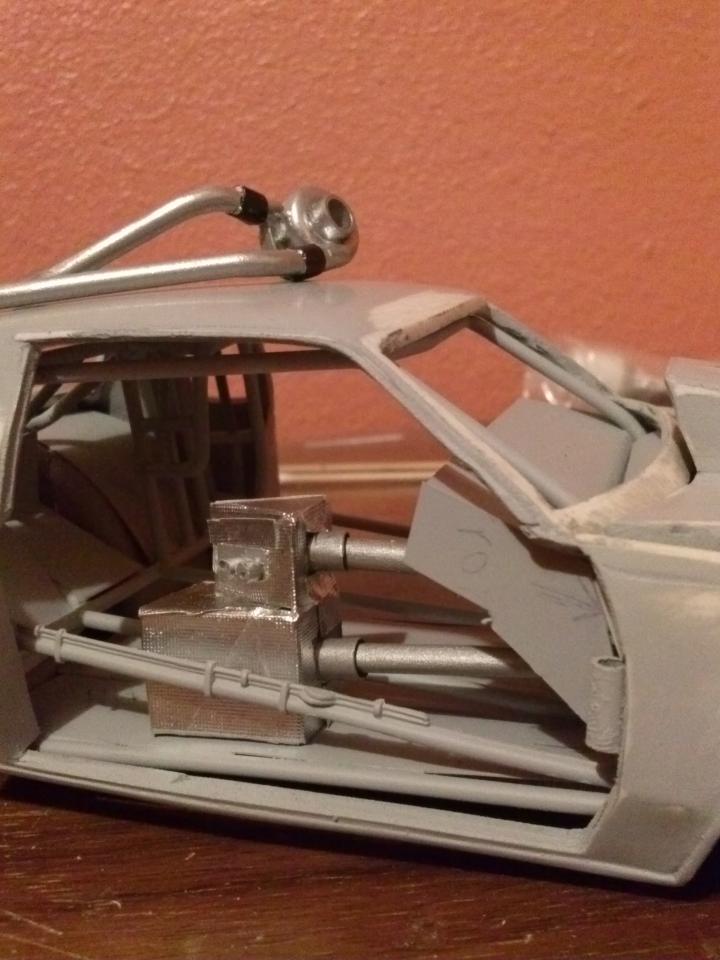

Allmost done turbo whit a little Nos Attached File  CAM00157.jpg   66.56KB   0 downloadsAttached File  CAM00156.jpg   63.93KB   0 downloadsAttached File  CAM00154.jpg   61.15KB   0 downloadsAttached File  CAM00152.jpg   61.86KB   0 downloadsAttached File  CAM00151.jpg   59.84KB   0 downloadsAttached File  CAM00153.jpg   64.26KB   0 downloadsAttached File  CAM00160.jpg   91.36KB   0 downloadsAttached File  CAM00162.jpg   83.37KB   0 downloads

looks good! but there is a problem i would like to point out to ya.your turbo plumbing is wrong.headers are suppose to run into the turbin side !

Stan is right. I don't want to dis your build but it is not correct. The turbo runs off the exhaust and the way you have it plumbed it will do nothing. Do a search on Nelson Racing Engines. You will find all kinds of reference pics.
The headers need to route into the turbine side like Stan said. That is the side you currently have plumbed into the firewall. The compressor side of the turbo will go thru the firewall into your intercooler box and then back out, into the air box on top. The outlet for the exhaust should run out the front fenders or back under the car..
Just trying to help.
