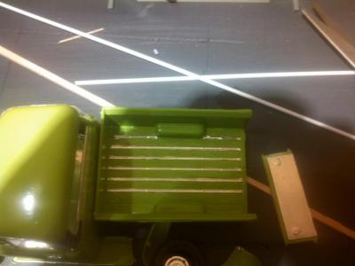

This morning I had a thought and tried it out.  I took a "flux brush" (for applying solder when sweating copper tubing) and trimmed the bristles down to about 1/4" long.  This worked pretty well to burnish BMF into tight crevices.  Its stiff, so you have to be careful with it.  I'm sure it will scratch paint if leaned on to heavily.

I wouldn't go near a painted model with an acid brush, especially one that has been cut down.  I use them professionally where I work and  they can be very aggressive to any finish.  It's like washing a car with a bristle brush.

How I do my BMF, cut and place on model, rub down on BMF with finger, use a cut down toothpick shaped to a flat-head-type shape and burnish that and then trim. After that I run a t-shirt or rag over the BMF to burnish it down more and sort-of polish it. I would be careful with the flux brush, you might scratch your paint or tear all the BMF off by accident..
