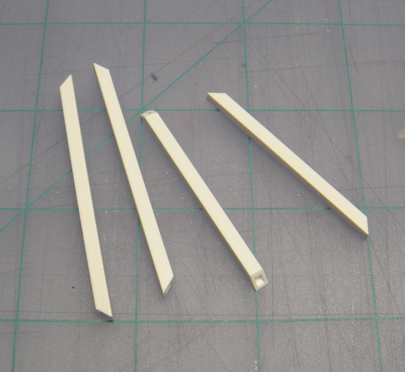

First decide the size of your basic frame and cut the pieces to length.  The short side of my frame is 50mm and the long side will be 60mm.
Take a short and a long leg and glue the corners together.  Use the grid on you cutting mat to make sure the joint is square (at a right angle to each other).

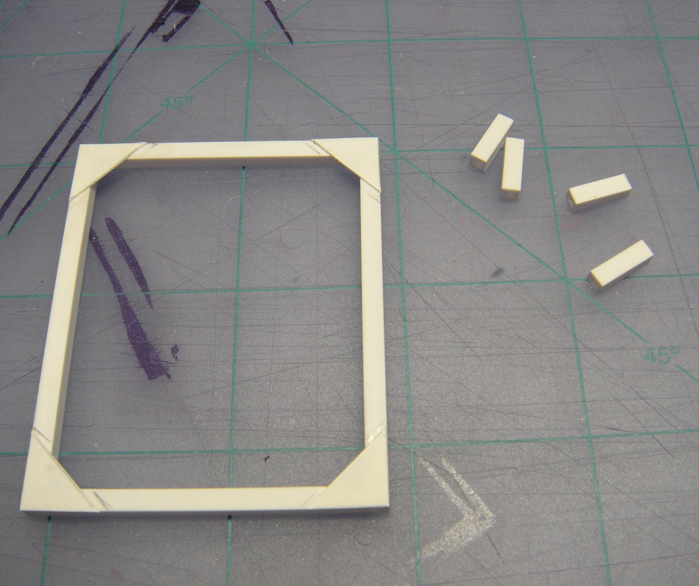

Use some sheet plastic, I'm using .010, and create some corner gussets.
Glue the gussets on top of the legs to reinforce the corners.
Join the to sides together and and the gussets plates.
Next cut some legs for the stand, mine are 10mm long.
Glue the legs in the corners with the tops resting against the underside of the gusset.
#2 afx
afx
  • 1,745 posts
  • Location:Crownsville, MD
  • Full Name:JC Reckner
Posted 27 April 2014 - 03:53 AM
And there you have the basic frame.
