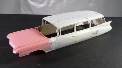

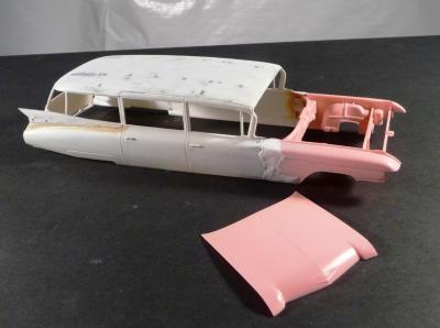

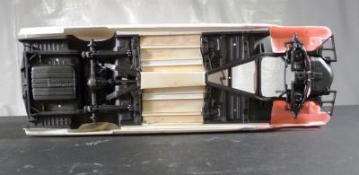

Found my long ago project of making the original caddy before it becomes the Ectomobile, I grafted the MonoRev eldorado clip to the front and stretched the m/r chassis
Attached File  P1030169.JPG   68.93KB   0 downloads
Attached File  P1030170.JPG   107.91KB   0 downloads
Attached File  P1030171.JPG   92.43KB   0 downloads
greg
