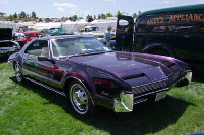

I appreciate the help and the quick responses. this started as just a thought as I was looking for something and came across a glue bomb of this
no laughing....
seriously.....
probably been done already
Attached File  1966-Oldsmobile-Toronado.jpg   38.02KB   0 downloads
I know Leno has his twin turbo one, and that's what gave me the idea of a Ferrari motor, cause Leno has his. didn't want to copy. too much of a stretch? really want to do a custom, a real non-traditional custom. lots of engine bay for that V12.

Posted 06 May 2014 - 07:17 AM
I think a Ferrari V12-powered Toronado would be just right. Chop that top a little and make up some 18 or 20 inch rims with the Toronado centers...yeah baby.

I like your concept.  May I suggest using an exotic American engine.  The Viper V10!  The Riv front end is plenty long enough, and you can get a kit cheaper than an import.  Either way, have at it.  I'd love to see the build.

... The Riv front end is plenty long enough...
?? Purple car in the photo is an Oldsmobile Toronado., about '66 I'd say.

        You might consider one of the Accurate Miniatures McLaren M8B's. Period Big Block with Tall Injector Stacks. Heck you could even makeup a Story how the Guy had a Neighbor that wrapped his M8 'round the Oak Tree (rip) at VIR. You're just gonna widen the track 6 scale inches.

Yeah, and you could even put the McLaren Chevy engine in the back seat. Make a mid-engined Toronado...sorta like the "Hemi Under Glass", or half of a Hurst Hairy Olds.
