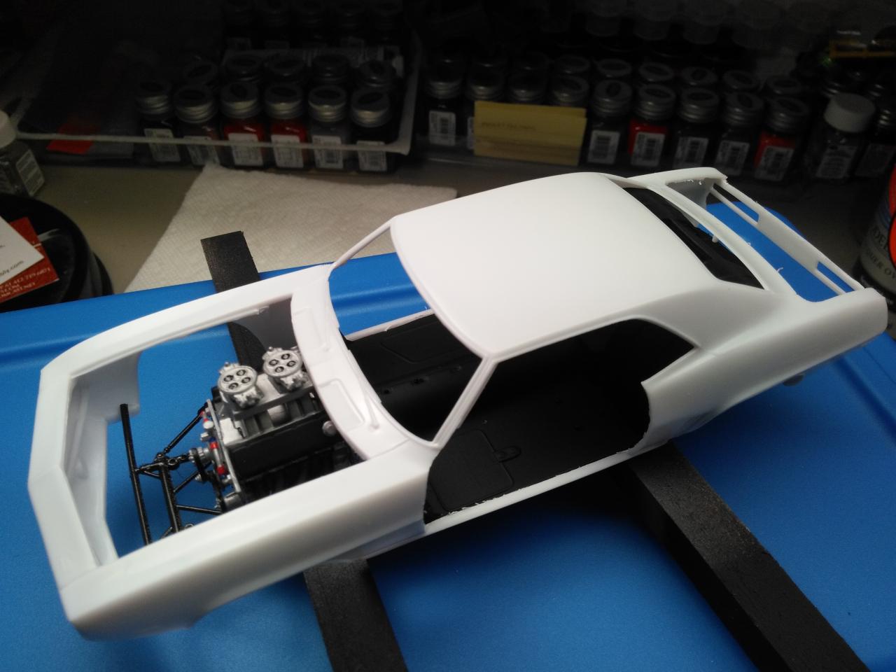

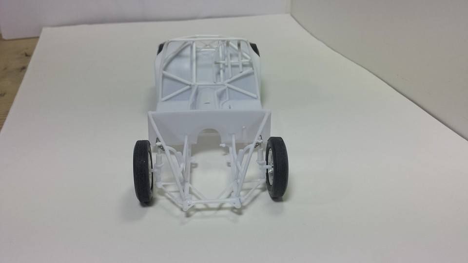

What's up fellas.... this is one I started on yesterday.. this one will have a vinyl top.. I used the pro sportsman chassis as a start, but will be only using a few pieces from it . There were a few modifications that had to be done first though... I had to move the lower strut arms back to center them up in the wheel wells.. here's a few pics.. thanks for looking and comments welcome...
these pics show the changes made after re-locating the lower arms, and removing the raised beads from the rear wheel tubs, and floor board. I also cut the front firewall down so that it is not as tall, I also removed the molded in dzus fasteners, and brakes lines and cables that were molded in the chassis, these will be replaced with lines and cables later..

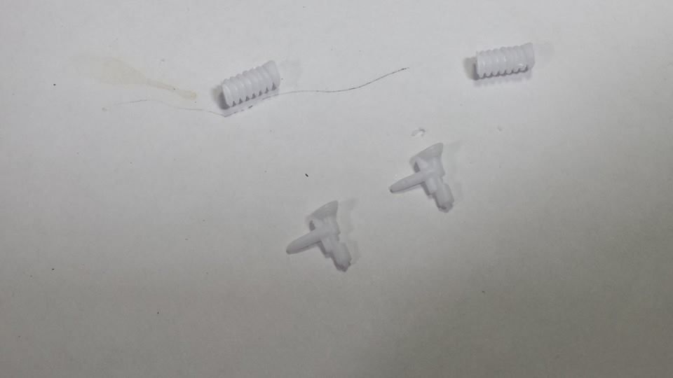

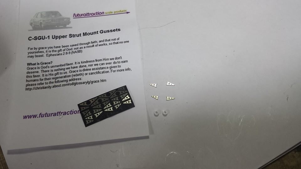

next up I modified the front frame rails I filled in the holes with .035 styrene rod and filled down the mount tabs for the front struts and made my own I used the strut mount gussets from Scott...

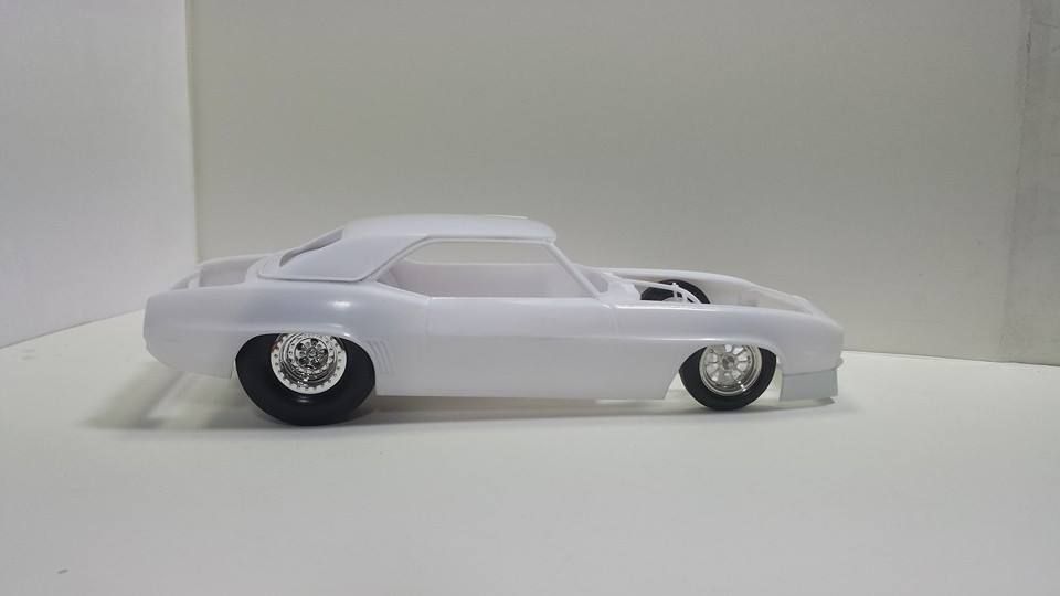

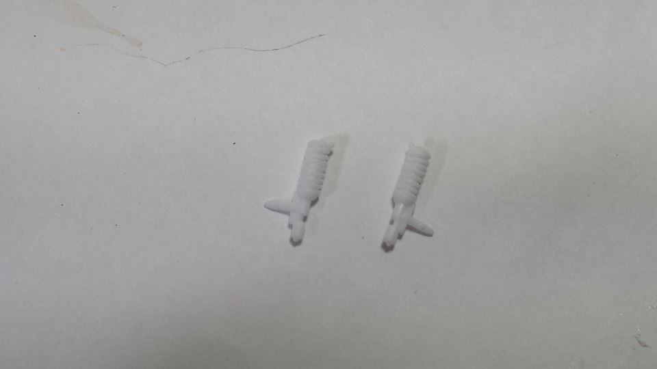

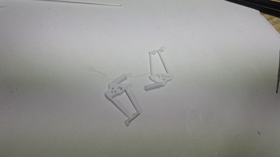

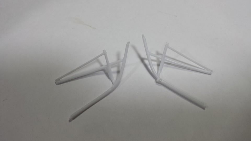

then I modified the front and rear struts.. I'll make the springs later...

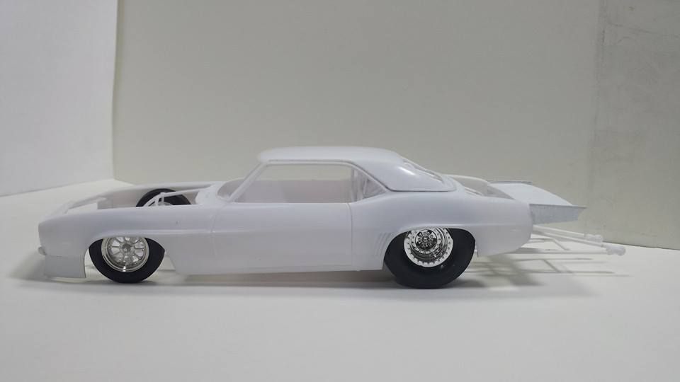

here's the rear..
10543650_4449181844598_21735250552656399
10393928_4449182004602_75230579478276779

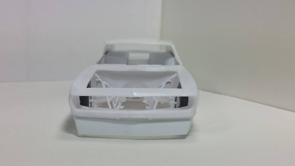

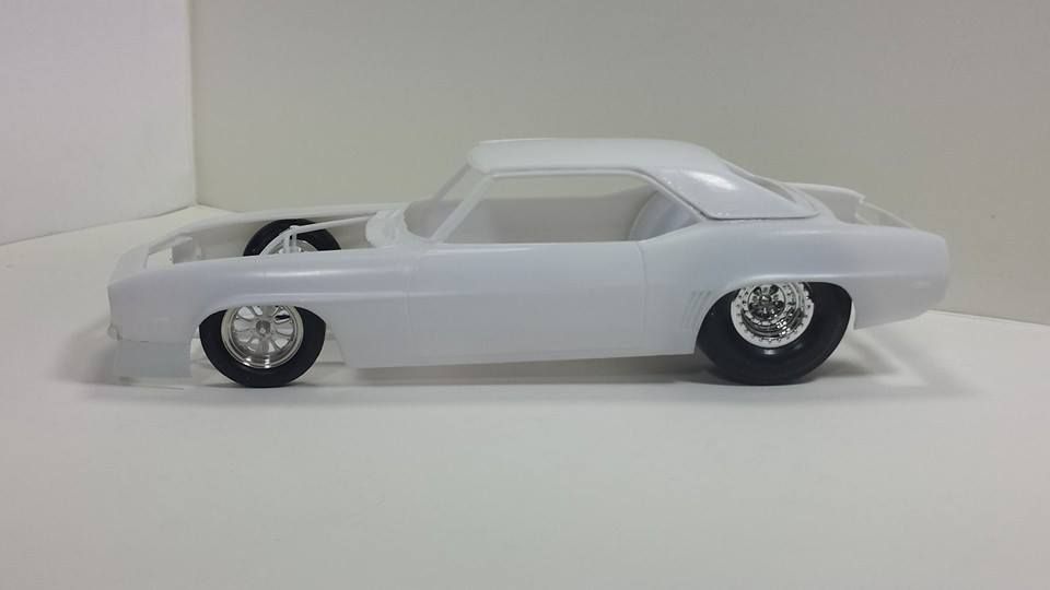

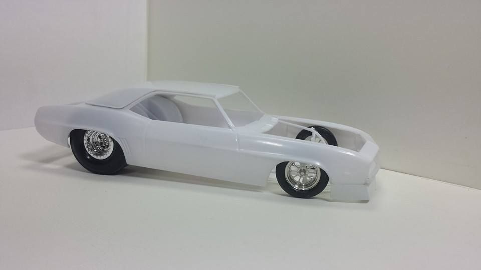

here's a few mock ups..
10460272_4449182164606_35502761630663645
10417468_4449182404612_73064843358673231

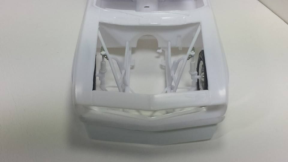

Looking great as always, I will be following this one closely since I have one of these started myself, it won't be nearly are good as yours but I'm stretching my skills and I'm sure I will learn a lot from watching your build. Thanks for posting your step by step!
