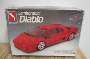

One more in the lineup of my 2 decade-old models. If I remember right, this AMT kit was a door prize which I was wondering what to do with. Since I'd had the flame image of the 1:1 prototype for a Pacer pickup rattling around in my mind at the same time as a Ferrari with sidepipes, that's what brought this about. I worked occasionally on it from '92 to March '94. It was pictured in the GSL coverage of SAE's '94 contest annual, and also again in that same magazine on page 42 for the Springerville AZ contest. Where'd 20 years go?
Whacked the roof, but not much else custom beyond the Fujimi wheels and Pirelli P-Zero tires. My dad lathe-turned the outer rims from aluminum. I was living in NM at the time, but I figured an Arizona plate would do good on this one - hot car for a hot place.
