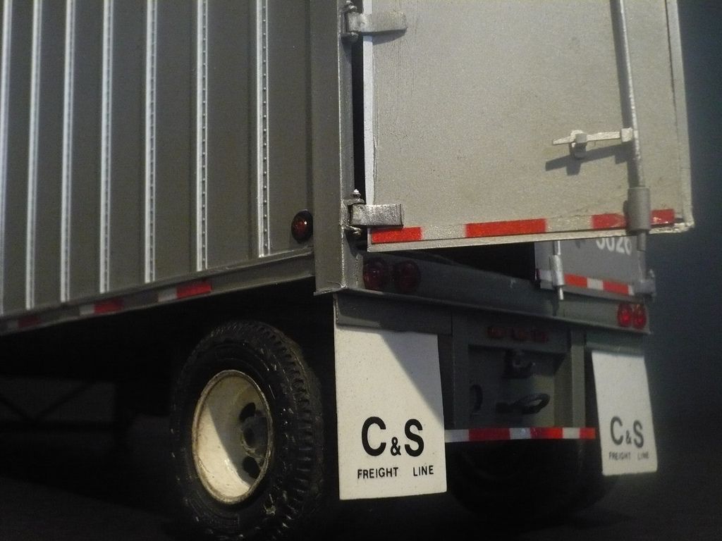

As far as the doors I was really hoping that the lock rods and hinges would have been seperate but no big deal. I've made hinged doors before which I'll post a pic of so no big deal.
