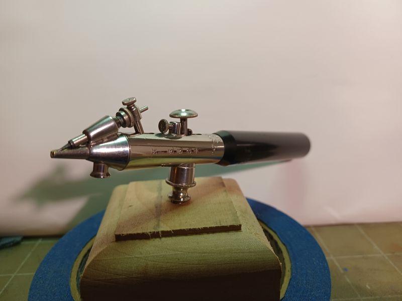

There are two levers on the U. The top (trigger) controls the air. The second controls the paint flow. The finger pad makes contact with the second lever to start paint flow. This means the trigger (air) is"full on" when the paint begins to flow. The further down the paint lever goes the more paint is sprayed. The wheel on the back lowers the paint lever. With practice you could have a preset amount of paint flow when you start and you could then modulate the trigger and use less air. This wheel works similar to the wheel on the front of older Paasche V or VLs or the screw on the post of a T&C or Badger. Those move their trigger backwards which will start paint flow.
The pic shows the trigger just at the point of touching the paint lever.

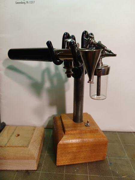

I had one show up yesterday. Wold model U.

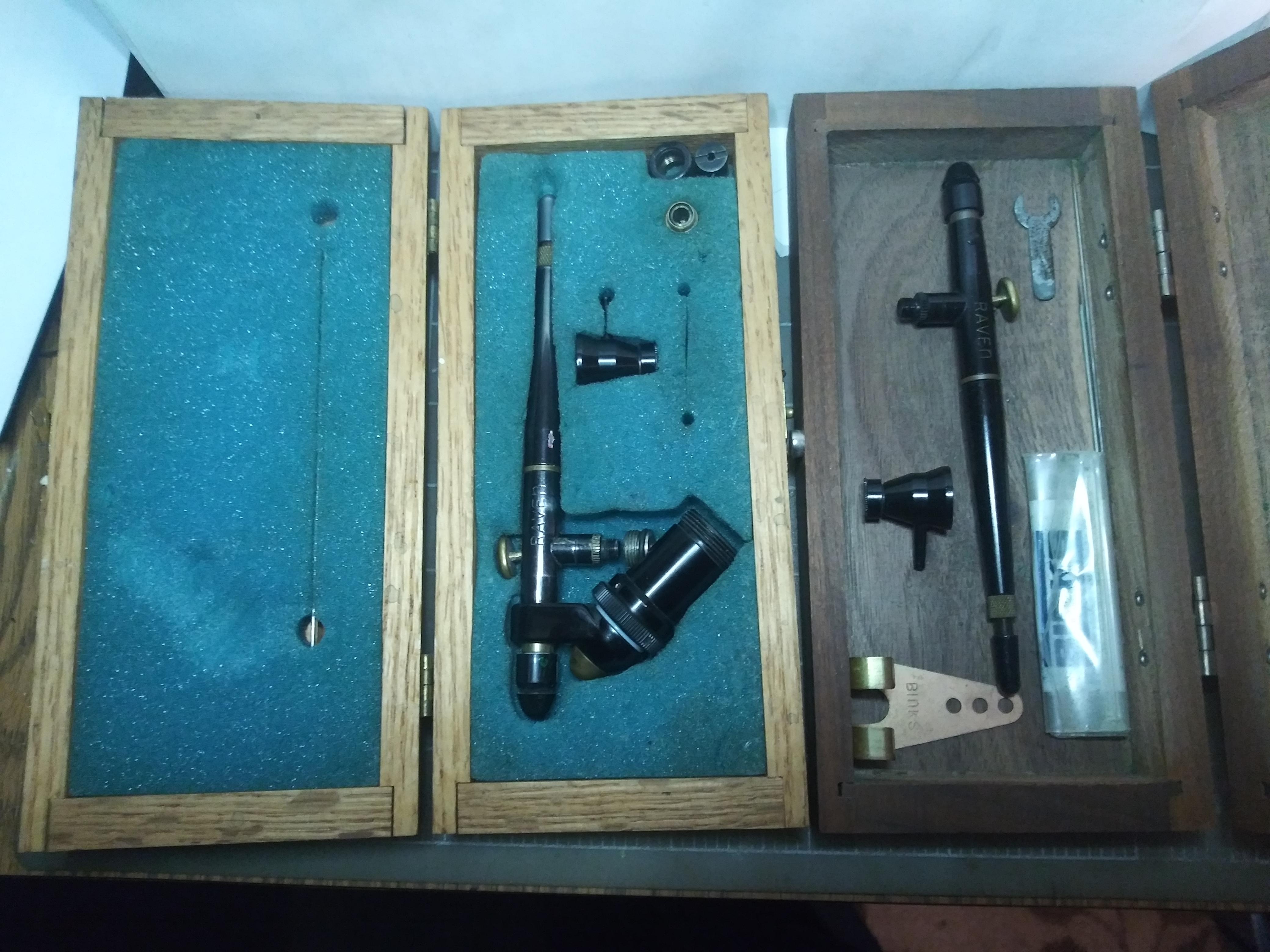

I added a couple more early brushes to my collection. They are both Aerograph E type brushes purchased from two different sellers in the UK.
I wanted the first one as I knew it was produced before the Super63, which coincidentally debuted around 1963 from what I've been able to learn, although I didn't know when for sure. With a bit of research I've found it should have been made around 1920-1930.
The second one is older. From the bulb style air valve connection this brush should be from the early 1900s to 1920.
Charles L. Burdick founded the Aerograph Company (originally named the Fountain Brush Company) and moved to England. This brush has Chas L Burdick and the word Patent on the handle. There is no patent date. Both cases look to be original and in pretty good shape considering their age.

You are welcome Joe. I know most members here don't give two hoots about it but there are a few here who appreciate these vintage brushes as I do. Although I have nothing against more modern brushes, I have a few, my main focus now is finding early ones. I love the history and the design concept of them.The N was designed to not have paint in the body of the brush. The paint is only in the head. The brush is double action. A friend of mine has a number of the N models. He says it sprays as well as his Iwata HP-B. He is an artist not a modeler so his comparison means a lot to me. That said, this N may become my favorite and most used airbrush.
This is how the siphon jar is opened. There are two ears that hold the jar when given a half turn.

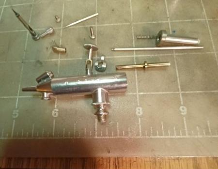

The disassembled brush is a Wold model A-1 I am working on. Not as old as the N.
