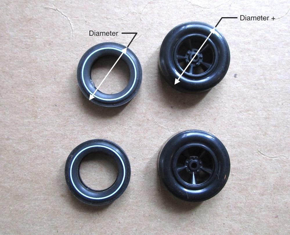

I hadn't considered that the outside diameter of the road wheels would block view of the pivot point of the road wheel arms at the hub detail. I have to change that so we can see it. I extended them using the wheel axles from the other arms and then glued them together pinning them with brass rod. This will look more interesting on the model.
