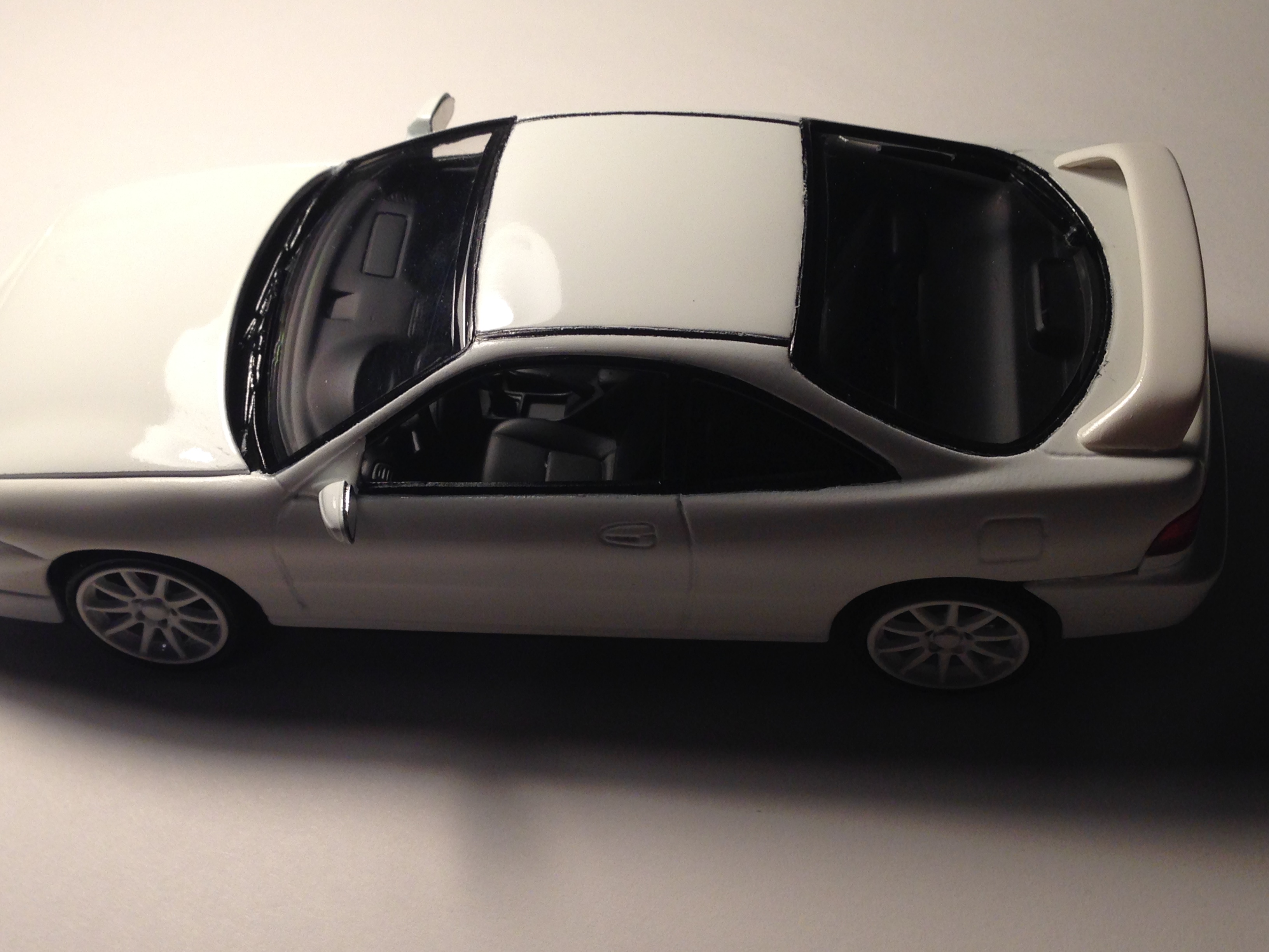

I really need to build a photo booth.But here is a bit of a mock up for a sneak peek of what I'm working with.I masked off the windows and sprayed around them black although you really can't tell in these pics but I'll try and shoot better pics once completed.Since I don't have the Type R wheels I originally wanted to go with,I picked these out of the Revell Mitsubishi Eclipse ,dechromed them and painted them the same color as the car. (which I plan on doing soon.)They don't look too bad.

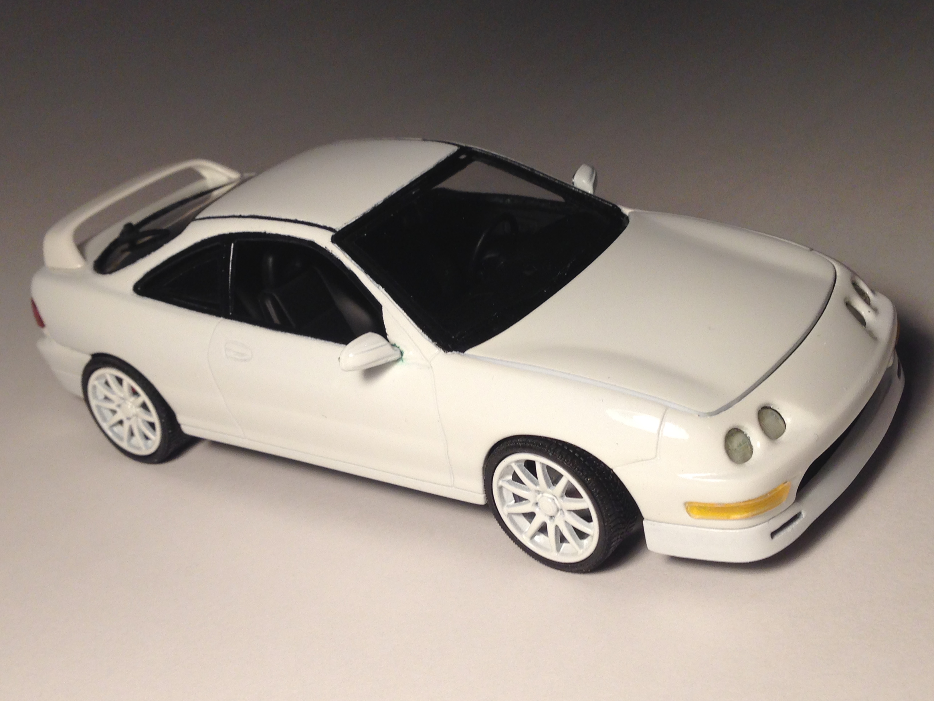

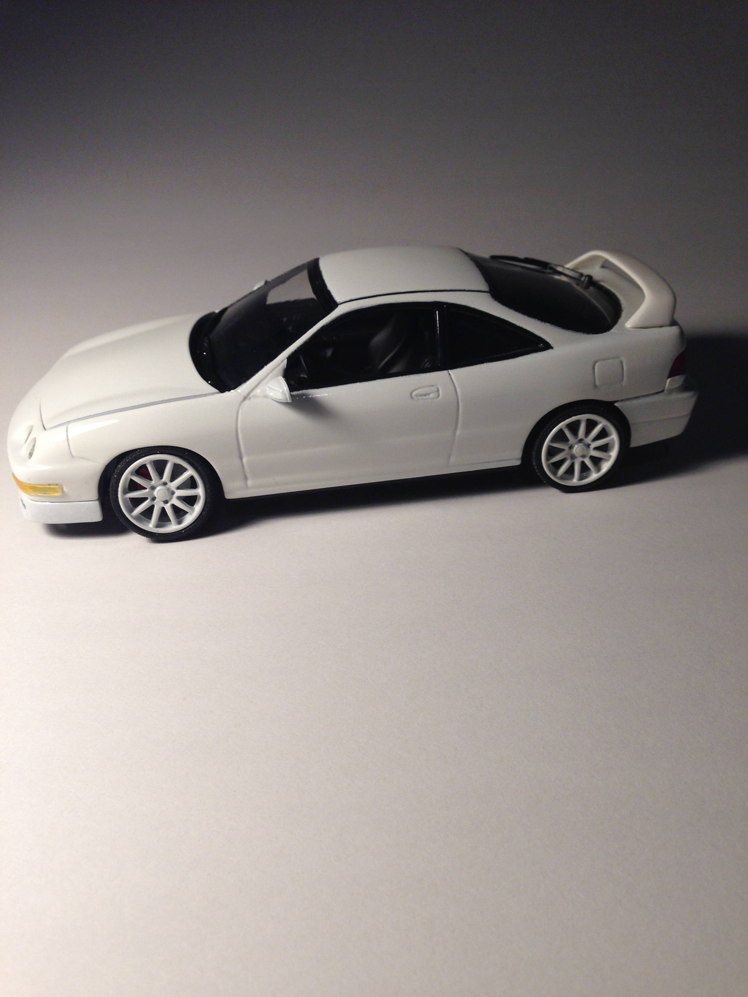

Update (Finally,I know,right?) let there be paint. Gone is the ugly ricer paint replaced by gloss white.After a mishap with cracking primer and having to sand it down again,I'm glad to have some progress going.The paint came out a bit orange peely so I sanded it and polished it out.Still not perfect though.I was a bit disappointed with how the black trim came out since I ran out of fine line tape at the time I did this.Plus,I had to rescribe much of the molding lines .The paint is just regular Rustoleum Gloss white with Rustoleum Clear.I didn't want to use Testors enamel since that tends to lay on too thick.I was surprised at how fast this dried and was ready to polish.

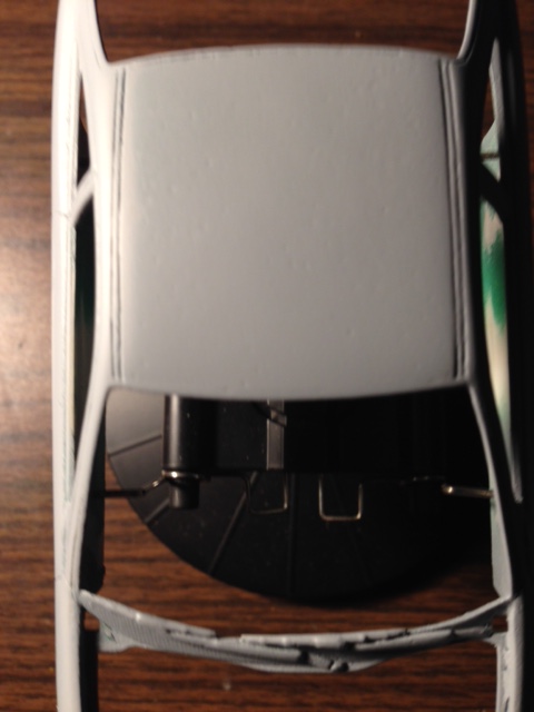

I don't know what this model was painted with but it's been a nightmare.This has never happened to me before but the primer "cracked" everywhere on the body and the hood after a couple of days but the paint underneath didn't crack.Very strange. I have since then completely resanded and removed all the paint right down to the plastic ,re primed and so far it has worked out.I know it's not the primer because I've been using it for a long time and never has gave me problems.And I know it's not the can or a bad can because I just used it on a couple of other projects and it worked fine.My "workhorse" primer is the Dupli-Color Sandable primer and it's always been very reliable.I like the High Build primer for heavy body work.You have to be a bit careful with it because it does thiken up and can hide details.

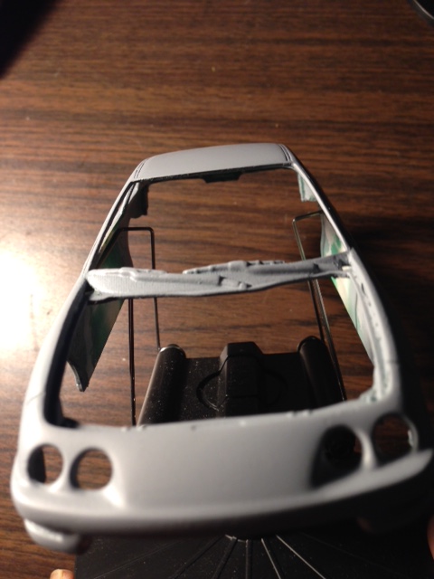

Amazing what primer reveals.The purple power did take off the stripes and clear.But it didn't touch the green.Which is ok because it's not that thick.I'll have to rescribe the moldings and fix some other flaws,Those aren't pinholes on the roof.This was a very light dusting of primer just so I can see the flaws and they will sand out.
