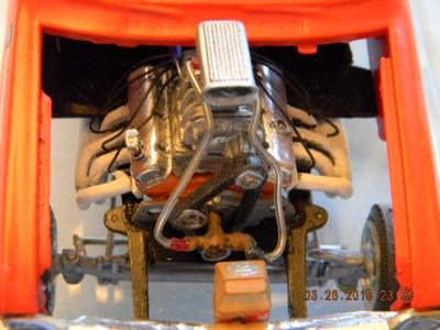

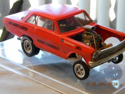

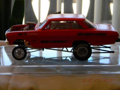

will69 Posted March 28, 2015 Share Posted March 28, 2015 PRE FUNNY CAR STYLE Quote Link to comment Share on other sites More sharing options...
cobraman Posted March 28, 2015 Share Posted March 28, 2015 Nice ! I love the AWB cars. Quote Link to comment Share on other sites More sharing options...
slusher Posted March 28, 2015 Share Posted March 28, 2015 Great looking model.. Quote Link to comment Share on other sites More sharing options...
W-409 Posted March 28, 2015 Share Posted March 28, 2015 Good looking Chevy II. These were really good looking cars built like this and your build proves it. Nice decal work and sharp engine details. I like that color as well. But this is not a Factory Experimental car at all. It's an early Funny Car / Match Race car as you said, but not Factory Experimental as the title says. Quote Link to comment Share on other sites More sharing options...
iBorg Posted March 29, 2015 Share Posted March 29, 2015 I picked up the Rat Packer today. I think it will be a fun build but have always hated the chassis. What chassis did you use? Thanks, Mike Quote Link to comment Share on other sites More sharing options...
will69 Posted March 29, 2015 Author Share Posted March 29, 2015 I used the kit chassis, though they are crude. Quote Link to comment Share on other sites More sharing options...

Rotorbolt73 Posted March 30, 2015 Share Posted March 30, 2015 Excellent work on this kit. I have one of these kits myself and yes the chassis is quite crude. I made all sorts of mods to it to make it better. Ended up giving it to a friend who needed it more than I did. Still have the body though, gonna convert the body back to stock and make it a pro streeter one day. By the way, this kit is a 1965 Nova. Not a 62. Quote Link to comment Share on other sites More sharing options...
Skip Posted March 30, 2015 Share Posted March 30, 2015 (edited) I used the kit chassis, though they are crude.Just popped open a Rat Packer, that isn't the came chassis in the kit, which is the same as the Funny Farmer Tempest, the Mustang and I think the Syclone. All of those chassis are the same round tube "perimeter" type chassis that they have came with since they were first released in the mid to late sixties. About the only thing that's ever been changed on these kits are the decals. This series was supposed to depict the A/FX cars that were running at the time. I don't remember which one came out first, I remember getting the Rear Engined, Plymouth 'Cuda first then the Chevy II so I suspect it was the second of the series; I think that only the 'Cuda had the term "Funny Car" associated with it so AMT most likely aimed these models as being A/FX Class. One has to remember that the rules regarding A/FX or Factory Experimental were pretty loosely based and were subject to interperatation in many cases, when the bodies began to start lifting to access engine or driver's compartment is about the time the term "Funny Car" began being applied. This AMT Series was more of a "Match Racer" configuration than Funny Car. With some work, the chassis and interior buckets can be detailed to replicate a typical AWB A/FX car just by doing things like fitting the chassis sheet metal to the body, all of them are way too short all the way around to "seal" the chassis to the body. With a little Evergreen sheet and a little tubing you can make this chassis work. The other glaring error pointed out by Speed City Resin is that the "Big Block" Chevy engine is way undersized only slightly larger than a Small Block, so a true sized Big Block Chevy is in order for the Chevy II and maybe a 421 Pontiac for the Tempest. Doing some research it almost looks like AMT based much of the front clip which was sold by Bill Thomas out of Anaheim, Cal. Dick Harrell ran this setup in early '66. The major difference between the Bill Thomas' front clip and the front of the AMT chassis is the lack of a parallel upper trestle rail, the Thomas clip used the same firewall supports as the AMT chassis does. Both use nearly identical front axle and parallel spring mounting. The "Perimeter" chassis probably came about because AMT figured they were going to use the Chassis on the other bodies which were all for the most part of a Uni-Body design. I haven't tried it but am told that the Rat Packer chassis fits under the 'Cuda, so you could use it to make the 'Cuda front engined. Looking at a lot of the A/FX cars of the day they were beginning to add some type of chassis under them or at least a stout set of subframe connectors. Of this series only the Murcury Syclone and the Pontiac '63 Pontiac Tempest would have come from the factory with a full frame under them. I really wish that AMT would release,the 'Cuda if the molds still exist, even if the Hemi wasn't that amazing in it, but you could use it to "Loosely" Replicate Richard Petty's foray into Drag Racing, if he had done so in an A/FX that is! Oh yeah, I almost forgot pretty nice A/FX Match Racer. I like it a lot, you've already taken care of a lot of the improvements to make it a plausable Street / Drag and or Race Car. Edited March 30, 2015 by Skip Quote Link to comment Share on other sites More sharing options...
Speedfreak Posted March 30, 2015 Share Posted March 30, 2015 Nice Willard, love the color, and that blown engine looks awesome in there! Quote Link to comment Share on other sites More sharing options...
W-409 Posted March 30, 2015 Share Posted March 30, 2015 With some work, the chassis and interior buckets can be detailed to replicate a typical AWB A/FX car I'm curios on this: Has anyone checked how much AMT has relocated the axles on this Chevy II kit? Because if I'm not mistaken, 1965 was the only year in FX when axle relocation was allowed. As seen on the rulebook: "AXLE RELOCATION: Axles may be relocated on FX cars a maximum of two (2) percent of the total wheelbase, per original stock location. This applies to either front or rear axle, or a combination of the two. Bodies must remain in their original production location. Wheelwells and fenders may be altered to permit installation and removal of wheels and tires but no portion of the tire may extend outside of the fender and/or body lines." So I'm interested to know if this kit could actually be built as a '65 Factory Experimental car without moving axles backwards. I know that I don't know how to count this, as I've never been good at it. Of course there would be still other modifications required, so maybe it would be easier anyway to start with the Trumpeter kit. (Yes, I've been planning to build a Factory Experimental Chevy II some day). Quote Link to comment Share on other sites More sharing options...
