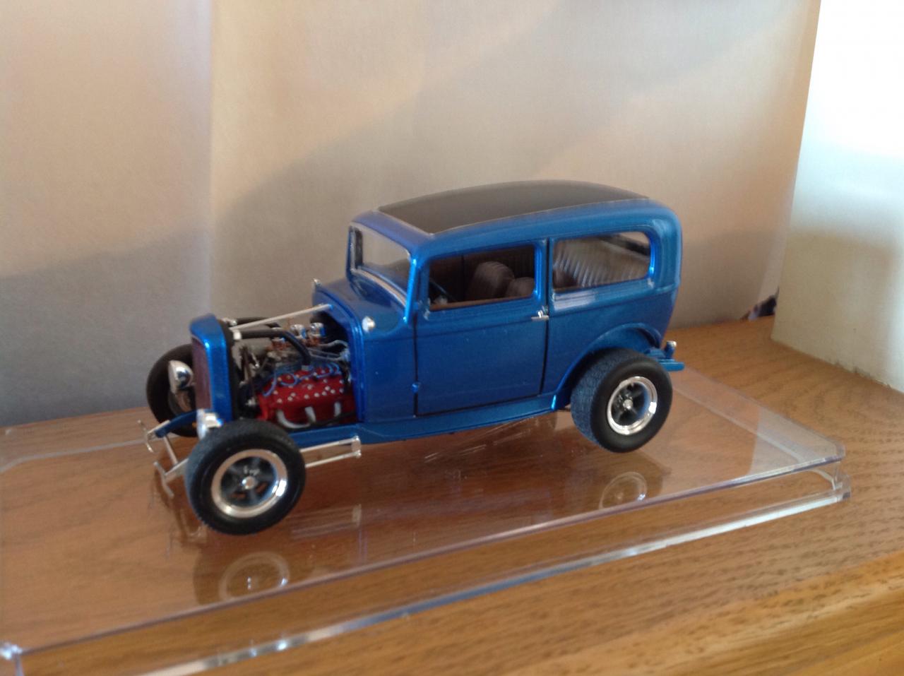

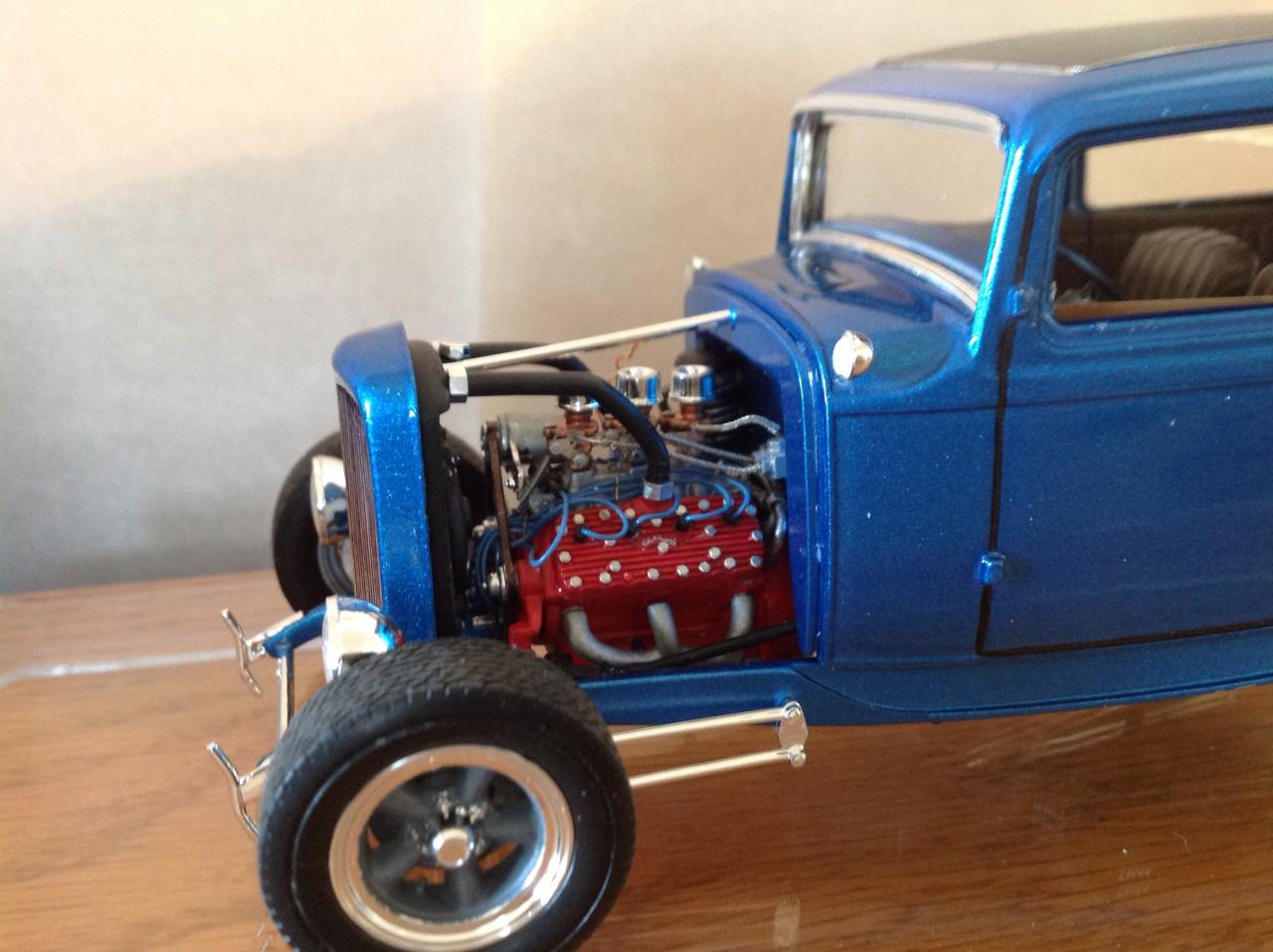

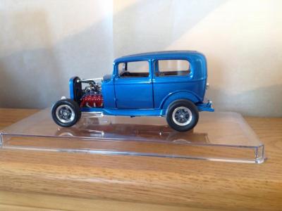

Thank you for all the Great Comments, the color is actually a PPG color I had kickin around, it was leftover from a job I did in the body shop, the color code is WA815k PPG MBC Omni AU (Acrylic Urethane) and I use the 2021 Urethane Clear, I also shoot all my models with the same paint gun I would use on a 1:1 car
Link to comment
Very clean looking model, great job. I'm interested about the gun you are using...is it a smaller touch up gun or full size? Also are you using the same size tip as when your painting 1:1. Most don't have access to a paint booth, mixing room etc. ,but if you do I see a full size gun can work fine.
Link to comment
I am using a Sata Jet Spray gun with a 1.3 tip. It is also the same size tip I use on 1:1's, after trying it once on a model I will never go back!
