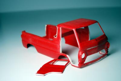

crowe-t - I've had so-so luck with CA glue, including a couple of early ideas on this body, but I did what you suggested. And I think it works! See the images below. Medium CA with an accelerator applied. More CA to fill the gaps. And it stood up to shaping and sanding!
Tom - I've seen your build & it looks great. This being a resin body, I expected and encountered areas of more and less thickness. The front doors were the hardest around the wheel well, it being curved and having a lot of over-flow resin from the extra plastic used to cover the gap to the chassis. Aside from that, once I poked a hole, I could then switch to a #11 saw blade and carefully finish the line. I bet a PE blade and some patience would work wonders. The thickness in the door panel itself was taken care of by scraping away the unnecessary resin a little bit at a time and matching up the kit interior door panel as a guide. It's close, and I'll likely need to fill the gaps with something later. You are correct in that replicating those nice hinges in a reasonable scale will be a trick.

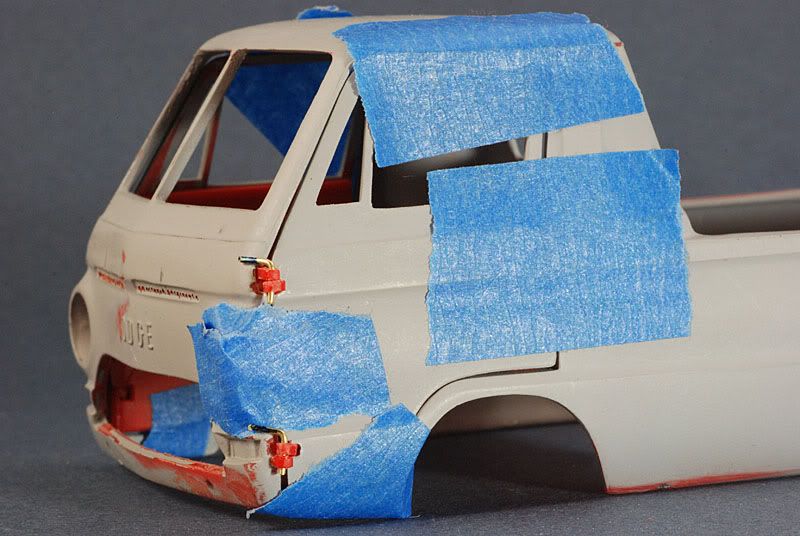

Jarius Watson provided a tutorial on how to lose your mind create the type of hinges I need on this van.
2 down, 10 more to go.

Wish someone would fix the doors and cast it, the door problem kind of keeps me from wanting to do multiple builds of this kit. I did the same thing with the door too.
In progress
