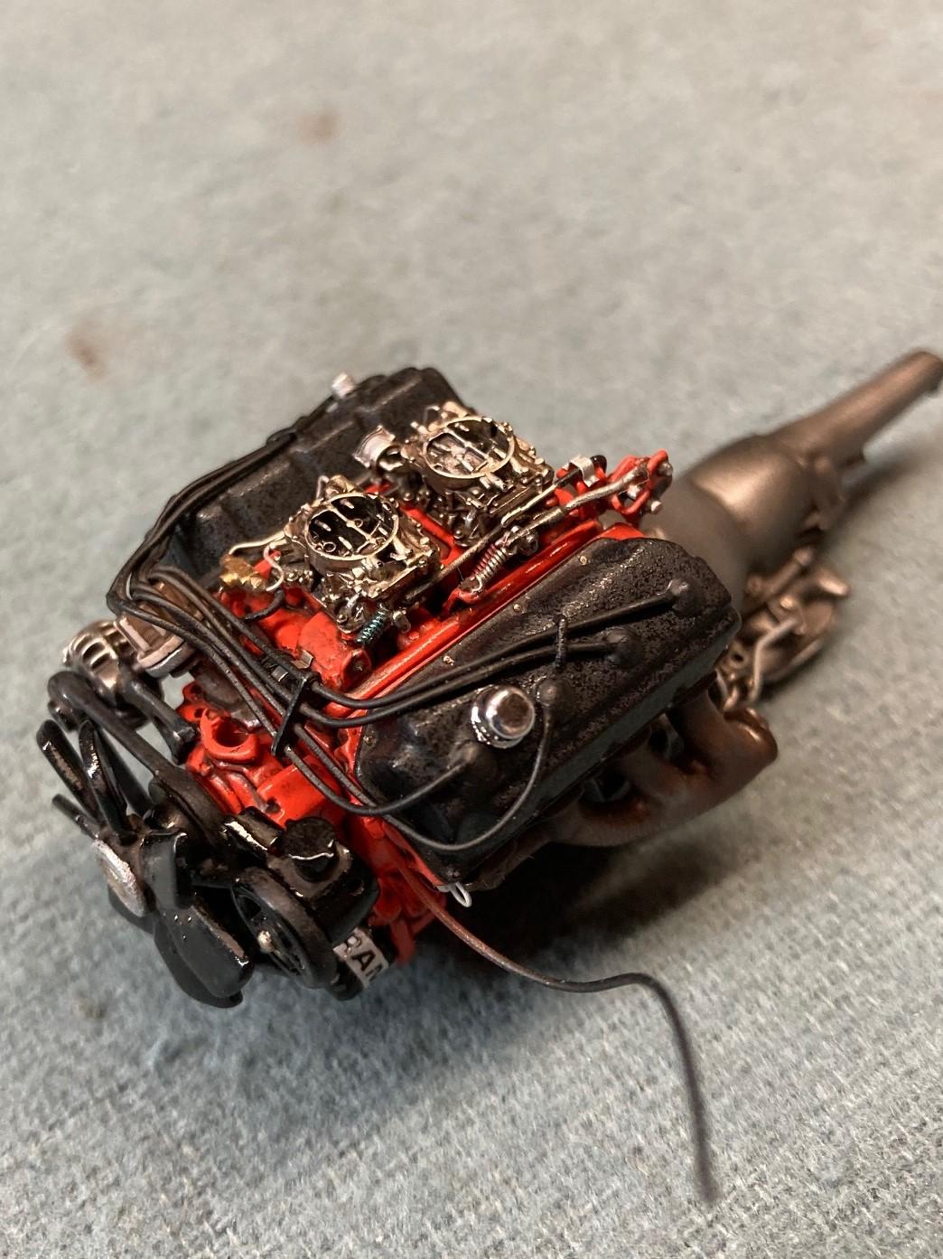

StevenGuthmiller Posted July 9, 2022 Share Posted July 9, 2022 13 hours ago, ChevyD75 said: What would you guys recommend for 1980's era pro stock carburators? 46 minutes ago, Straightliner59 said: I would go with the oft-aforementioned Jet Exhaust. Almost all of them were running Holley Dominators. If you don't have Jet Exhaust, do an image search for the carbs, to give you an idea of what to mix together to create something close. A really great alternative is Alclad "Pale Burnt Metal". You can get very realistic looking results using the burnt metal as a base, give it a light shot here and there with some Alclad aluminum to break it up a little, and then a dirty wash to give it depth. Of course, it helps a great deal if you're starting with a Fireball carburetor! Steve 1 Quote Link to comment Share on other sites More sharing options...

TransAmMike Posted July 12, 2022 Share Posted July 12, 2022 On 7/9/2022 at 1:17 PM, StevenGuthmiller said: A really great alternative is Alclad "Pale Burnt Metal". You can get very realistic looking results using the burnt metal as a base, give it a light shot here and there with some Alclad aluminum to break it up a little, and then a dirty wash to give it depth. Of course, it helps a great deal if you're starting with a Fireball carburetor! Steve The color on the Carbs is great but WOW Steve, that engine is awesome👌 Quote Link to comment Share on other sites More sharing options...
