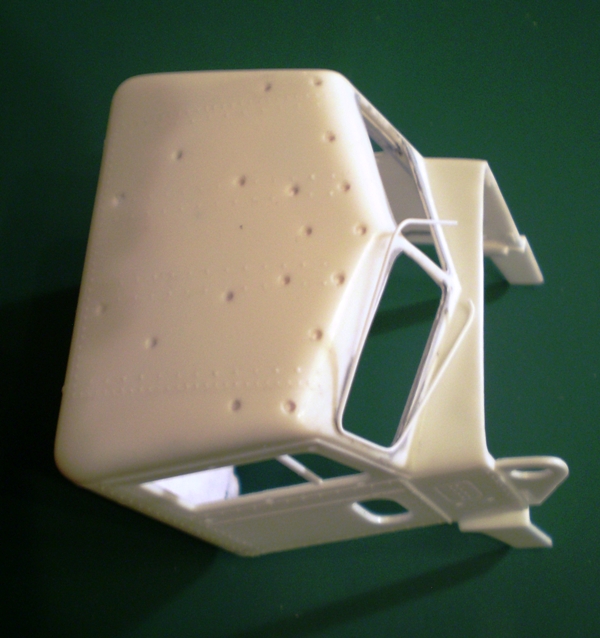

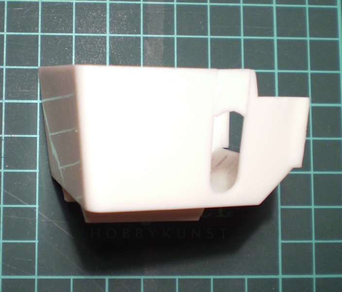

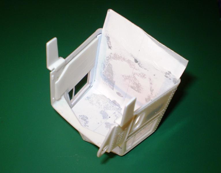

Thank you all very much. Another thing I have changed is the interior tube. I did not like the askew walls. I cut off the sides with the door pattern for later use and threw the rest away. I made a new floor and some simple interior panels.
This is what I mean by askew...
P3090011.thumb.jpg.ea06781e50916955ed06f
The gap between the floor and cab skin is unacceptable for me.
P3090016.thumb.jpg.d5186f8980e8bb95b5585

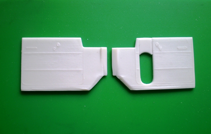

So, this is all I will use...
P3130030.thumb.jpg.f1a86bab65c27073dcae4

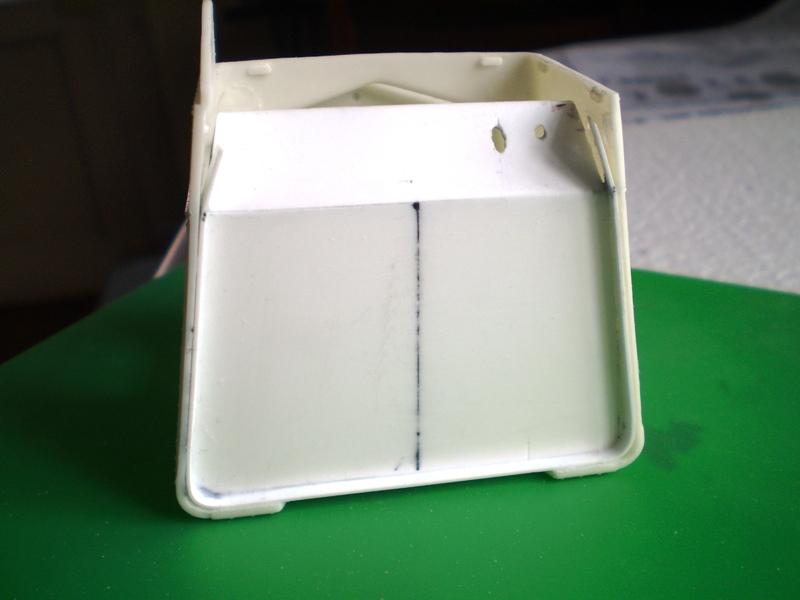

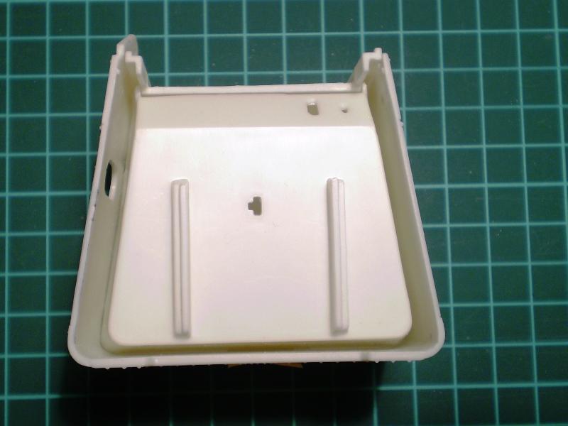

The new floor...
P3130029.thumb.jpg.2db7e218e5d767bc015b4
Actually, I did not take care too much of the cab lining. I used a regular paperboard for the back wall and ceiling.

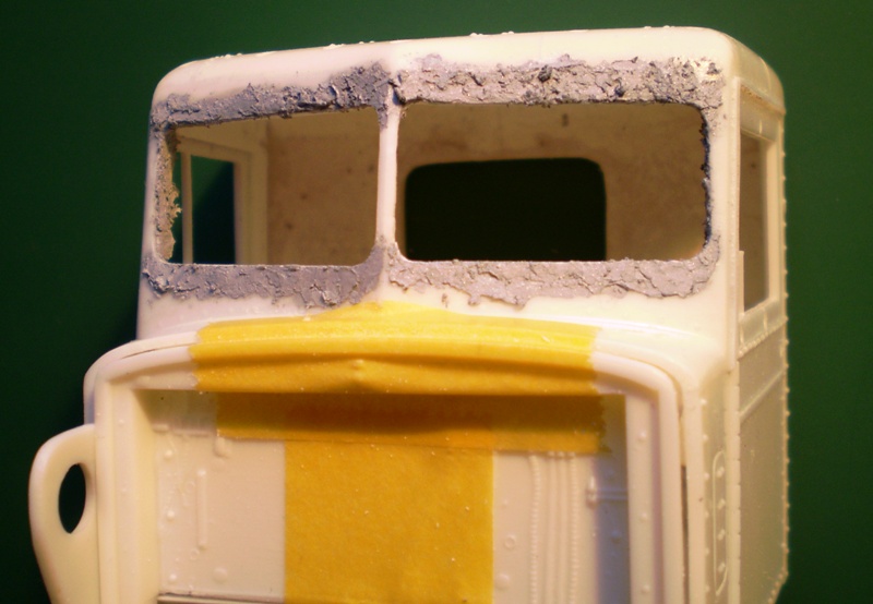

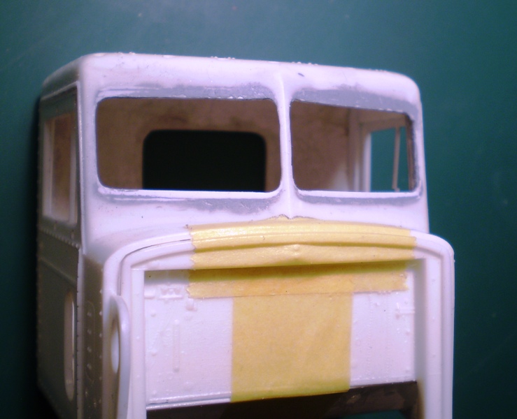

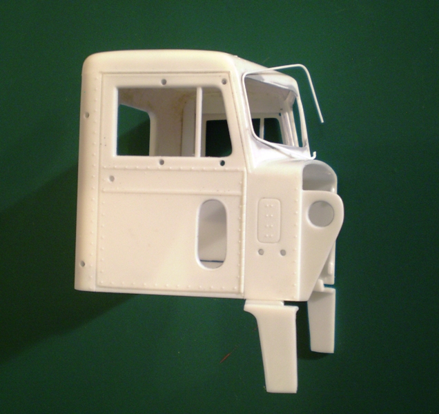

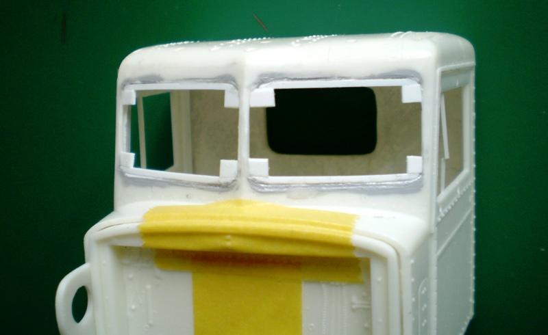

They call this cab little window or maybe small window, I am not sure. But the openings for the windshield seemed to be of wrong shape to me. Too tall, so to say. So, I added a stripe of plastic to the top and bottom and shaped the corners. And I did this twice because it did not seem enough after the first shot.
P4030187.thumb.jpg.8c67f00b5636a806451df
Oh, come on! Don´t laugh! You would not look any better immediately after your plastic surgery. This how the curing went on.
P4040201.thumb.jpg.5e2f6e6716a14ec7d354c
P4050219.thumb.jpg.5b71c1bdfe74fec0787fd

The newly shaped openings need a gasket. I made mine of the Evergreen stock. Since there is an old light bulb in my table lamp that produces a lot of heat besides lighting, I use it for local heating of tiny plastic parts. Did I burn my fingers a few times? Yes, I did. Building a plastic model requires some sacrificing now and then.
I heated up the channel at certain places to make the bends and gradually glued it to the cab.
P3220103.thumb.jpg.fd986bb1693f0cd991f16
P3220107.thumb.jpg.365619a824cf6b61e4403

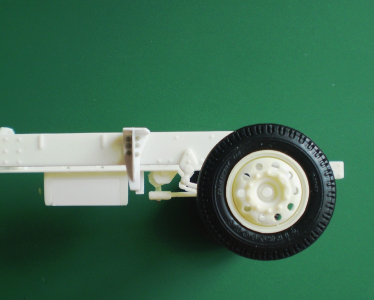

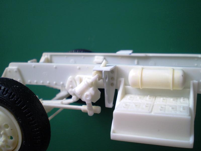

With the new floor I needed new mounting points. I did not want to use the rails like the original floor had. I copied the parts from RoG 359 kit and added them to the chassis.
P3280108.thumb.jpg.d501e060a8bfc6076c53e
P3280113.thumb.jpg.69f0f20a41b664e09423e

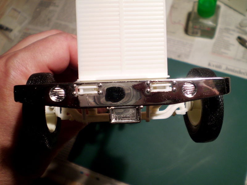

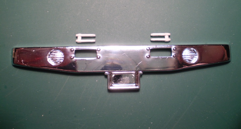

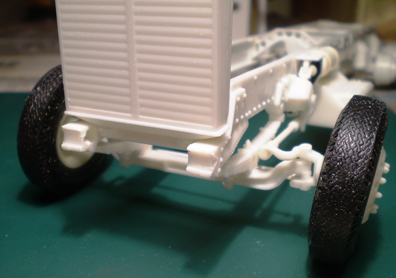

The front ends of the frame rails are too plain. The bumper openings would look kinda blind. The towing elements need to be there. I made me a pair but unlike my Bill Signs model these are not functional.
P4050204.thumb.jpg.2323cea26f89905318cd6
P4050211.thumb.jpg.8ff1a8d2b753f7450abe0
P4050212.thumb.jpg.81a893047c51956a8f532

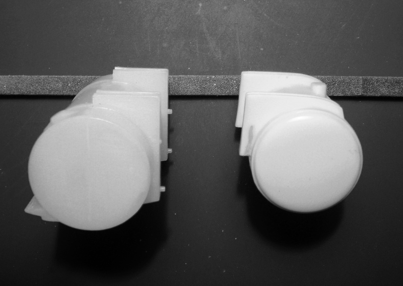

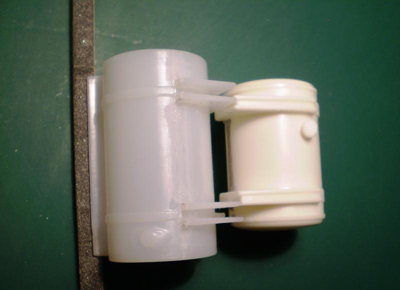

I spent some time thinking of the fuel tanks. The original length of the tanks is gone for good since Matchbox changed the tooling for their cabover 352. I was looking for a longer tanks in my parts box and I found some of a Kenworth. Different in size and style it would not match Peterbilt but I said, So what....?
One CA original and one of KW, changed a bit, could be paired on the same frame. But I needed the top, Peterbilt style brackets and I did not have them. What I did instead was that I glued one of the halfs upside down and the molded on brackets moved right on top where I needed them. A little bit of putty and sandpaper did the rest of work.
P4070247.thumb.jpg.659d47cc629f83956fb64
P4070240.thumb.jpg.1d5b89864edc66bf2a679
There is still some work to do on the tanks but I hope you got the idea.

Fantastic work and the windshield mods look good.

Once again you are raising the bar. Your attention to detail. And modeling skills are outstanding. I like the body work on the windshield! And you work on the interior..................... . Just too cool man!

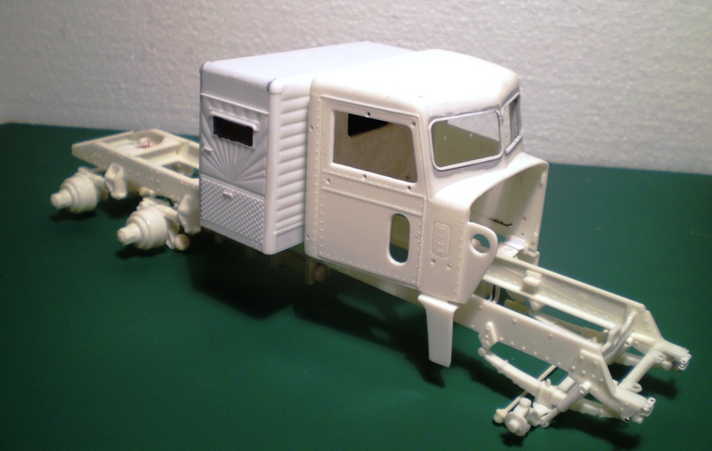

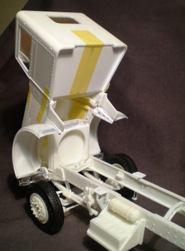

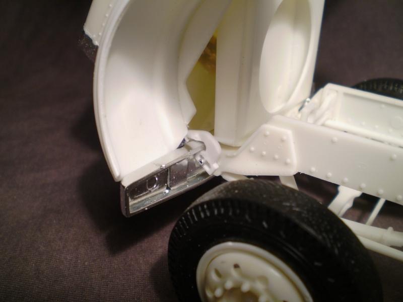

Thank you guys very much. When testing the cab position on the frame I always attach the hood. This way I can see how it works as a whole.
P4010147.thumb.jpg.74ac9807a1b37bc35dc51
P4010149.thumb.jpg.f098a441b9f3ea9ee6363

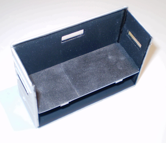

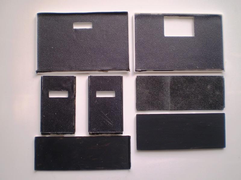

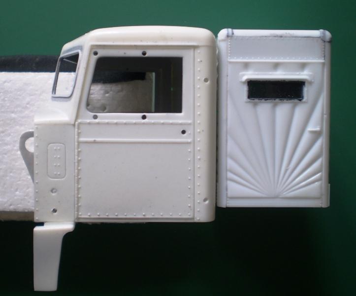

I got me Mecury sleeper and looked for for interior pictures. I found one with a black paneling inside and that got me to this idea. Originally a credit card cover this material was the right thing for covering the inside walls with.
P4130294.thumb.jpg.b71daedff8f6f247426c8
P4160300.thumb.jpg.143608f4be29fdeacd964

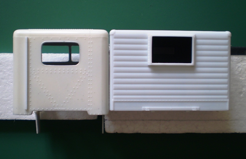

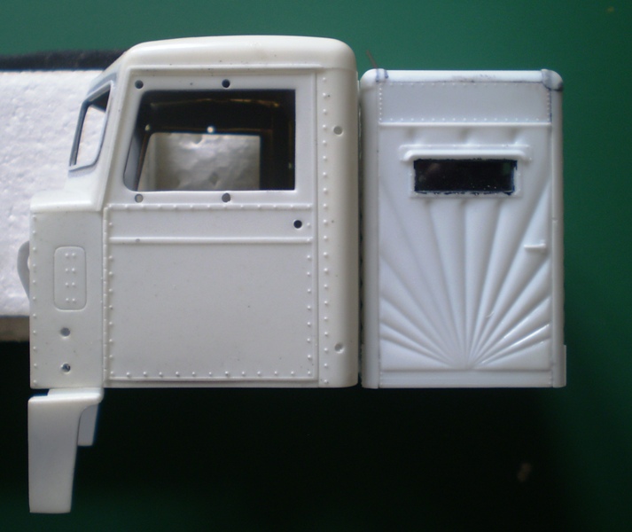

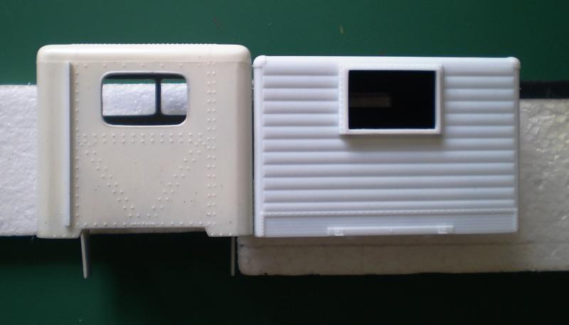

Maybe it does not look any special but I will not open any door and there will not be anything visible anyway. More impontant for me was to make a decision wether the sleeper should be in line with the cab floor or the cab roof. The sleeper is a bit smaller in height compared to the cab.
P4190326.thumb.jpg.397bd5ecce2ee8036ecdc
P4250327.thumb.jpg.c002531e17346f9837fbb
P4250329.thumb.jpg.783955d874162d2194ad9
P4250330.thumb.jpg.4d14f7812e38a45c20361
P4250332.thumb.jpg.0e9657c1c7db323c21288
In lower position the crawl-through tunnel fits perfectly to the cab rear window. In higher position it would take some modification. But I kinda like the higher position better. What do you think?

Nice build you have, personally I would line up up the roof

I agree, line up the top. That's what I did on the Pete I built with a Mercury box. Excellent idea of attaching the cab to the hood then close it. That way it lines up perfect, cab gets in the proper postion. Great work.
Share this post
Link to post
Fantastic work all the way around ! I would keep the sleeper level with the cab roof. Drop the crawl through down and fill the overhead space with a same size strip.
As for the bottom of the sleeper a strip of real thin styrene could replicate a aluminum strip that could house running lights or fuel tax permits.

The mods to the frame looks really good. I really like the smaller windshield that you changed. You are one of the few that does the bracing under the hood. I did the same on my pete, it may not be exact but it looks alot better that leaving it bare.

I agree with the others, it looks better if the top of the sleeper are the same hight as the top of the cab.

I agree...the higher position looks much better.
Share this post
Link to post
I agree as well.I like the higher position for the sleeper.

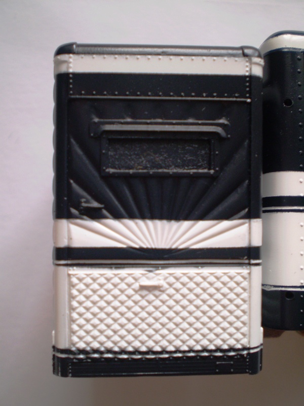

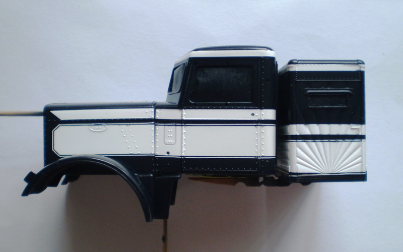

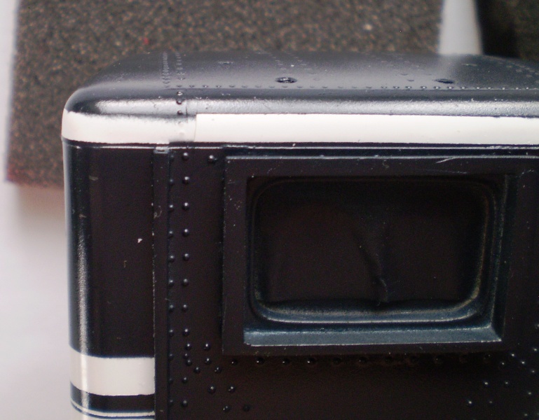

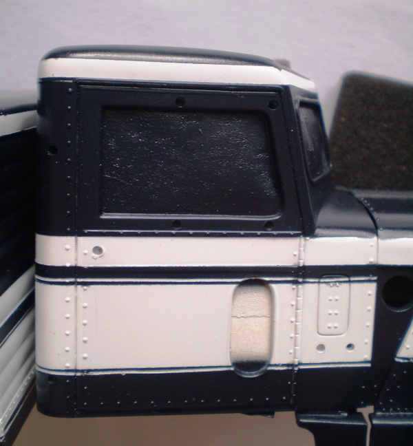

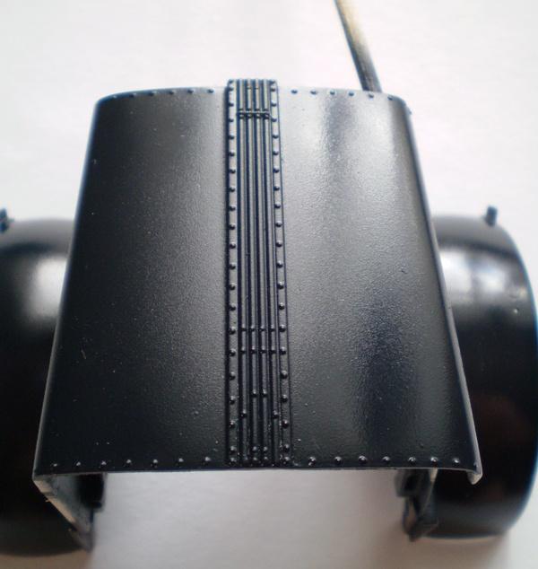

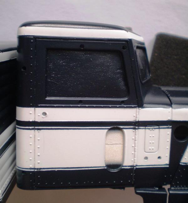

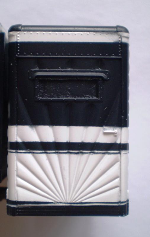

I have not posted here for a while because I was fighting the painting job. The skin of the cab / sleeper full of rivets, grooves and diamond pattern is not ideal for the paint scheme I chose. Masking over rivets and such is anything but wise. This is my second attempt in spraying the white and dark-dark blue combination. The surface is anything but smooth but I believe I can polish it with a fine paste. But first I have to repair all the imperfections.
P7200573.thumb.jpg.6d55958a5ea142e66ce61
P7200582.thumb.jpg.f9894455f1504b94bbacf
P7200580.thumb.jpg.3bee07017187e09ca7c45
P7200576.thumb.jpg.d9709e4c9e38945789043
P7200585.thumb.jpg.ed3914d5de4fe7f2d47f1
P7200588.thumb.jpg.b66935216040b83d66f0b
It is going to take a bit more time to finish the paint job. Be patient with me please.
