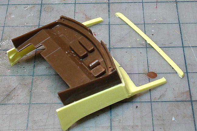

Harry P. Posted May 11, 2015 Author Share Posted May 11, 2015 At this point I glued the firewall to the cowl, because I need to temporarily put the cowl in place on the fenders in order to get the exact angle for the front edges of the front doors. The cowl alone didn't have enough area on the bottom to sit steady and flat on the fenders, so I glued the firewall to the cowl to give me more flat bottom edges to sit solidly on the fenders. I also removed the top of the windshield frame, the new roof will cover that. And I also reinforced the joint between cowl and firewall with square styrene rod for extra strength. Quote Link to comment Share on other sites More sharing options...

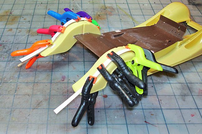

Harry P. Posted May 11, 2015 Author Share Posted May 11, 2015 The woodworking begins! You can't see it here under all the clamps, but there are pieces of 1/8" square basswood rods being formed to shape. The wood was soaked overnight to soften it and allow me to bend it around the fairly tight radius of the fenders without snapping. The strips of cardboard are there to protect the soft wet wood from clamp marks. Once these two pieces dry completely they will hold the shape and I can start building the body. BTW... I filled the holes in the fenders with sheet styrene. Those holes are for the stock taillights, which won't be used on the woody body. And besides, they would wind up being on the inside of the body walls, so I couldn't have used those stock taillight positions anyway... Quote Link to comment Share on other sites More sharing options...

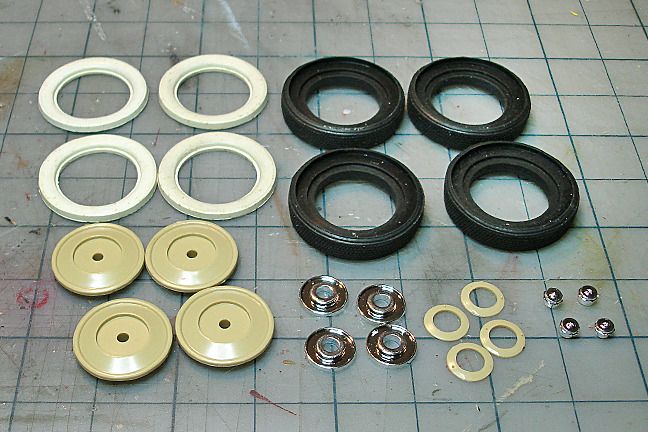

Harry P. Posted May 11, 2015 Author Share Posted May 11, 2015 While the wood is drying I'll jump around to other things. The Phantom III kit that I'm converting to a woody comes with spoked wheels, but I wanted full wheel covers. I got a set of covers from another RR kit I have lying around... When I eventually build this model, I'll just use the unused spoked wheels from the Phantom III. Here are the Phantom III tires and WW inserts with the Phantom II full wheel cover components. The covers fit the Phantom III tires perfectly... Quote Link to comment Share on other sites More sharing options...
sjordan2 Posted May 11, 2015 Share Posted May 11, 2015 (edited) Exactly my plan for putting wheel covers on the Phantom III. I've collected spare parts from the PII kit, and a couple of glue bombs. It took a couple of donors to accommodate the spare wheels. The lacing wire wheels from the Mercedes SS kit are also the same size, and look great on the PII. Not that the PIII wire wheels have any problems - they're pretty good for plastic. Edited May 11, 2015 by sjordan2 Quote Link to comment Share on other sites More sharing options...

Twokidsnosleep Posted May 11, 2015 Share Posted May 11, 2015 (edited) The woodworking begins! You can't see it here under all the clamps, but there are pieces of 1/8" square basswood rods being formed to shape. The wood was soaked overnight to soften it and allow me to bend it around the fairly tight radius of the fenders without snapping. The strips of cardboard are there to protect the soft wet wood from clamp marks. Once these two pieces dry completely they will hold the shape and I can start building the body. BTW... I filled the holes in the fenders with sheet styrene. Those holes are for the stock taillights, which won't be used on the woody body. And besides, they would wind up being on the inside of the body walls, so I couldn't have used those stock taillight positions anyway... The woodworker in me is loving this....bending wood and all. I have made some curvy things with gluing thin multi-laminations then put into a form...even more fun when you steam them first to really soften the fibres Watch out for spring-back after the clamps come off that might open up gaps. ? Maybe pin the wood through the fender for some mechanical hold?? Edited May 11, 2015 by Twokidsnosleep Quote Link to comment Share on other sites More sharing options...
sjordan2 Posted May 11, 2015 Share Posted May 11, 2015 The woodworker in me is loving this....bending wood and all. I have made some curvy things with gluing thin multi-laminations then put into a form...even more fun when you steam them first to really soften the fibres Watch out for spring-back after the clamps come off that might open up gaps. ? Maybe pin the wood through the fender for some mechanical hold?? Not to worry. Harry is a master at working with wood for ship models, antique aircraft frames, stagecoaches and riverboats, etc. Quote Link to comment Share on other sites More sharing options...

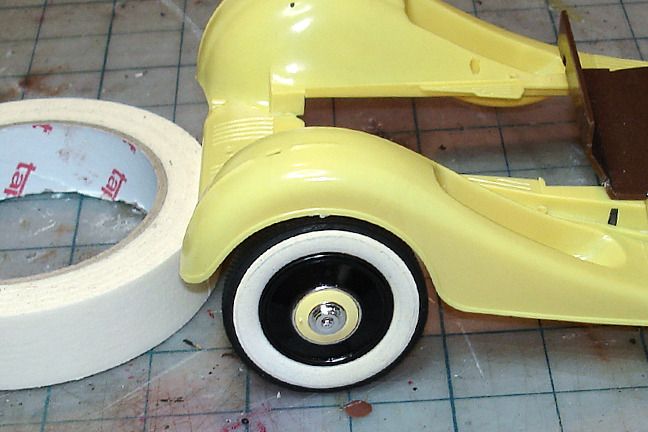

Harry P. Posted May 11, 2015 Author Share Posted May 11, 2015 Here is a sneak preview of what's to come. The yellow area of the wheel cover is painted... it's almost the exact same shade as the unpainted fenders: I think I've decided on yellow fenders (sorry, Skip... ). Well, maybe 90% sure. I do like the idea of the black running board tread area and black wheel covers contrasting with the yellow fenders, and I like the contrast between the pale yellow and the wood of the body. I can picture the car in my mind... it looks good. But maybe black fenders is the way to go. Hmmm... I'll have to think about this... Quote Link to comment Share on other sites More sharing options...
Harry P. Posted May 11, 2015 Author Share Posted May 11, 2015 The woodworker in me is loving this....bending wood and all. I have made some curvy things with gluing thin multi-laminations then put into a form...even more fun when you steam them first to really soften the fibres Watch out for spring-back after the clamps come off that might open up gaps. ? Maybe pin the wood through the fender for some mechanical hold?? I expect some springback once the clamps come off, but the basic shape will hold. I'll use CA to glue this piece to the fender surface, I don't see any problem forcing a thin piece like this to snug down to the fenders. I'll glue the front end first, let it dry, then use clamps to hold the rest in place as I flow CA into the joint from the inside. I don't see any problems. The good news is, these two pieces are the only ones that need serious bending, everything else will be pretty much straight pieces... unless I decide to put an arc into the roofline from front to back. I'm still debating a curved roofline vs. a straight shot. I like the look of a curved roofline, but I also like the simplicity of a straight line. Not to mention how much easier it would be to make it straight rather than arced! Quote Link to comment Share on other sites More sharing options...
