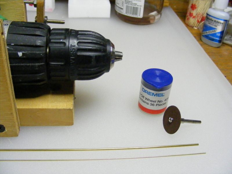

Making the guide. I used brass tubing, 1/32” and 1/64” inside diameter. With the help of a variable-speed drill and Dremel cut-off wheels, I cut a 1/2" length from each size. Make sure the lengths are equal! It is important to keep the length of the guide short; otherwise, a longer portion of the drill bit is exposed which increases the chances of breaking the bit.

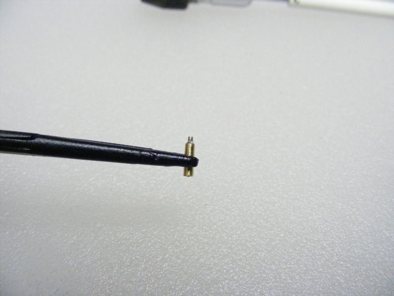

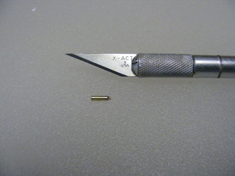

I then inserted the 1/64” into the 1/32” tubing, with just a hint of the 1/64” protruding and soldered the two pieces together. The protruding 1/64” tubing will cause a small cup at the other end of the guide, thus the 1/32” tubing will be used to fit over the distributor nipple.

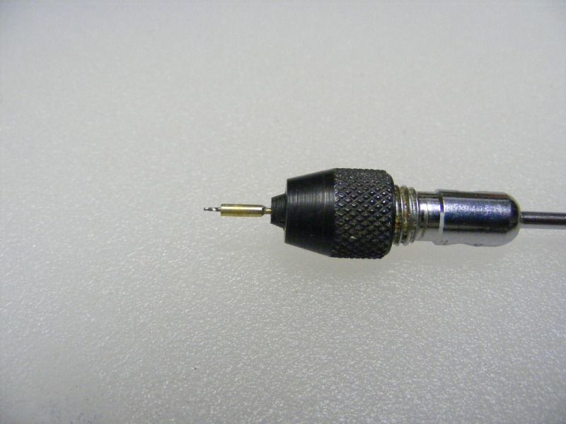

Next, I put a #78 (or so) bit in my pin vise and, using the guide for reference, set the depth of the hole.

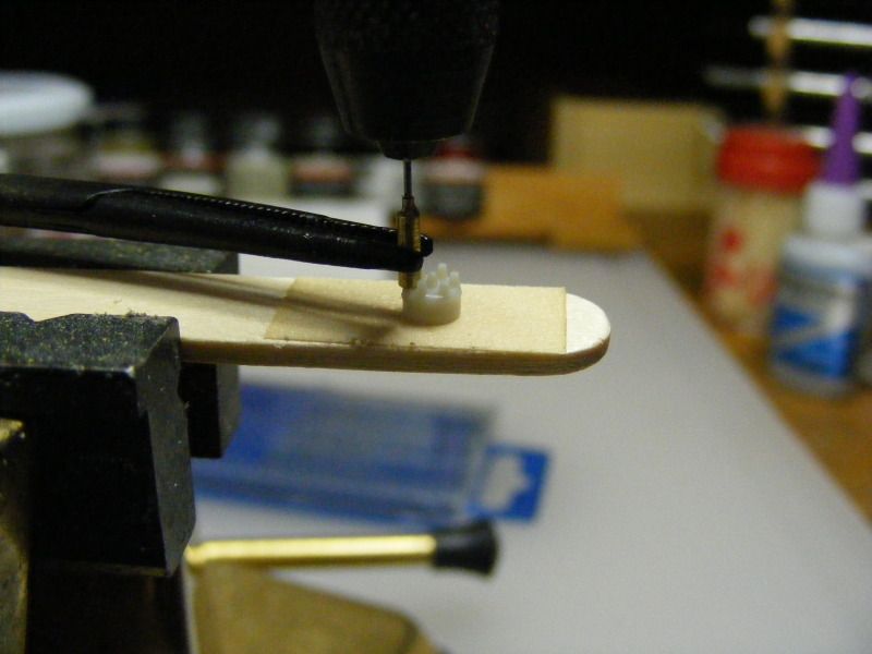

Using the guide. I prefer medical tools (such as hemostats) to hold the guide, since they have the ability to lock. Make sure your holding device has “teeth” that grasp the guide, otherwise the dreaded “Ping, I wonder where it went” syndrome will rear its ugly head and you’ll need to make another guide. Needle nose pliers, with strong rubber bands around the handles, will also work.
I used double-sided masking tape (as used in putting new grips on golf clubs) A LOT! In this case, the tape is placed on a popsicle stick and the stick is locked in a small, vacuum-base vise. The distributor cap is then placed on the tape. Since one hand will be holding the hemostat and the other hand will be operating the drill, stability of the distributor cap is very important! Place the 1/32” end of the guide, insert the drill, and drill away. Remember, we’ve already set the depth of the hole in a previous step.

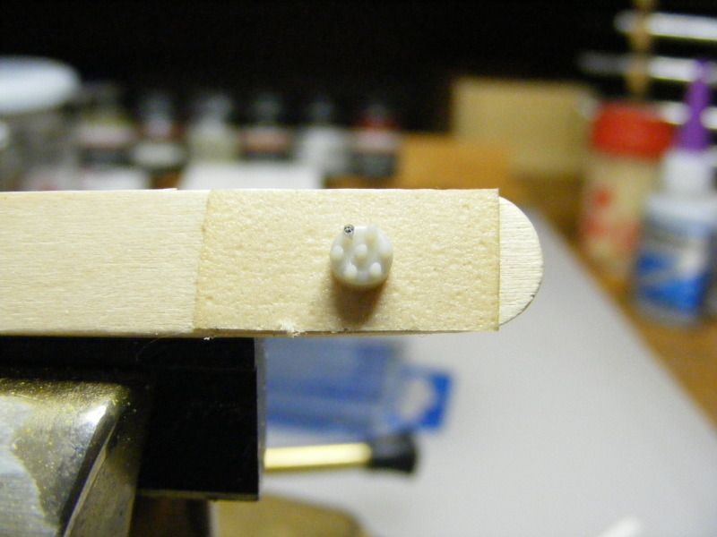

For photographic purposes, I darkened the hole with a lead pencil. As you can see, the hole is centered and is of the desired depth.
While this might not be everybody’s cup of tea, it certainly works well for me. If you find the #78 drill is too small, use it anyway, then graduate to a larger drill. The previously-drilled #78 hole will act as a guide for the larger bit and maintain centering.
