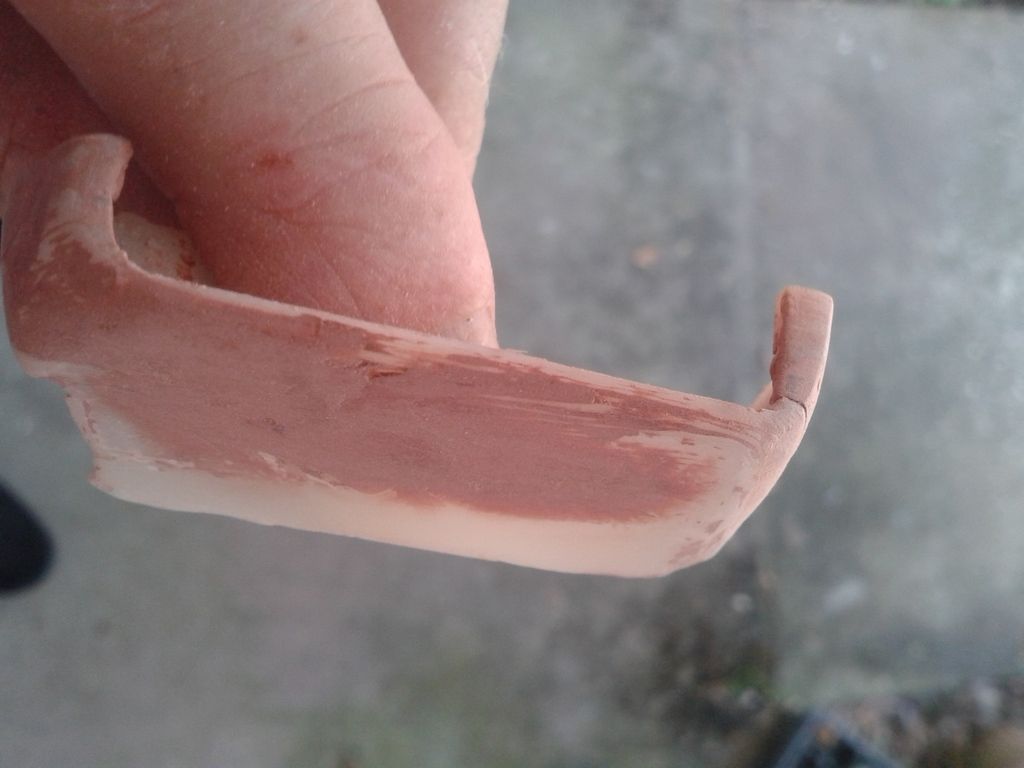

So, I've got a rough sided piece of styrene plastic that I want to get into the shape of a radiator coweling. After approximately 25 minute of sanding off of the support material, I still have to continue to do body w20150517_122519_zpsgfn98iog.jpg
One coat of Bondo is added and left to set up. Than sanded.
After two more light applications, I have one half of the part done.

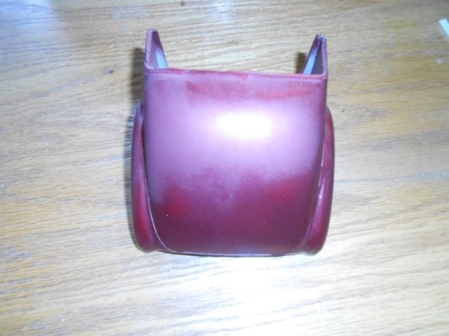

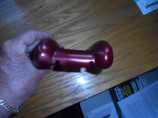

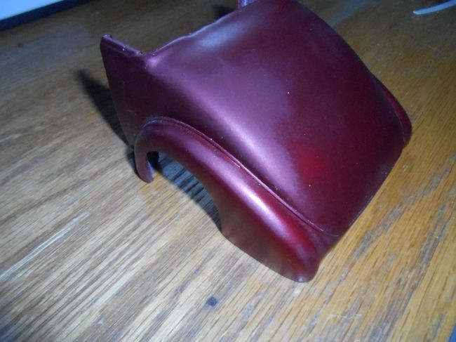

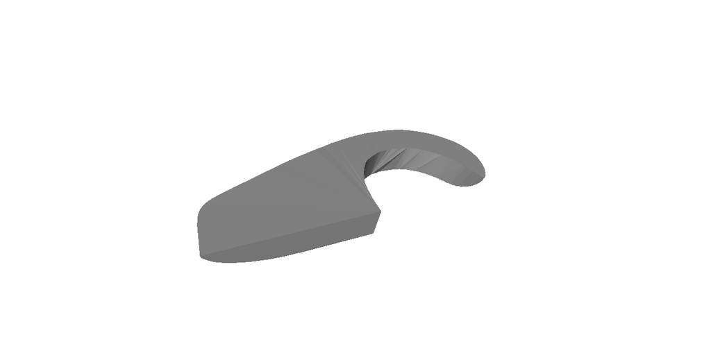

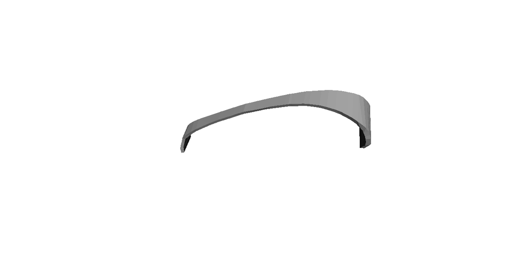

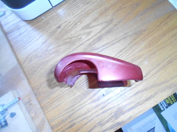

As I mentioned in my first post here, I attempted to scratch build this car in a coupe. I was stopped dead when I couldn't get the front fenders to even come close to looking the same. 3d printing fixed that. Here are the front fenders. Note that they are in 3 parts and solid. That's the way I could get the most accurate print. I used a motor tool to hollow them out and then ca glued them together.
The outer part of the drivers side fender.
Link to comment

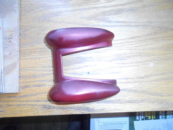

The stl. files are mirrored and the process is repeated. Next, they go thru the same finishing process shown in an above post. A center connecting piece is then created and the fenders assembled.
The final product:
Link to comment

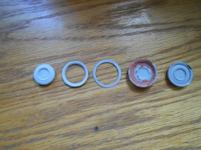

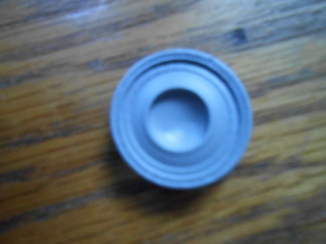

I don't know how many more parts I have to print to complete this project. I say that because its always changing. Here is an example. The first pic is the wheel printed on the fdm printer. There are three pieces so there are three prints required to get the best result. then of coarse, you have to do the surface smoothing. The second pic is the same wheel printed on the high def dlp printer. What you see is exactly as it came from the printer except that I put a light coat of primer on to make it visible for detail.

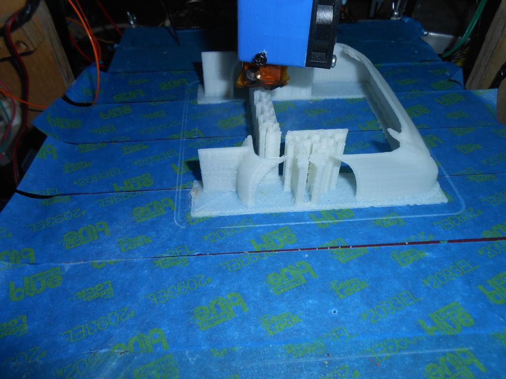

DSCN2037_zpsjzl9ukad.jpgDSCN2038_zpsqgurah32.jpgThe body is made up of 3 sections. I'll start with the rear from the door jams back. The first time I printed it, it was made from five separate prints and the rear fenders were separate. Then, the slicing software was upgraded and the support improved so that it could easily be done in one print. These are some print in process.
