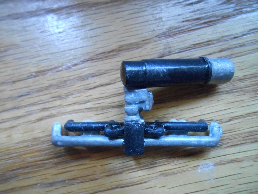

Here's the intake & exhaust manifolds with the carb and air cleaner. I'll hold off attaching them to the engine until later as I have to handle the engine quite a bit before final assembly. I received the new resin on Friday and have been printing out new front suspension pieces which I will assemble next. It appears to be stronger than that which I was using.

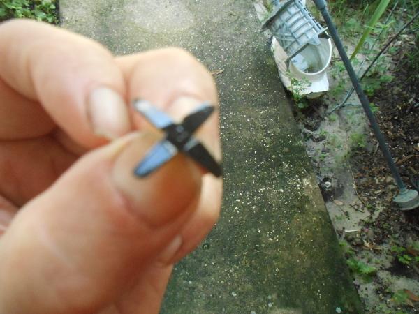

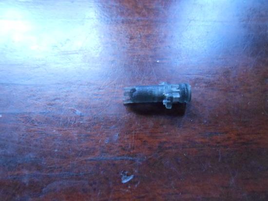

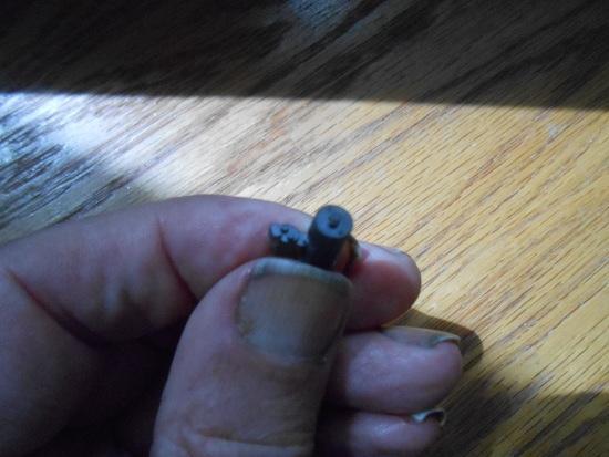

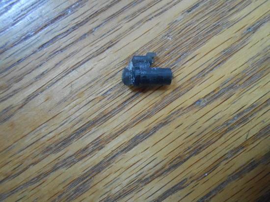

  • Small update. I got the front crank shaft pulley, starter motor and generator drawn up and printed, but unfortunately, the daily thunder storm rolled in soon after I printed the generator and I couldn't get the sun cure on it.  Here's the starter.
  • DSCN0191.thumb.JPG.c7620c9a601942c53eb61DSCN0196.thumb.JPG.e59072d9feed5188c6764DSCN0192.thumb.JPG.d1b30d629df0b35832b92

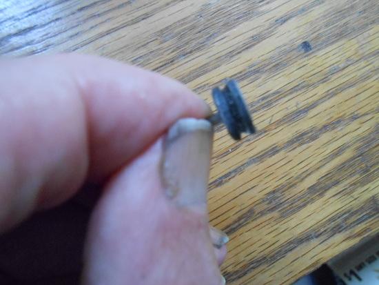

Here's the pulley.
DSCN0194.thumb.JPG.d2e3527eecfe03cbb032cDSCN0193.thumb.JPG.3ab70e2aecce66dbf34ca

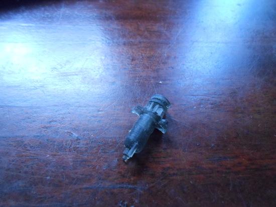

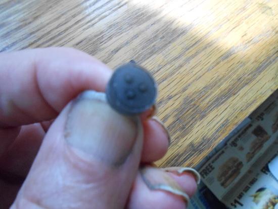

Got the generator done, but it's been raining all day so it's not sun cured yet. It's printed in 2 pieces that can be printed at the same time. Some of the supports are still attached on the one end. I have to wait until the sun cure to make it hard enough to trim any closer. You can see the fan fins on the end were the pulley attaches. Just another example of the kind of print that can be expected from these machines.
DSCN0218.thumb.JPG.a98f2134cd4db9591e03aDSCN0219.thumb.JPG.525cd8cc0bf887644af06DSCN0222.thumb.JPG.f6bac6cc94eb05585240aDSCN0223.thumb.JPG.8cd87cc8322b013edb242

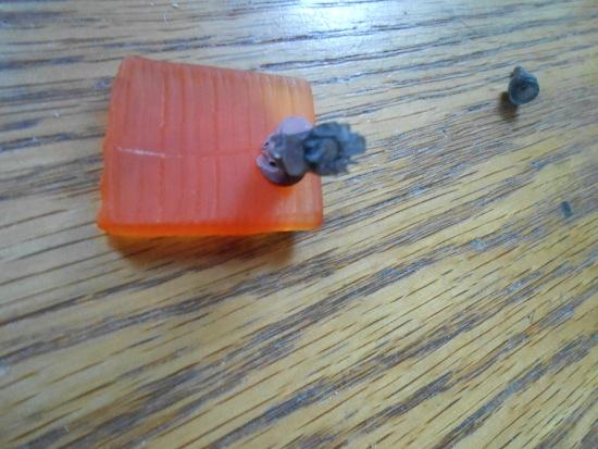

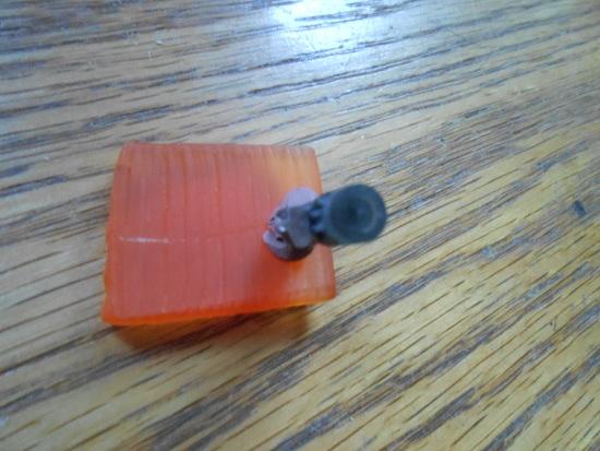

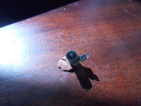

I drew up the cooling fan and printed it out. Unfortunately my camera refused to give me a good focus. You can barely make out the bolt heads.
DSCN0307.thumb.JPG.715d4d31ed9530a3fc005

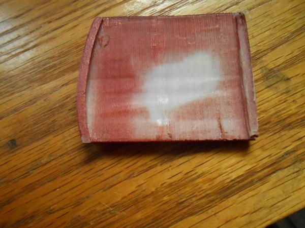

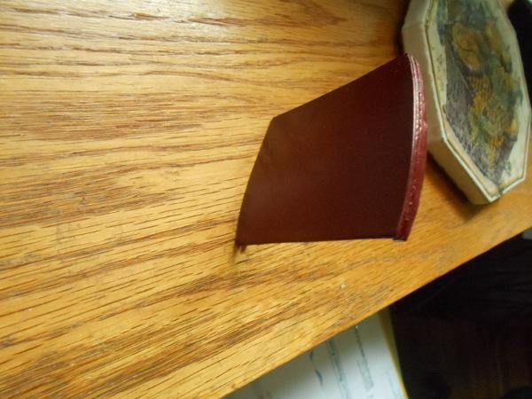

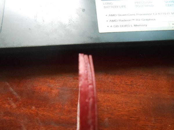

The doors have been done for about a year. I wanted to show you how important it is to know what you printer can do and to learn the best position to get the best print you can. The inner skin was printed streight up on the build platform of the fdm printer in the same position as these pictures. They are 1/16th thick and and 2 1/2 inches high. The outer skin and door jambs were added later.
DSCN0309.thumb.JPG.6fb94485d4605d7184ccfDSCN0308.thumb.JPG.881c04f41dbea1d3c224aDSCN0310.thumb.JPG.4566cf81245119039a6d9

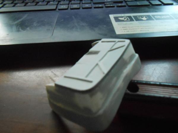

Currently, I am working on the firewall. It was printed on the high def sla dlp printer after I created the file.
DSCN0311.thumb.JPG.f33dd8eaa81c9d5dc06de
