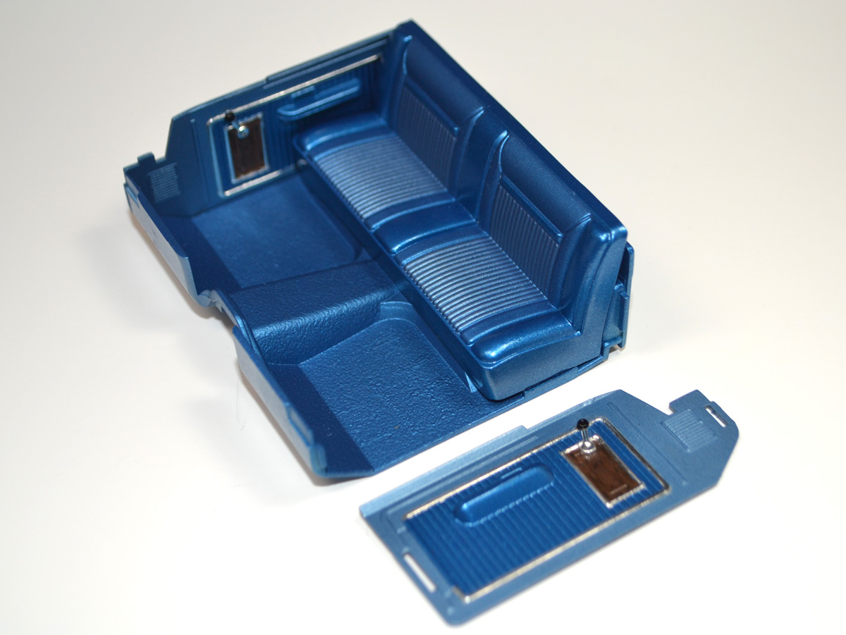

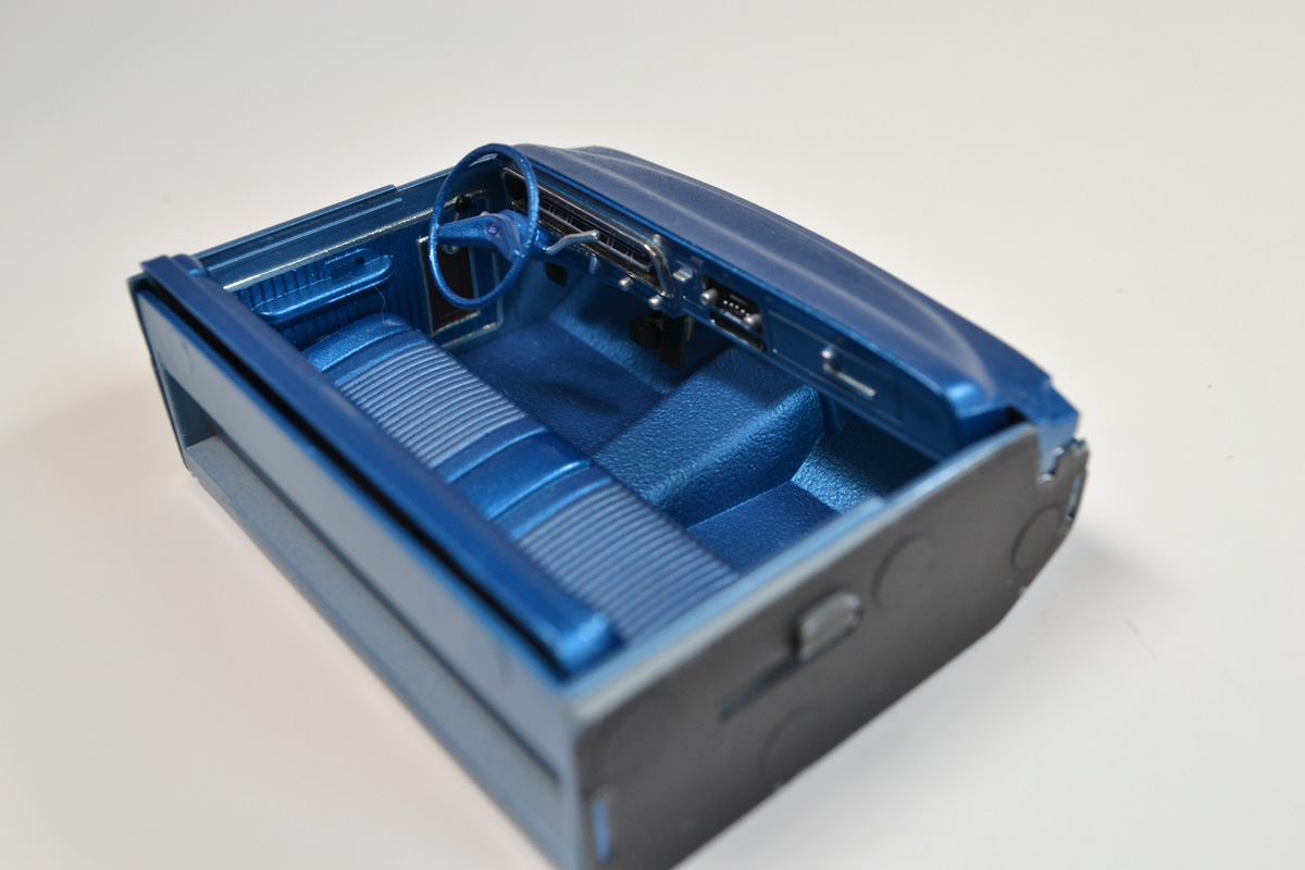

A quick update while I'm waiting for a dry day to paint the body, I decided to do some of the interior detailing.
The wood grain insert was painted by hand using a base of dark brown paint and some black dry brushing. Not perfect but close enough for me. There was no need to foil the rear edge of the door trim panel as it's completely hidden by the seat back. I'm going to move on to the dash details if it doesn't clear up soon !
-Steve
Link to comment

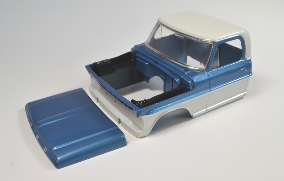

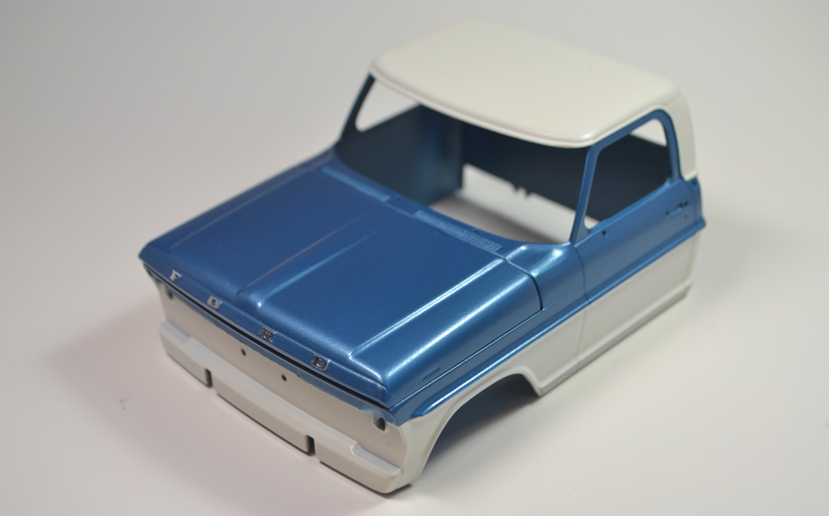

I finally got this puppy painted ..... first the weather wouldn't cooperate, then my airbrush started spitting whenever I hit the trigger. I ended up ordering a seal kit from my hobby shop and bought a back up airbrush while I was waiting.
The colors are Pure White over Winter Blue. I sprayed the inside of the cab along with the bed underside Blue first, then I masked off all the inside and underside areas. I pre-foiled the hood nameplate and shot all the exterior body parts White. I let that dry a couple of days, then I masked off all the areas that needed to stay White. I then sprayed all the Blue areas. The hood was taped in place for the last two coats to be sure of a perfect metallic color match.
To expose the foiled nameplate I dipped a toothpick in thinner and gently rubbed the paint off of them working very slowly one letter at a time. I think the results are better then trying to foil nameplates cleanly after paint and way cheaper then photo etched scripts.
The lacquer paint raised the tail gate lettering I had sanded off, so I re-sanded it flat again once the paint dried. The tailgate decal will cover it up no problem.
So far I'm very pleased with how it coming out. My only disappointed is I missed two small sink marks on the roof from the visor pins. Since the roof is white it's hardly noticeable, but I'll be sure to catch it on my next buildup.
In a couple of day I will add the foil trim to the body parts and the clear coat everything with my favorite PPG DCA 468 Clear Lacquer. I'll let that dry about a week and then it will be ready for polishing and final assembly.
-Steve
Edited by SteveG
Link to comment

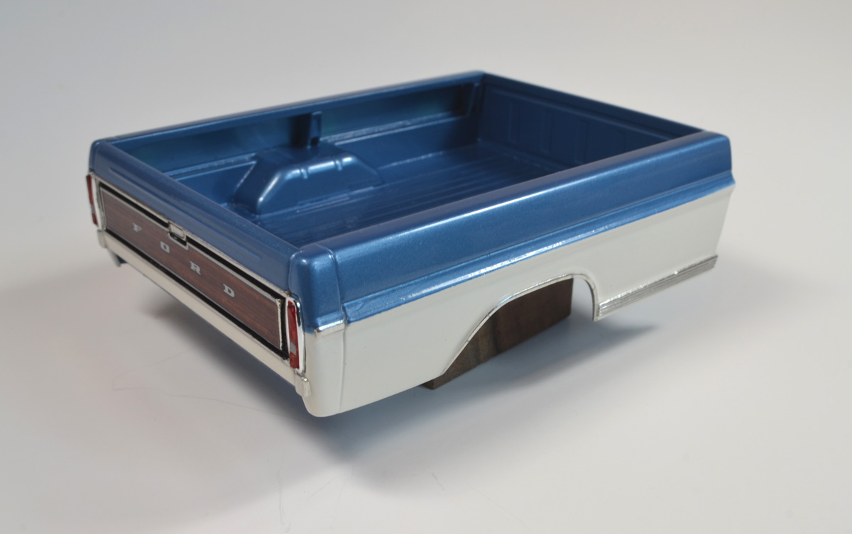

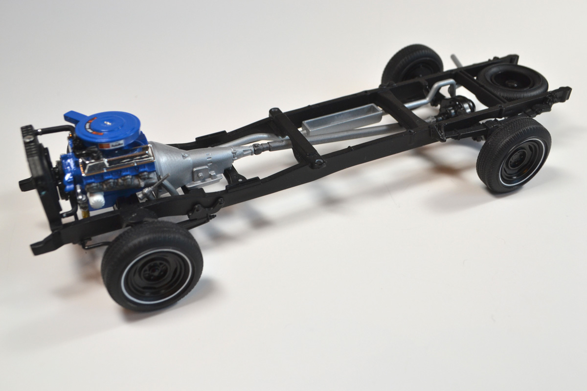

Almost to the home stretch,  here's the chassis only needing the wheel covers to finish.
The interior is completed and ready to install ....

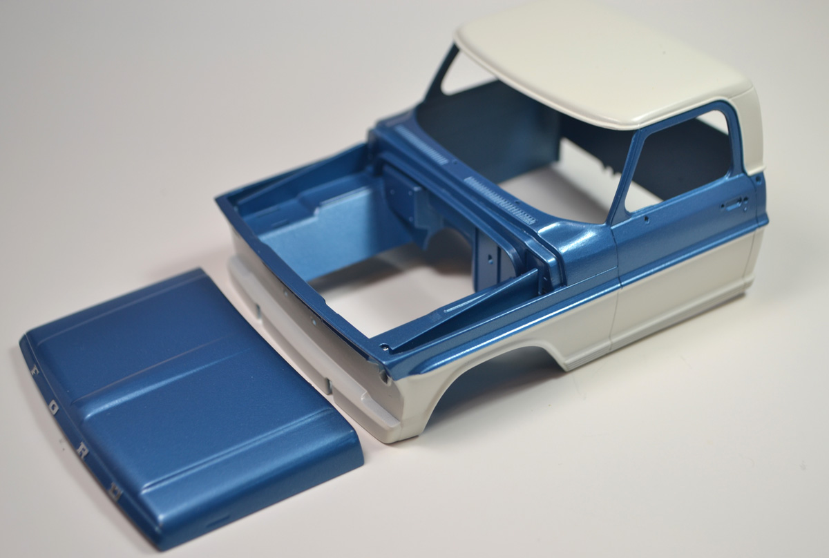

Here's the body parts foiled and clear coated ........
After polishing and with the glass installed.  I had to repaint the roof as I polished through the first time .....

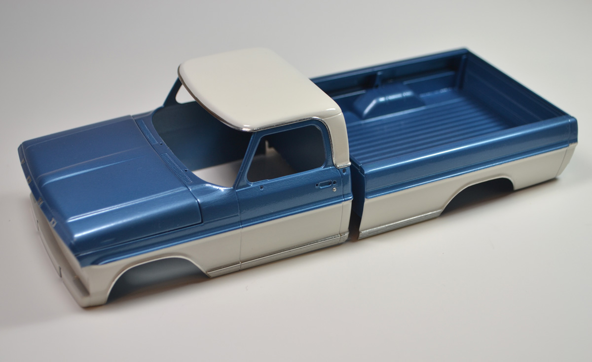

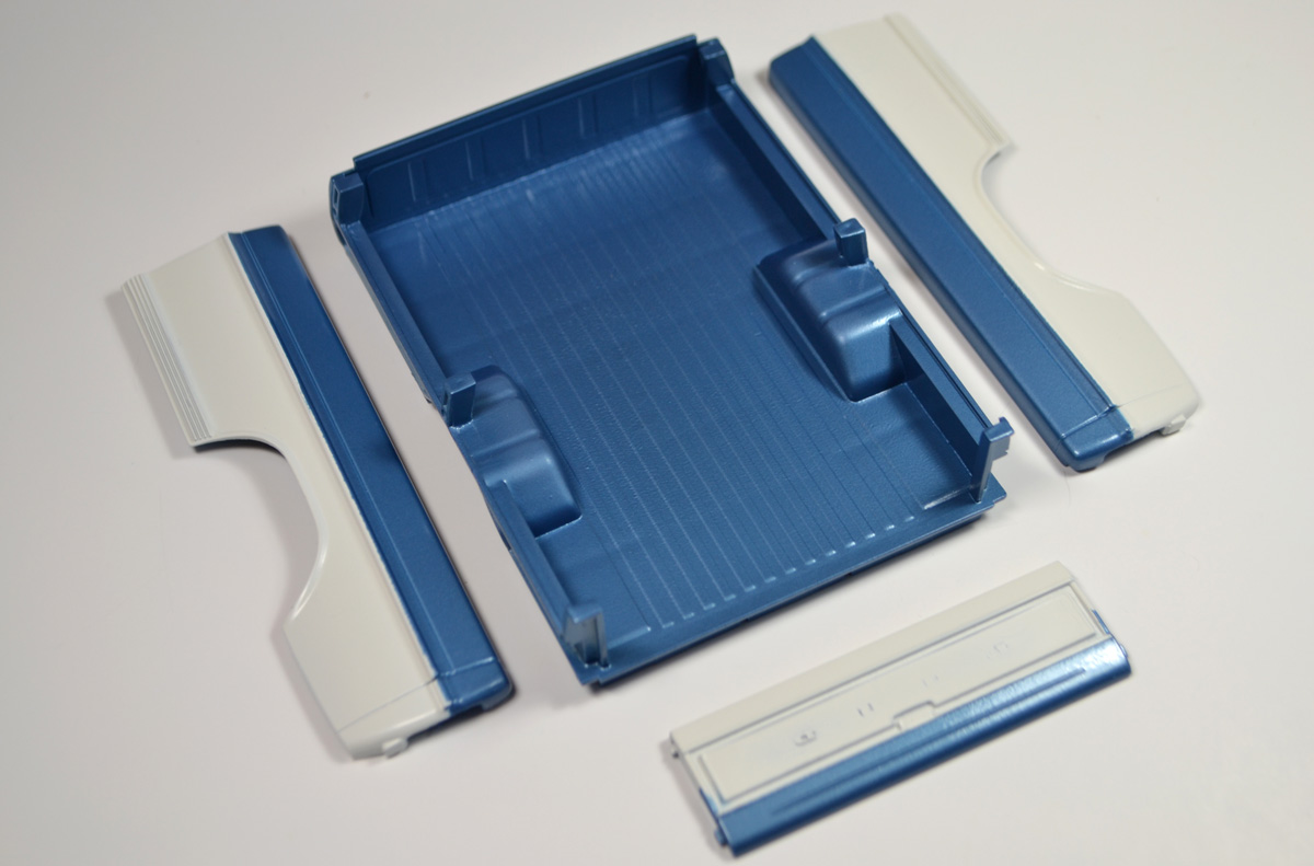

And finally the bed is completed other then the side trim and painting the reflectors.
Next time I'll start on the final assembly.
-Steve
