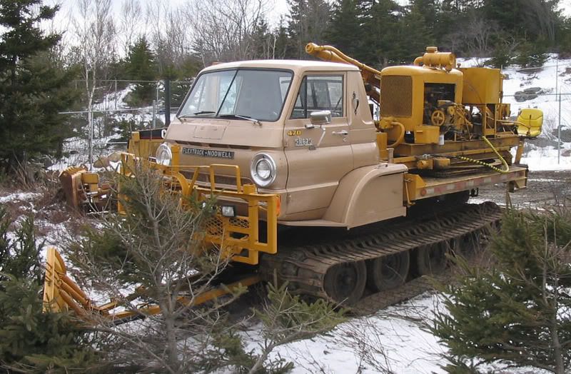

landman Posted June 29, 2015 Author Share Posted June 29, 2015 (edited) Your mini reminds me of a type of vehicle I often thought I should build: Edited December 21, 2020 by landman Quote Link to comment Share on other sites More sharing options...

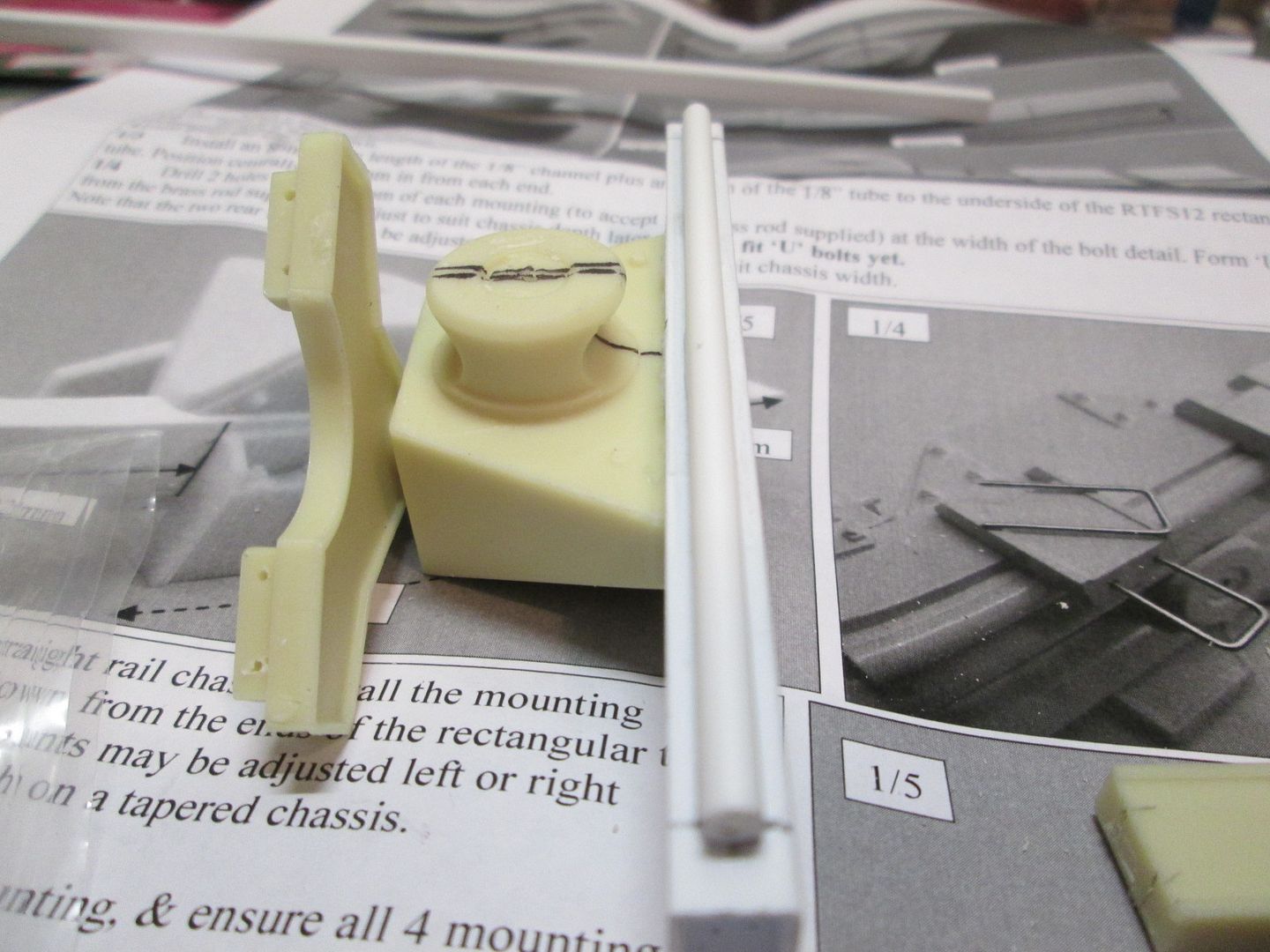

landman Posted July 3, 2015 Author Share Posted July 3, 2015 (edited) Made up the U-bolts for the mounting blocks. Positioned the base on the frame to make sure there will be a spot for everything without interference. Right behind the front springs' rear mount looks like it will work. Added the swing cylinders. Tried out my new PE scissors. They are more than worth the expense. Installed the outrigger locking levers. Installed the valve block & lever banks after drilling for the hoses. Started on the outriggers. Â This kit is very detailed and an absolute delight to build. Edited December 21, 2020 by landman Quote Link to comment Share on other sites More sharing options...
