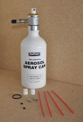

aurfalien Posted July 9, 2015 Share Posted July 9, 2015 (edited) Hi, Unsure what section to post this under so apologies to the moderators in advance. Has any one tried this in a paint/primer/etc application? The image is sorta for junk but its a "TruePower Refillable Aerosol Bottle". It can take 90PSI and has a few diff nozzles for fine mist etc... Edited July 9, 2015 by aurfalien Quote Link to comment Share on other sites More sharing options...
mrknowetall Posted July 9, 2015 Share Posted July 9, 2015 The description from Amazon:Multipurpose reusable refillable aerosol spray bottle can spray water, thin oils, household cleaners, penetrants, solvents, etc.• Air pressure up to 90psi using air compressor or bicycle tire pump through the built-in air inlet valve stem.• 16 fluid oz bottle can hold up to 8 fluid oz Maximum liquid contents for spraying.• 3 spray tips sizes, 4 extension tubes, 2 replacement valve cores and O-rings included• NOT for use as a pressurized air duster or with paints/primers.Note that it's not intended for use with paints. Quote Link to comment Share on other sites More sharing options...

mrknowetall Posted July 9, 2015 Share Posted July 9, 2015 I'd guess nowhere near 90 PSI. You'd need to adapt a regulator to that reusable can in an effort reduce the PSI to about 20-30. Quote Link to comment Share on other sites More sharing options...

b-body fan Posted July 9, 2015 Share Posted July 9, 2015 You could use an air chuck with a gauge, or just put a little in at a time and check it with a tire pressure gauge. I think the no paint or primer is because the solvents would eat the plastic dip tube. You could probably shoot acrylics with no problem. Just make sure you let all the pressure out before running cleaner through it. Quote Link to comment Share on other sites More sharing options...

Longbox55 Posted July 9, 2015 Share Posted July 9, 2015 You could use an air chuck with a gauge, or just put a little in at a time and check it with a tire pressure gauge. I think the no paint or primer is because the solvents would eat the plastic dip tube. You could probably shoot acrylics with no problem. Just make sure you let all the pressure out before running cleaner through it. I don't think solvents would be the issue. I've seen similar sprayers, even used one once, they're made to be used with brake and carburetor cleaners, which are very hot solvents. some of the ingredients in those are the same as what's in plastic cements. I would be more inclined to think the problem with using paints in them would be a clogging issue from the solids that are in the paint. Quote Link to comment Share on other sites More sharing options...
b-body fan Posted July 9, 2015 Share Posted July 9, 2015 I don't think solvents would be the issue. I've seen similar sprayers, even used one once, they're made to be used with brake and carburetor cleaners, which are very hot solvents. some of the ingredients in those are the same as what's in plastic cements. I would be more inclined to think the problem with using paints in them would be a clogging issue from the solids that are in the paint. Good point. Cleaning it may be a pain. Discharge, empty, add cleaner, blow through, discharge, etc. Quote Link to comment Share on other sites More sharing options...
Scale-Master Posted July 9, 2015 Share Posted July 9, 2015 I bought one many years ago, I still have it and rarely use it. I tried all the different nozzles and found it doesn't work very well for paint at all.Even when charged fully it doesn't spray for long as the material is depleted so is the pressure. So to empty the canister it needs to be recharged with more air pressure a couple times.The spray pattern and volume changes quite a bit and quickly.The best use I've found for it is for spraying cleaning chemicals/solvents. But even then it is a hassle to fill, charge, recharge & clean. Quote Link to comment Share on other sites More sharing options...

Longbox55 Posted July 10, 2015 Share Posted July 10, 2015 I find it amusing that the fellow who made that video is telling people that you can use for things it clearly says not to use it for. Quote Link to comment Share on other sites More sharing options...

Longbox55 Posted July 12, 2015 Share Posted July 12, 2015 If you're still looking onto getting one, go to Menard's. They have them for about $9. Much better that the $20-$25 on Amazon. I picked up one today, haven't tried it yet. Other than the the nozzles, it's pretty much the same as the refillable sprayers that shops use for brake/carb cleaners. Quote Link to comment Share on other sites More sharing options...
