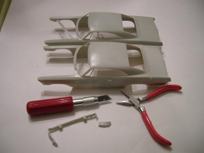

As others have stated, the '65 Pontiac Catalina series was considerably shorter than the Bonneville, and on a shorter wheelbase:
Catalina 2+2 -- Overall length 217.6", wheelbase 121" (for all intents and purposes, 6" shorter than the Bonneville, wheelbase is 3" shorter than a Bonneville.)
Bonneville -- Overall length 221.7", wheelbase 124"
The front clips and body structures are identical, the difference in length is all in the truck, from the leading edge of the trunklid rearward.
I did the AAM Catalina 2+2 conversion on my own. I shortened the trunk 6 scale inches (.240" or 6mm, you can take your choice there, as the difference in metric and english measure isn't much more than the thickness of a razor saw cut!), cutting the rear of the car across just behind the rear wheel arches, and then cut each wheel arch away from the quarter panels as a rectangular piece, setting that aside. I then cut the necessary .240" section from the forward portion of the first saw cut.
Next, I lengthened the rectangular opening where the wheel arch/fender skirt portions were removed, forward by .120", which is 3" in 1/25 scale. I did cut a filler section from a second AMT 2+2 body shell, at the same point of the rearmost vertical cut I made when removing the wheel arch sections, for use as a filler panel to close in the gap after the kit body was glued back together.
Once the rear deck was back in place, now correctly shortened, I dressed down the part of that shape with some flat file work (carefully so as not to damage the trailing edge of that pseudo-fastback roof which came very close to correcting the area to the proper slope (Thank Heaven for those old, thick 3in1 Annual Series model car body shells!), only a slight bit of putty and block-sanding was required to finish this area, along with the tops of the rear quarters. Last, I made the needed "patch panels" cut from the second body, which put those in the correct position for a Catalina, added the necessary patch panels to the rear of this work--take care to make certain that the prominent "character line" on the body sides, and patch panel line up though! As I used gap-filling CA glue to join all the pieces back together only minimal putty was needed.
The toughest part of the whole thing would be the taillight panel, as the taillights on a Catalina are much shorter, side-to-side than those of the Bonneville, meaning I used the corresponding fluted panel from each kit to stretch that panel to its longer dimension. A friend of mine managed to create PONTIAC raised lettering and glued those letters in place on that panel. Other than that, shortening the taillight lenses was the simplest part of the whole thing. ( have NO idea whatsoever as to where he found the letters to spell out P-O-N-T-I-A-C though!)
The last thing I did was to "correct" the offending left side rear quarter window area, to at least make it match the right side, which to my eyes is pretty close to correct (the left side has too much of a "curved arc" to it).
When it was all done, I was more than happy to see that the reworked body fit to the Grand Prix chassis like a glove!
Hope this helps!
