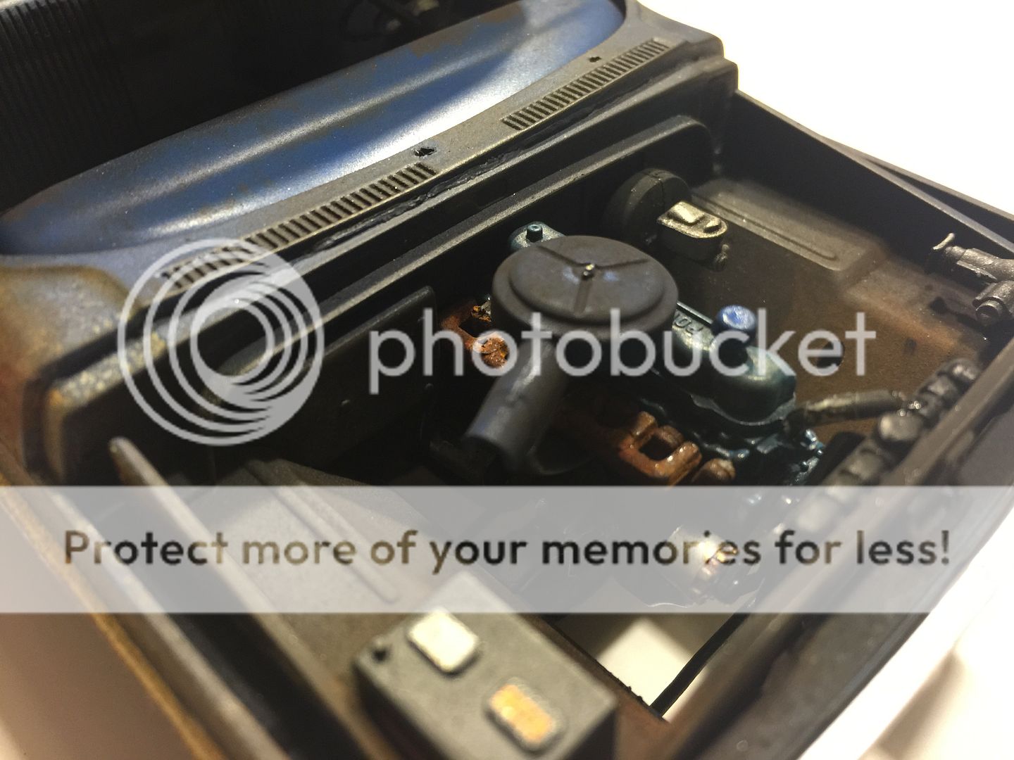

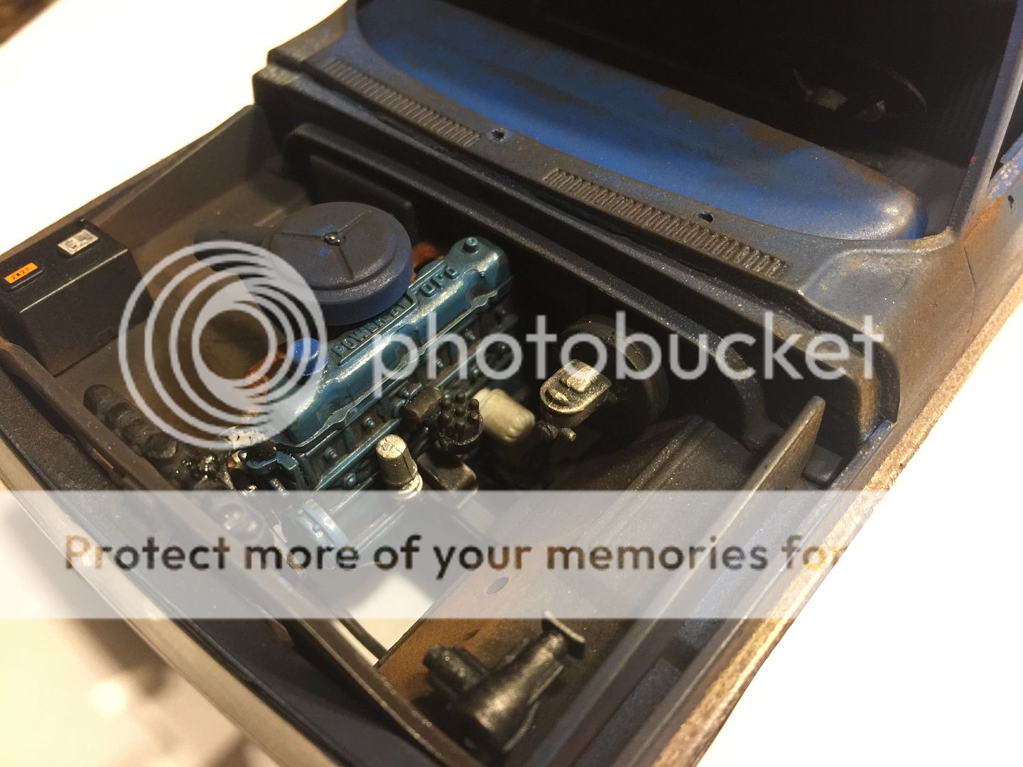

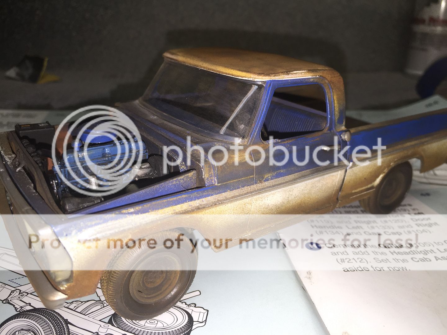

lanesteele240 Posted July 15, 2015 Share Posted July 15, 2015 (edited) Nice kit but it moebious is pulling a fast one The bottom of the doors/bed and cab have trim added and is not like the truck in the pic.(the ranger has this trim) But the kit does have the trim. It would take a lot of work to make the kit look like the box art. Which is correct. The kit or the box art. Another issue i came across is was the engine was crooked when using the location holes provided. It may have been something i did. I just deleted the one on the tranny and filled the hole with ca glue. And just unexplainable is the floating alternator. It is 2015. Kits should not be allowed that have floating alternators Where are the hood hinges? Decals for the battery/oil filter/shocks? I was a little let down that they missed the small things that should be supplied in a kit. But the kit falls together. That part is very awesome. I only have the glass to go. Lets hope it falls in line as well. Now that im finished kit bashing, haha, i made a funny, lets build!!!!!! Edited July 15, 2015 by lanesteele240 Quote Link to comment Share on other sites More sharing options...

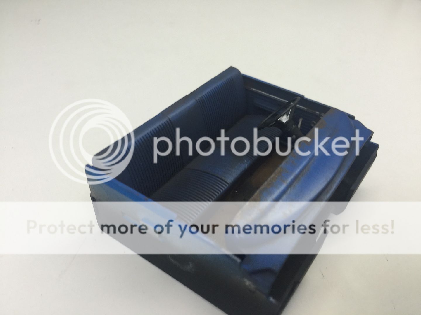

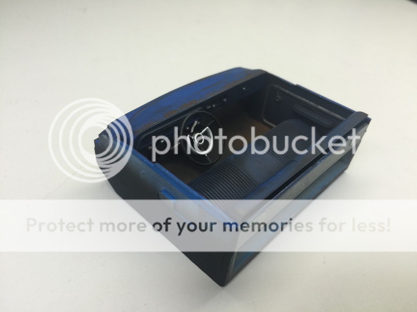

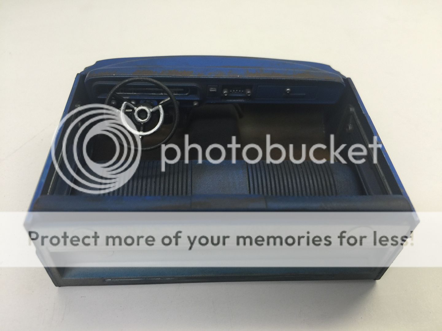

Custom Mike Posted July 15, 2015 Share Posted July 15, 2015 Nice start Gary, how'd you get the interior so grimy looking? Quote Link to comment Share on other sites More sharing options...

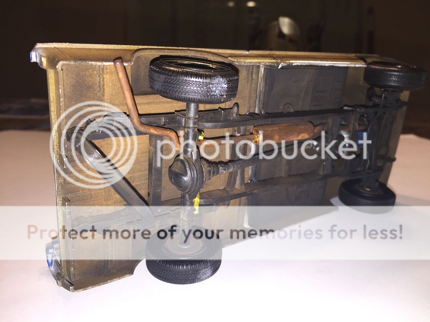

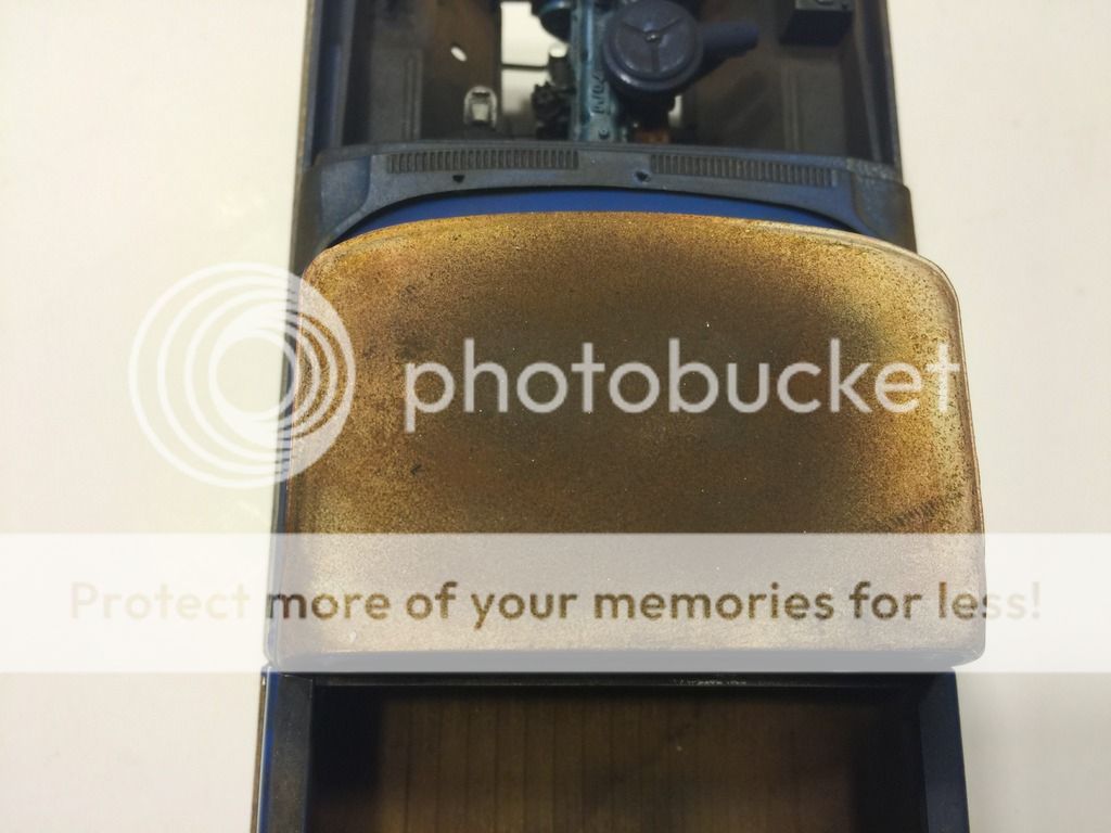

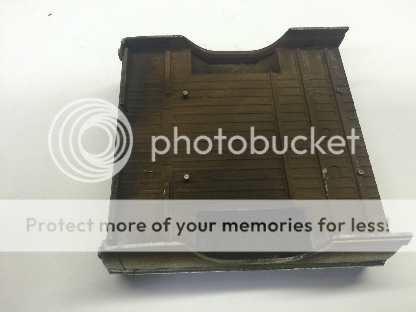

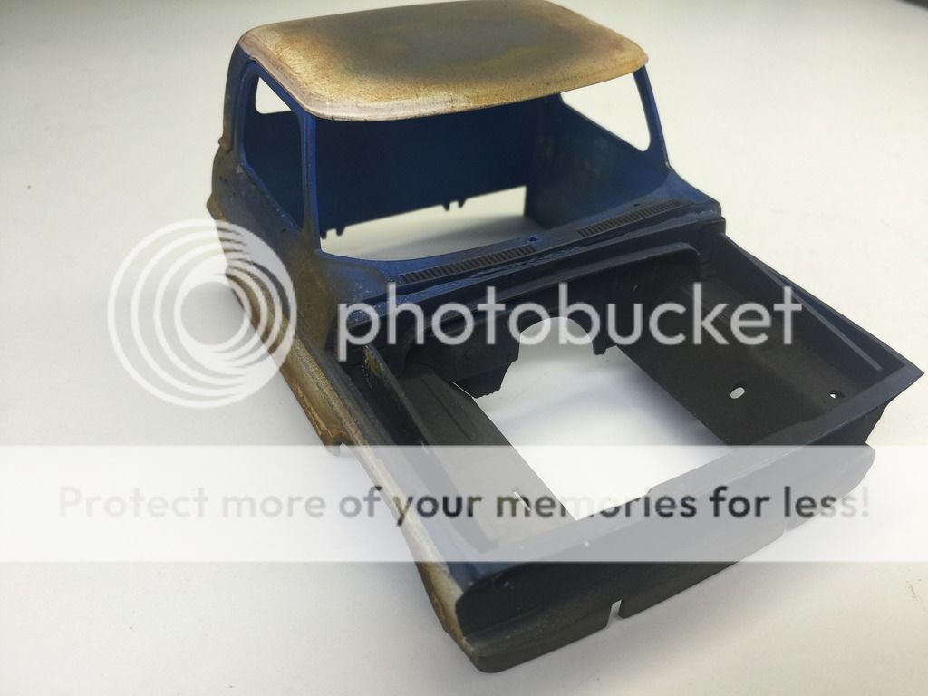

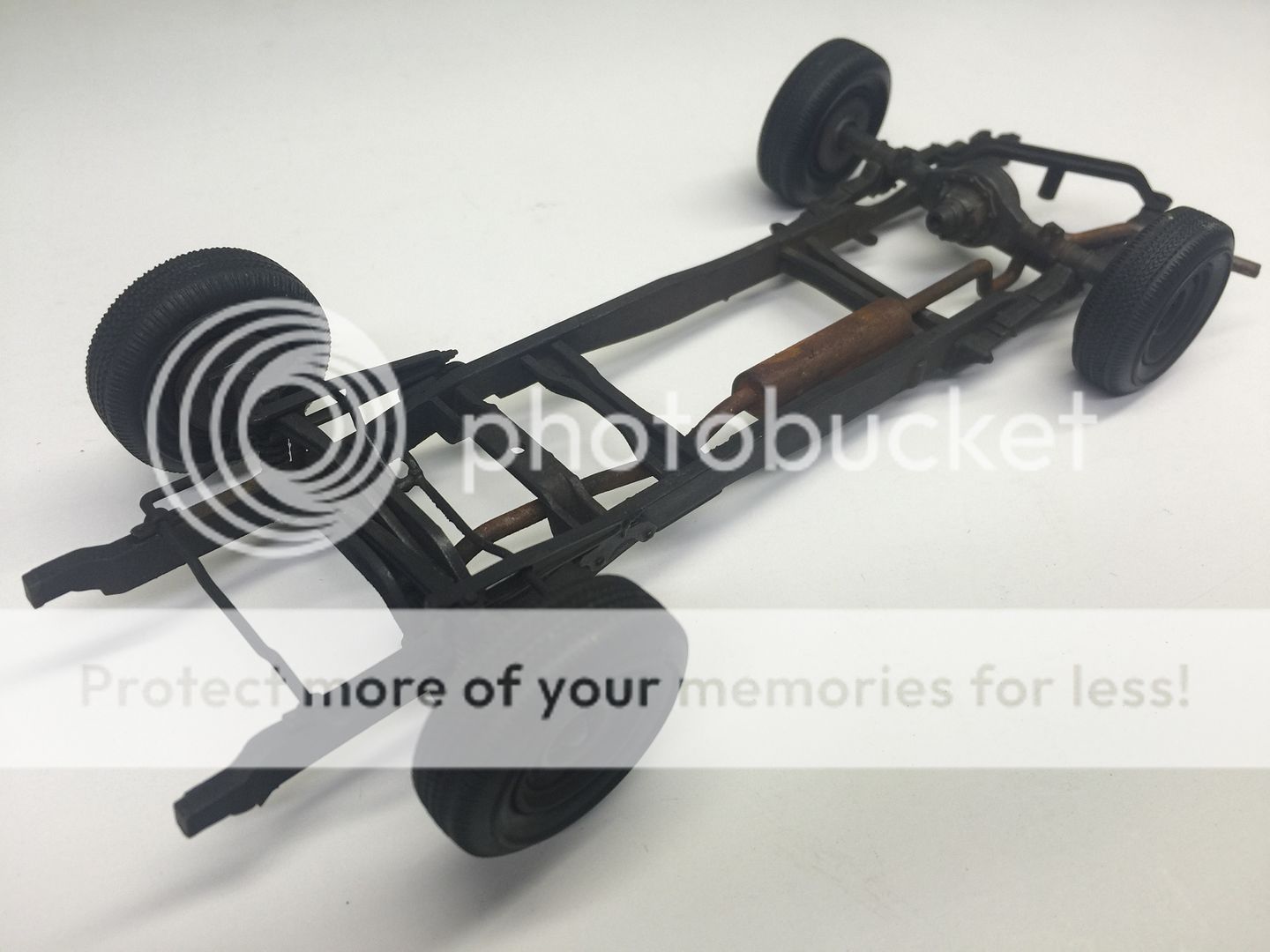

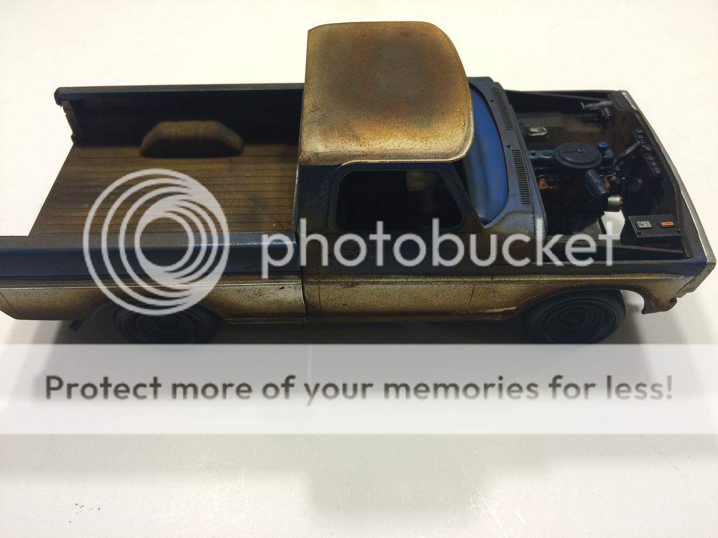

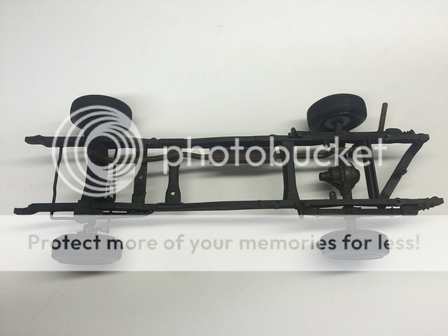

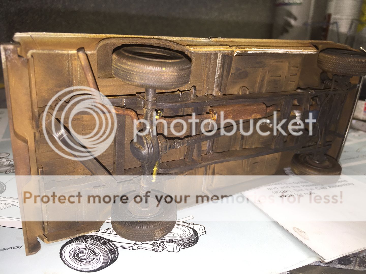

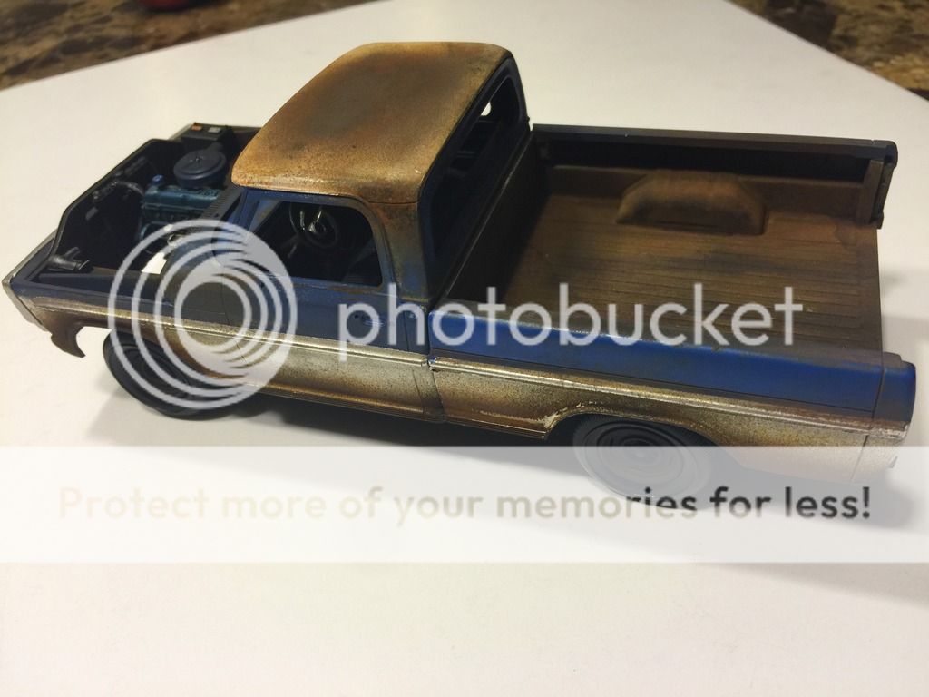

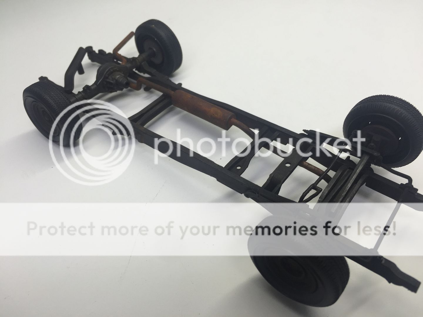

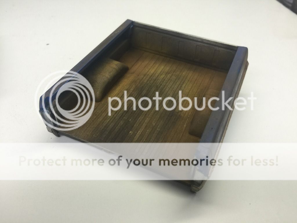

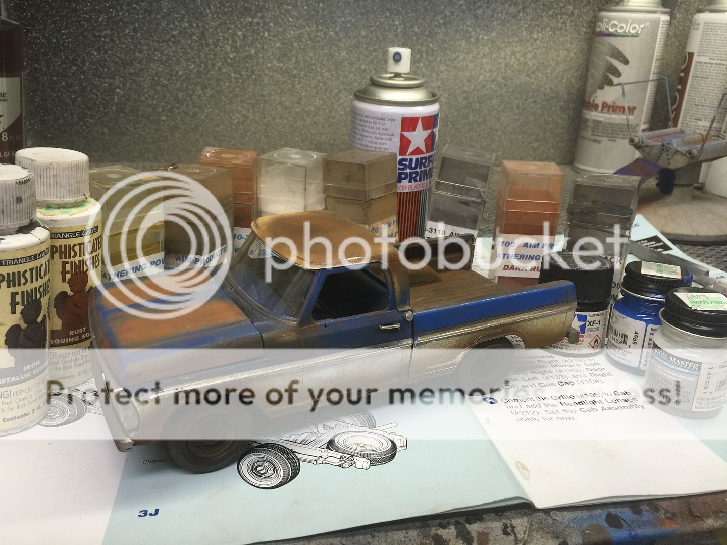

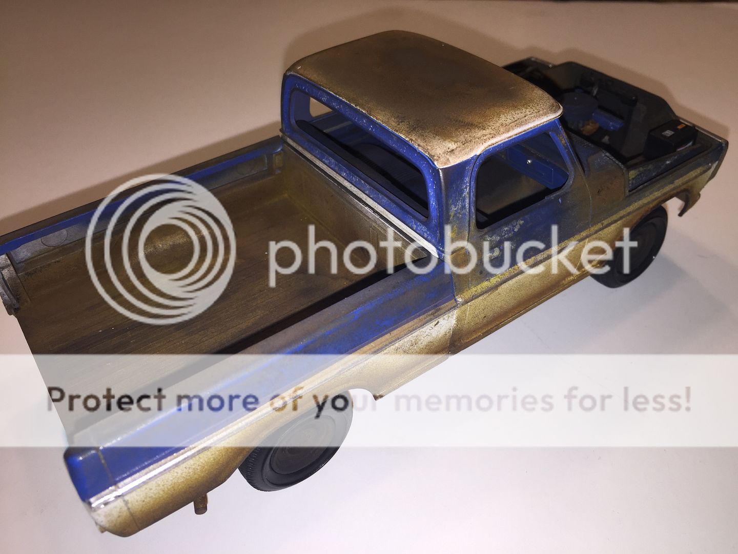

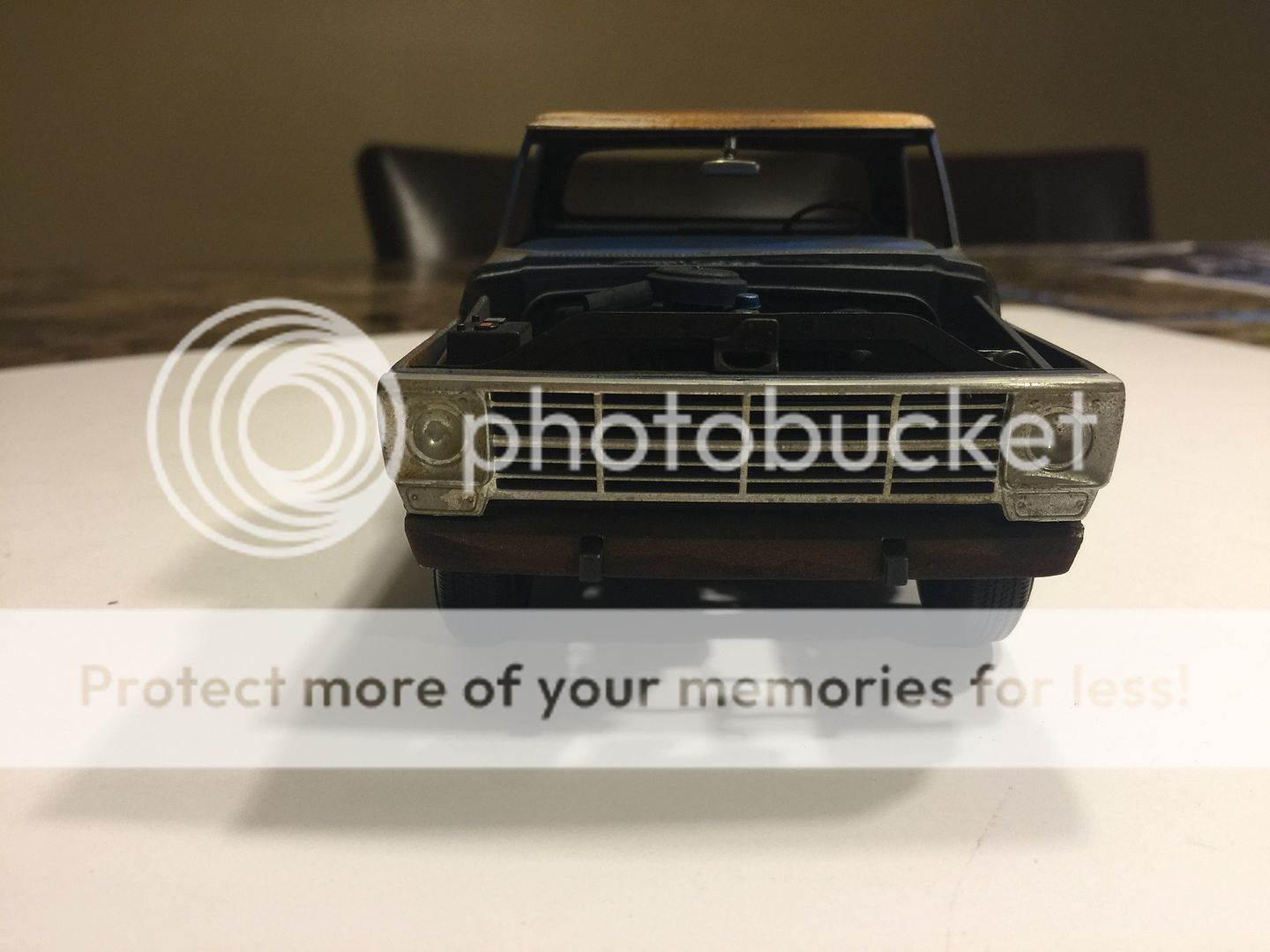

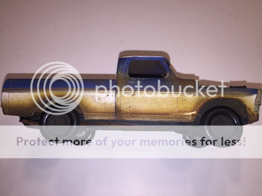

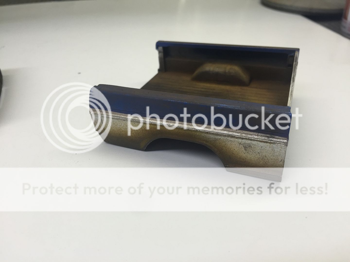

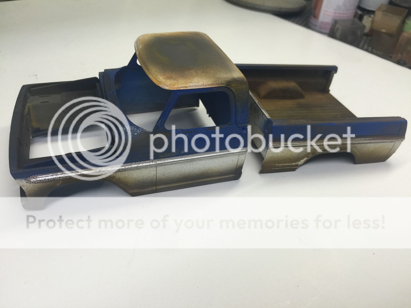

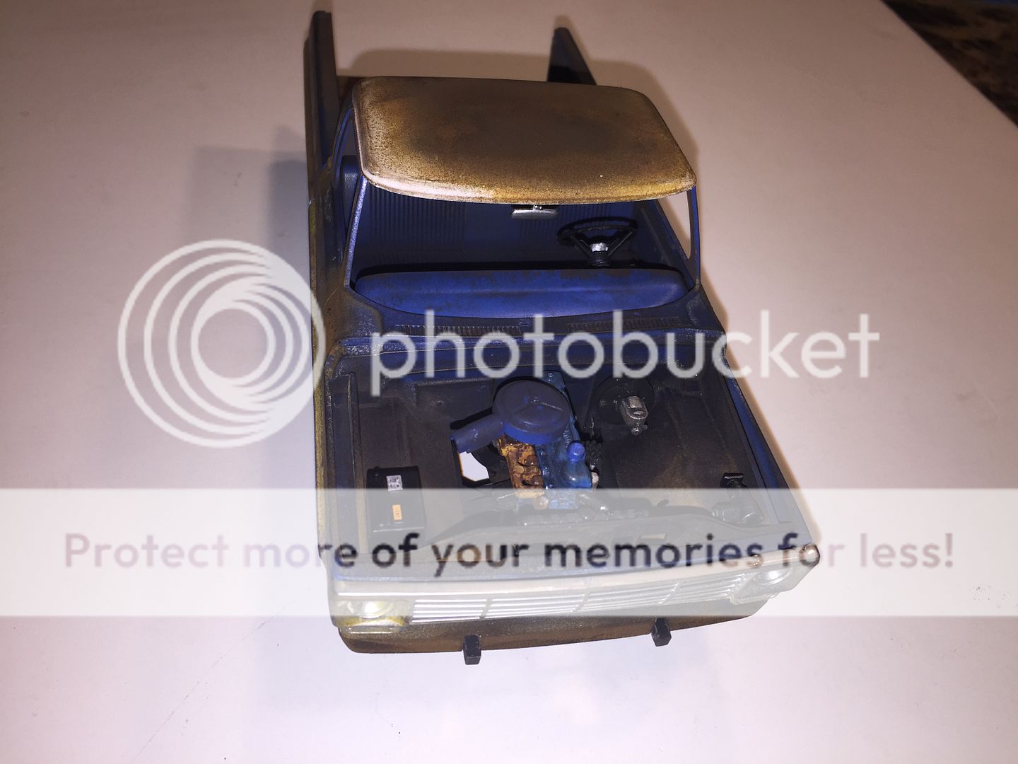

lanesteele240 Posted July 15, 2015 Author Share Posted July 15, 2015 (edited) I have to blend in the middel bottom of the truck to make it look even. Just a little light dust should do it. The outside rust is sophisticated finishes rust system that was air brushed on. The first pics were taken monday. The last pics were taken tue night 24 hrs later. It looks more like rust every hr. I just use water to thin down the grey paint with the iron in it. You will have to fuss with it. It will clogg your gun a zillion times. I then spray the activator over what was painted. Use a resperator when spraying the activator. That stuff will take your breath and not give it back Edited July 15, 2015 by lanesteele240 Quote Link to comment Share on other sites More sharing options...
lanesteele240 Posted July 15, 2015 Author Share Posted July 15, 2015 Nice start Gary, how'd you get the interior so grimy looking? Hey mike. I painted everything in the whole cab the same blue. Then i just dusted the seats with grimmy black weathering dust to pick out the ridges in the seat covers. Then i toned it down by lightly airbrushing some blue back over it. I then dull coated it. The floor was painted black and i kept adding layer after layer of dusts that are diffrent browns. I used some brown paint dry brush on some rust on the dash and added layer after layer of dust and dull coat till it looked dirty. Quote Link to comment Share on other sites More sharing options...

mikemodeler Posted July 15, 2015 Share Posted July 15, 2015 Hey mike. I painted everything in the whole cab the same blue. Then i just dusted the seats with grimmy black weathering dust to pick out the ridges in the seat covers. Then i toned it down by lightly airbrushing some blue back over it. I then dull coated it. The floor was painted black and i kept adding layer after layer of dusts that are diffrent browns. I used some brown paint dry brush on some rust on the dash and added layer after layer of dust and dull coat till it looked dirty. Looking pretty grimy and yet real! Quote Link to comment Share on other sites More sharing options...
Ron Hamilton Posted July 15, 2015 Share Posted July 15, 2015 Wow!!!! That is crusty!!!!! Quote Link to comment Share on other sites More sharing options...
gatorincebu Posted July 15, 2015 Share Posted July 15, 2015 This is a cool build. i love the weathering . Very realistic. Well done! Be Well Gator Quote Link to comment Share on other sites More sharing options...

lanesteele240 Posted July 21, 2015 Author Share Posted July 21, 2015 The next post will in underglass this all the stuff i used in the weathering process. Quote Link to comment Share on other sites More sharing options...
