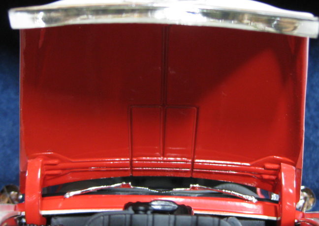

The hood has a cutout option like Ertl had plans for some Hot Rod versions.

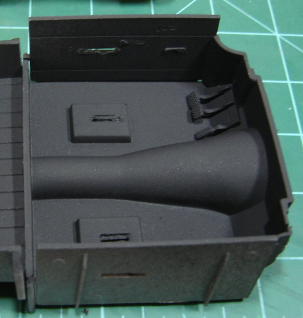

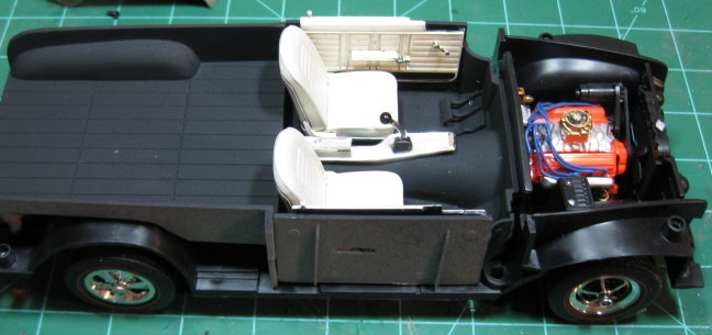

Here is the interior painted with Model Masters texture paint.
Here we have installed the interior from a Highway 61 1967 Olds. The door panel took some trimming. The grey seat is one of the original Chevy seats.

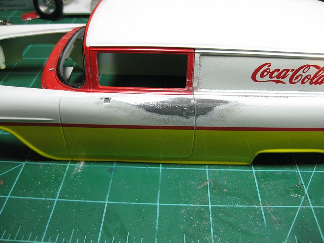

The molded on door handle ground off and paint stripped.

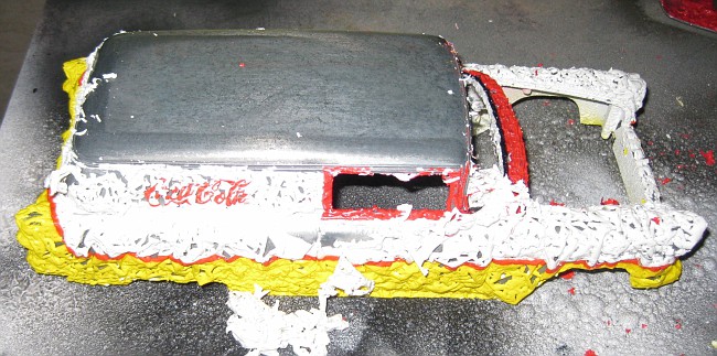

Wow, Tom. That paint stripper looks like it works very well! Nothing left in crevices requiring scraping, or reapplying?
I Look forward to the finished product.:)

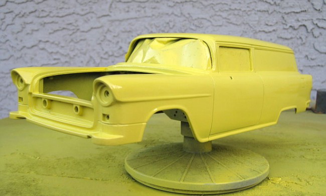

hay tom look at that paint melt lol  cant wait to see what going to do with it

Thanks!
Lance, That was Mar-Hyde Aircraft Paint Remover in a spray can. It was by far the best out there, but It is no longer available. I tried the Aircraft paint remover be Klean-Strip but it does not do well on diecast baked on paint.

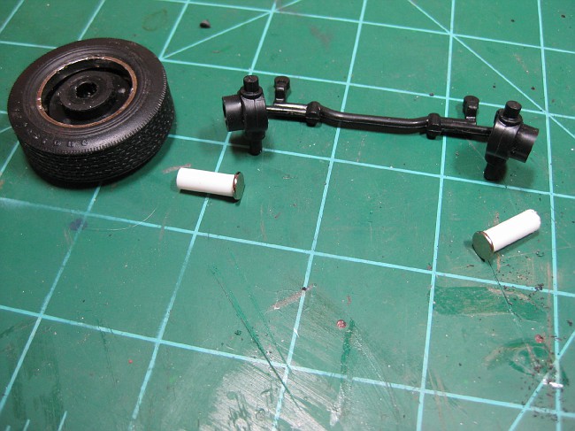

These are 1/8 rivets glued in 1/4 Styrene to adapt the Highway 61 Wheels to the Chevy spindles.
Engine wired and interior fastened to the chassis.

That's what I use, the Aircraft klean Strip paint remover in both spray, and paste form, but I agree, not the same results everytime.
