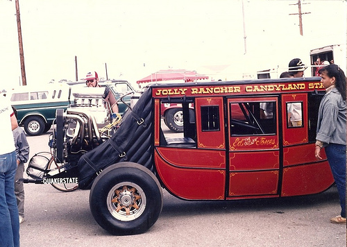

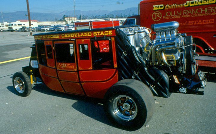

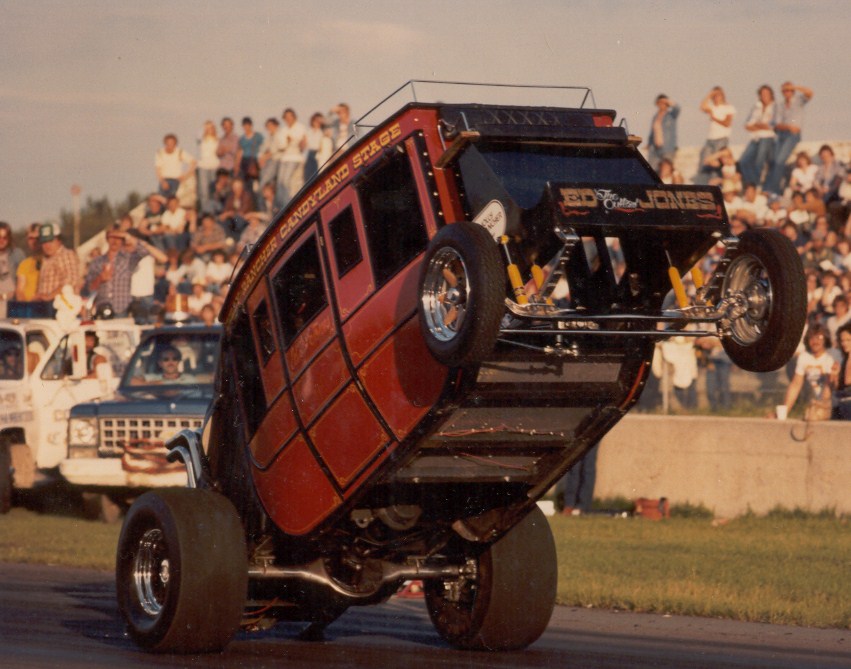

Here is a pic of the Jolly Rancher Wheel Stander:

Here are a few more pics of the Jolly Rancher Wheel Stander:
And here is what it looks like now as the Jelly Belly Wheel Stander

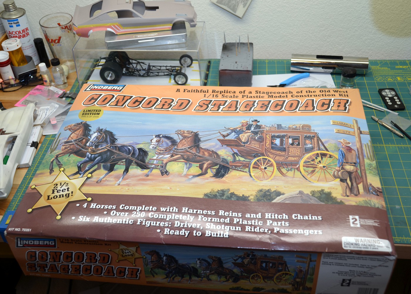

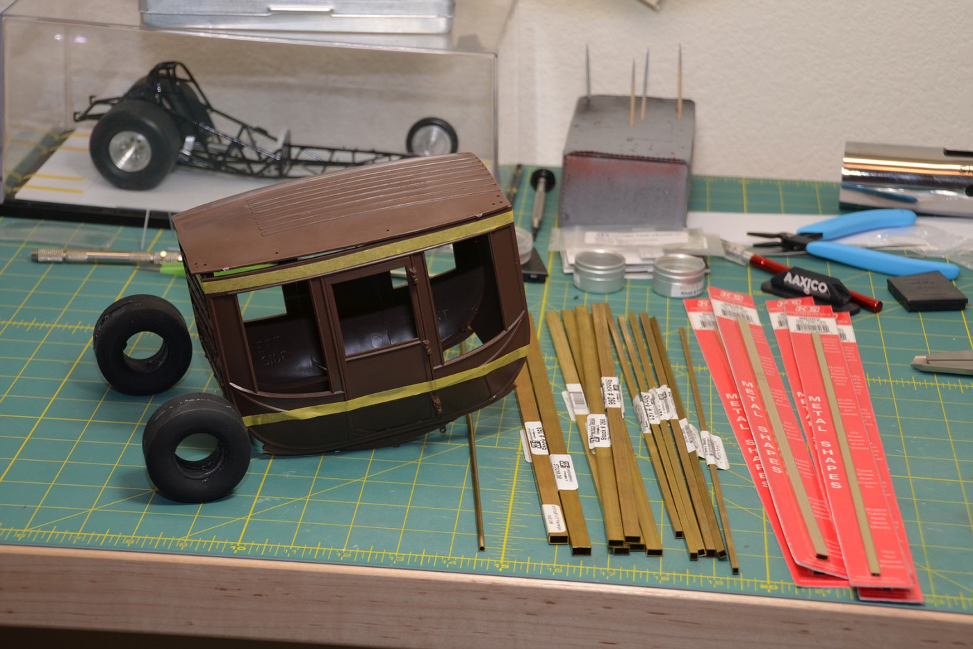

Here is the kit that I got off ebay so I can rob the body from it as a starting point:

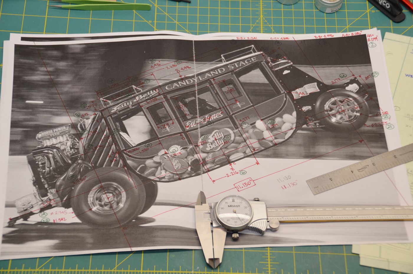

Here I am using a printed out image to get some reference dimensions from. I knew that the wheel base of this vehicle is 119". So I first stated by measuring the distance of the wheel base on the drawing  which is the 11.130 number you see. I then measured all the different things that I wanted measurements for. After getting all of my measurements. I used an equation and did calculations for all of the dimensions to get everything sized to 1/16th scale:
Here you can see all of my mark ups I made when I measured with my calipers and then did the calculations on a separate sheet:
Here is a shot of the Body which is going to get cut up, Chopped, Narrowed.... the whole 9 yeards... lol  As well as some of the Brass material I will be using for the chassis. I have decided that I am going to make the chassis completely out of brass and should be a fun challenge:

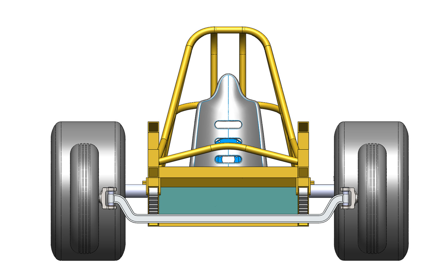

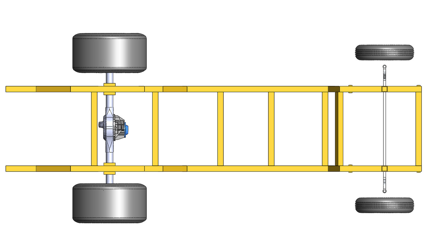

Ok Fellas.... I am sure that everyone has been wondering when I would show some progress on the Vega Funny Car. I have sorta stuck it on the back burner to get some deign work done on this first. I want to show you all some progress on this build. Well its not actual building progress but more of a Design progress. I have been drawing up the frame in my CAD system and I have it at a point where I am willing to share a little bit of the progress. I have got the basic frame design done other than I now need to work on the roll cage of it. But anyway here are some images from the CAD system to share... hope you enjoy....
Edited by Mooneyzs
Share this post
Link to post

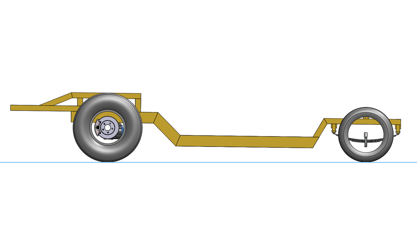

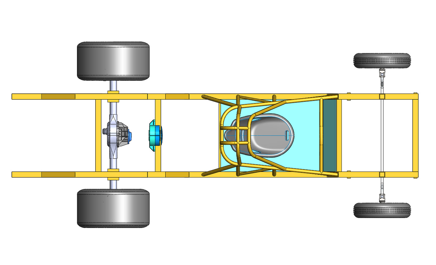

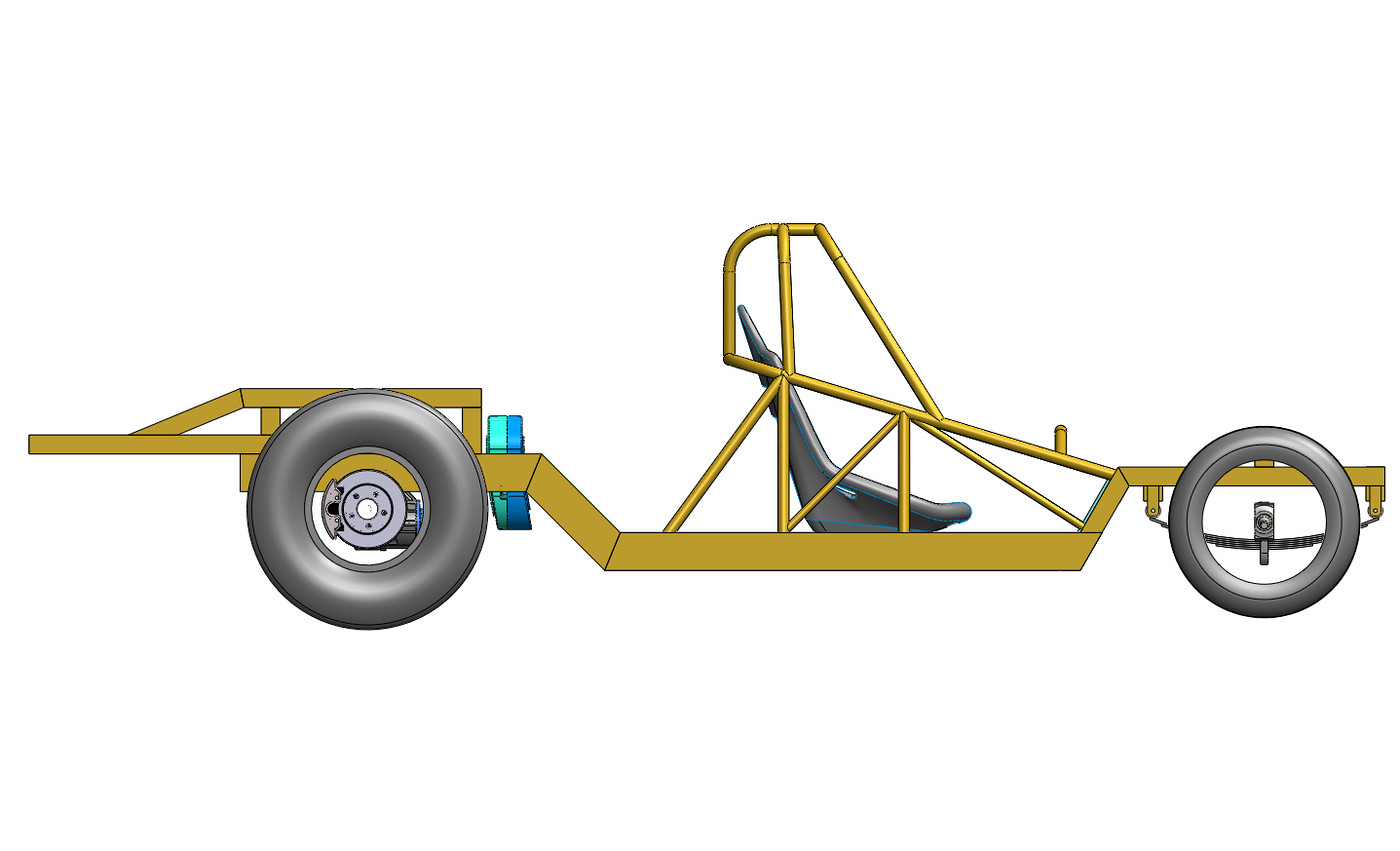

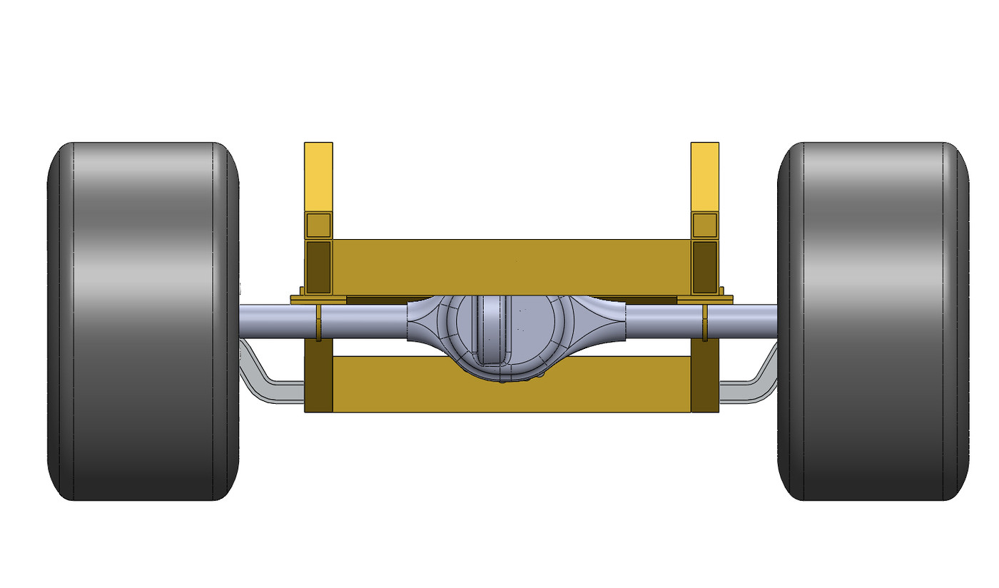

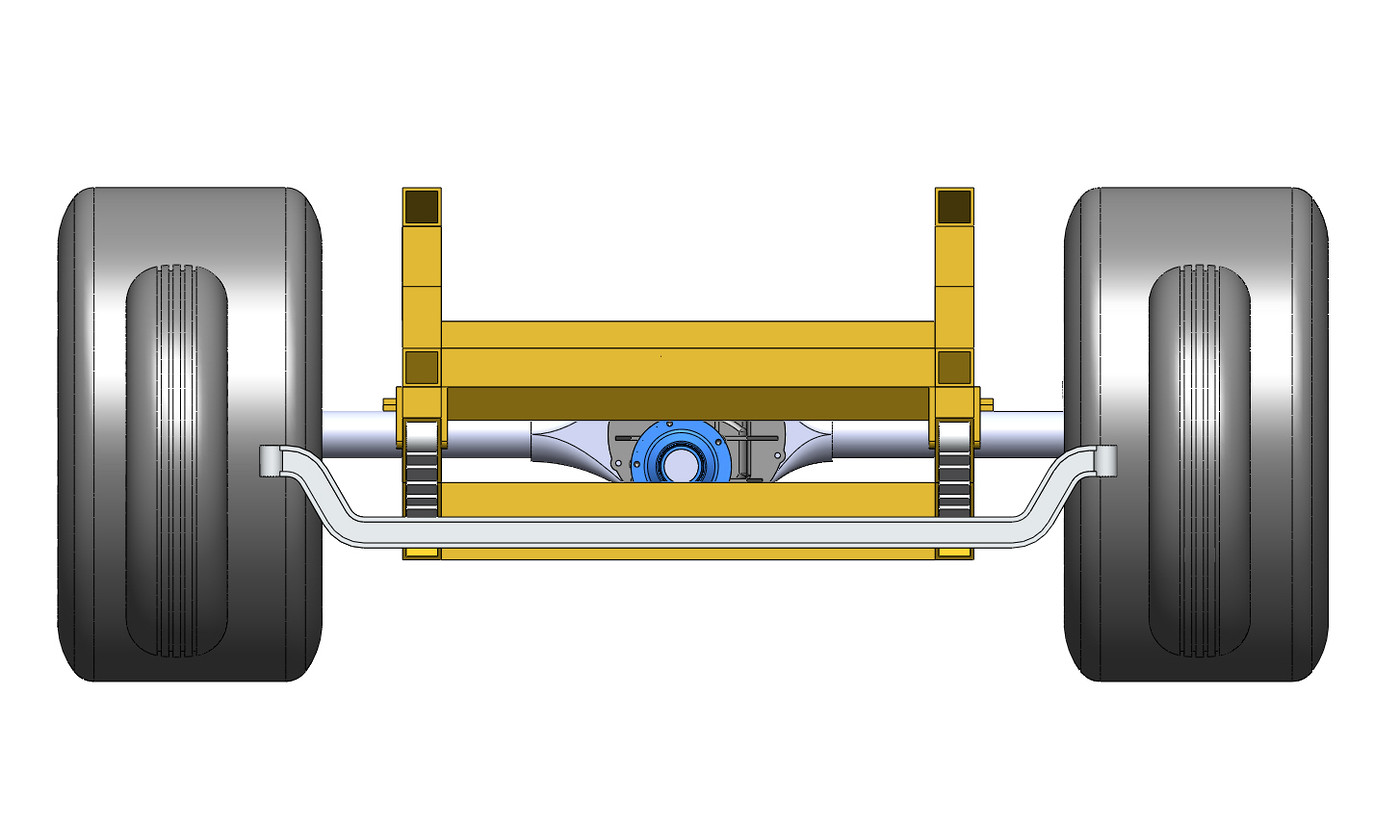

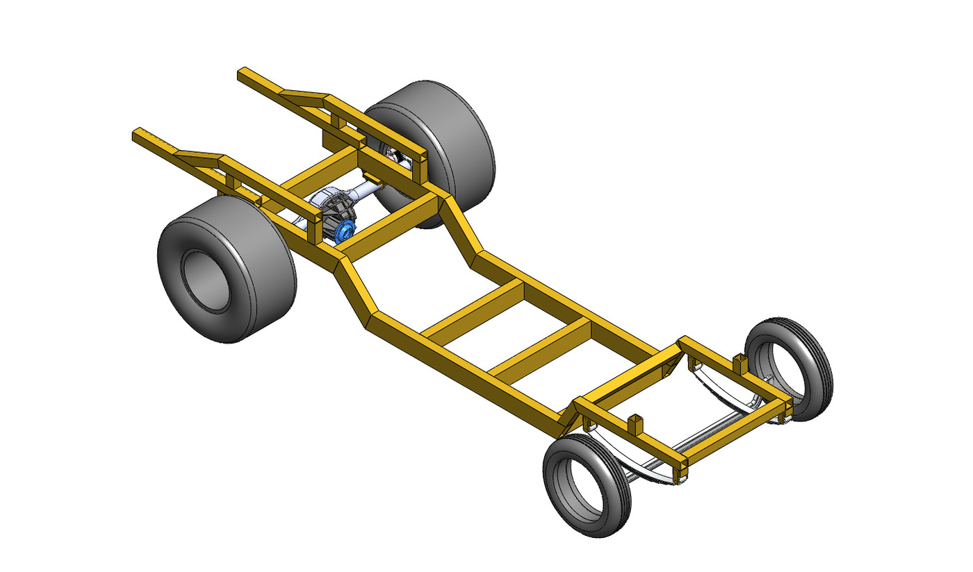

Ok Fellas.... I am sure that everyone has been wondering when I would show some progress on the Vega Funny Car. I have sorta stuck it on the back burner to get some deign work done on this first. I want to show you all some progress on this build. Well its not actual building progress but more of a Design progress. I have been drawing up the frame in my CAD system. I have got the basic frame design done other than I now need to work on the roll cage of it. But anyway here are some images from the CAD system to share... hope you enjoy....
Here is an Isometric view of the chassis:
Here is a Side View:
Top View:
Front View:
Rear View:

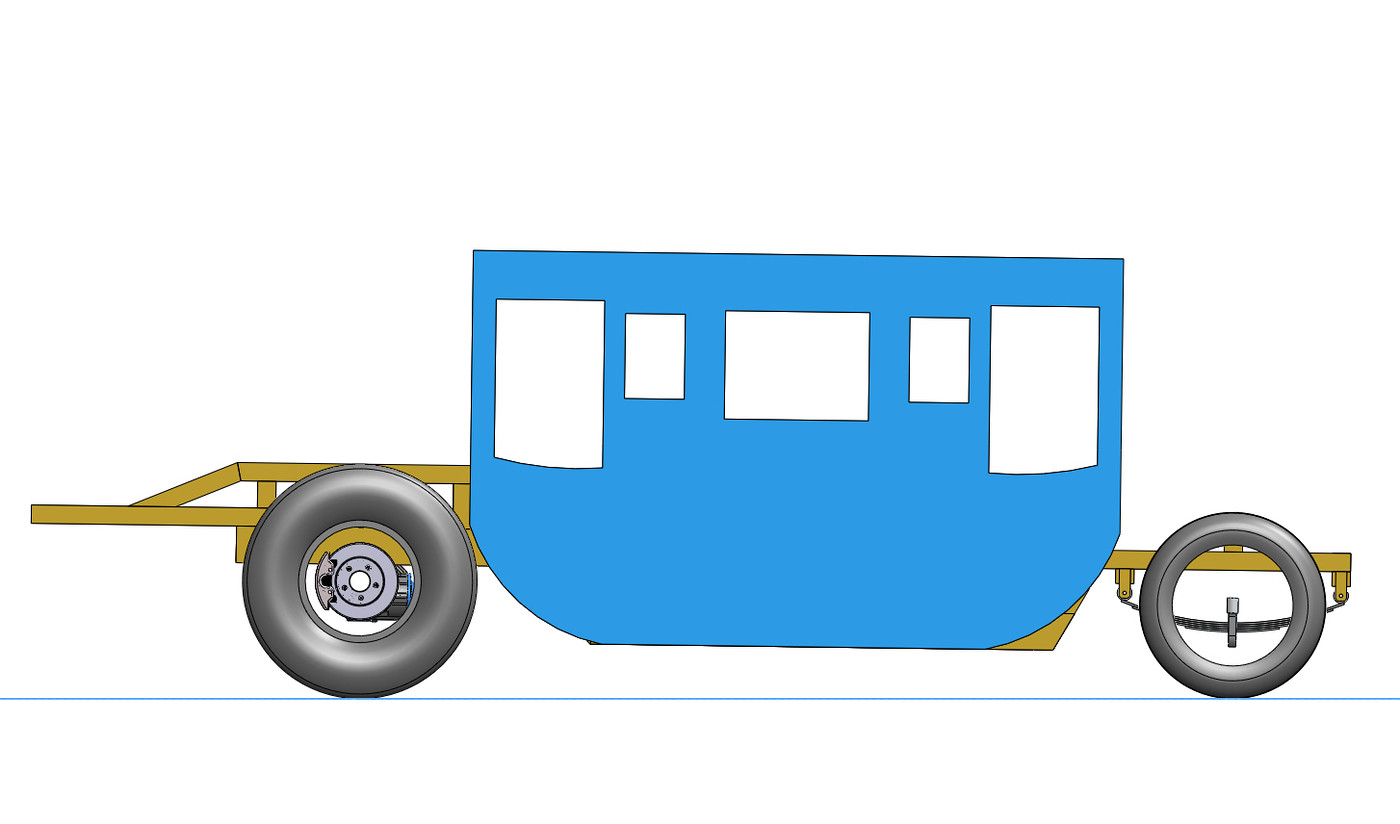

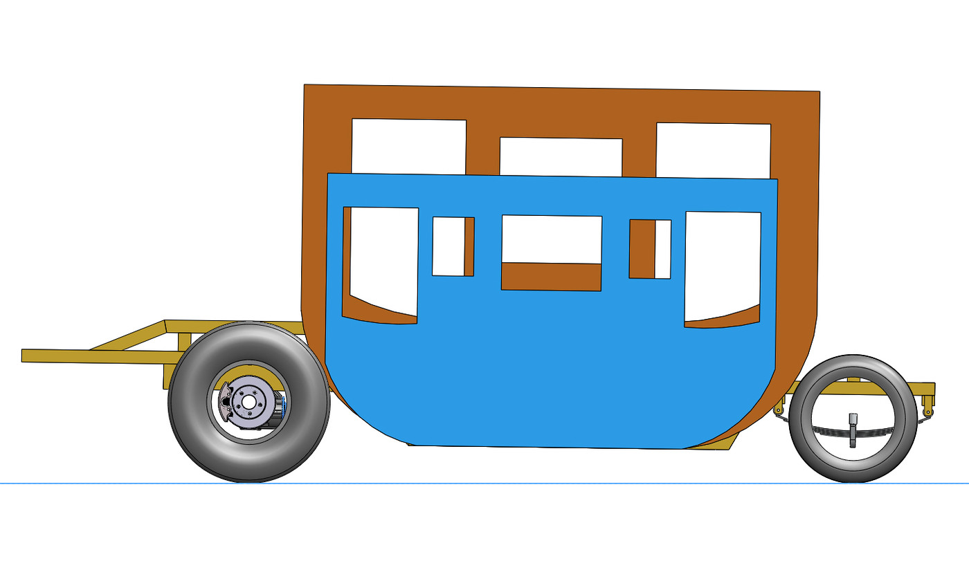

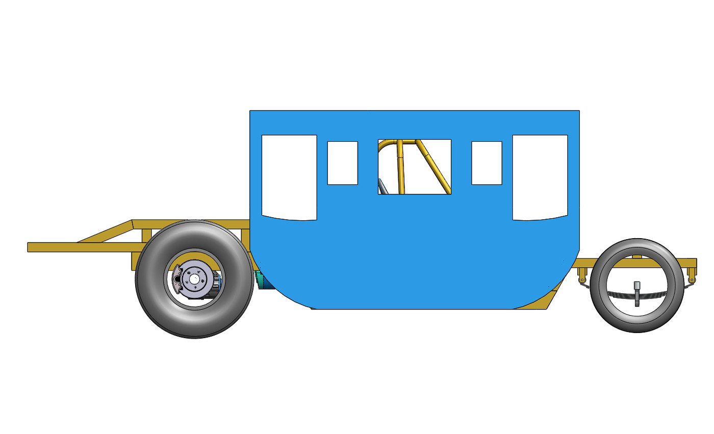

Here is a side view with a ruff shape of the side of the body. What you see in the orange is the side of the stagecoach body that is from the kit. And the Blue is the side of the actual car. So as you can see the body will need to be chopped, sectioned and shorted:
Here it is with just the chopped body:
Edited by Mooneyzs

Welll Fellas... Here is more work on what I got accomplished today. I still have a little more design work I would like to do to the chassis but Here is some updated progress on it.
Here is what I will call a big update with the roll cage, the floor and seat. The seat was a model that I had downloaded from one of my cad sources that I know of where people share their designs and people can download them:
Top view. There is still more work needed to the V-Drive unit that I designed and I need make the mounting bar a little better than what you see here:
Side View:
Front View:
