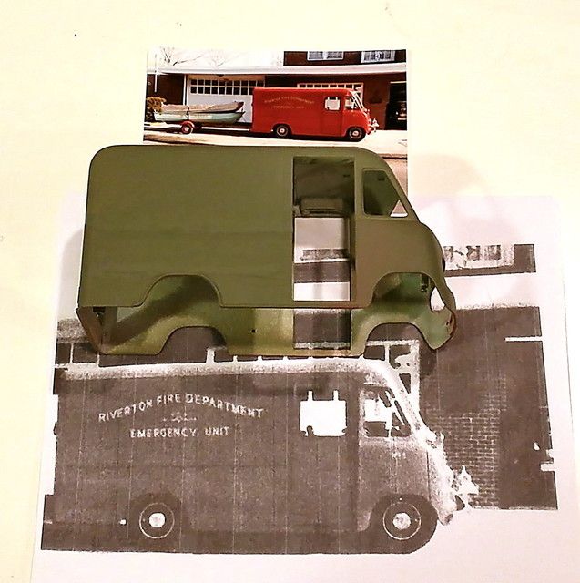

The body was stripped with aircraft stripper.  It made quick work of the paint and was scrubbed with Dawn dish detergent after a thorough washing.  The body was then shot with Duplicolor self etching primer(olive green color).
1438923954_20150710_212108_RichtoneHDR-p

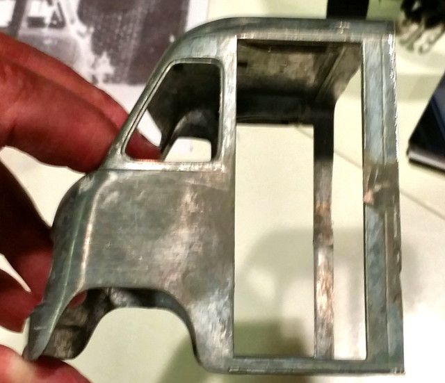

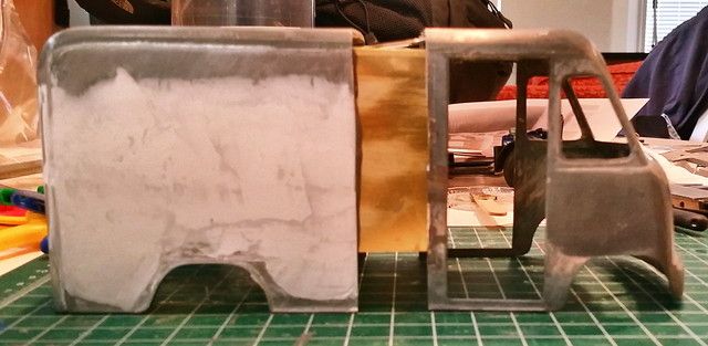

Next came time to cut the body.  Good old Dymo label tape was used to guide the hacksaw blade in cutting the roof and sides of the van.  After that was accomplished, The halves were thoroghly dried,
1438923616_20150712_133337_RichtoneHDR-p

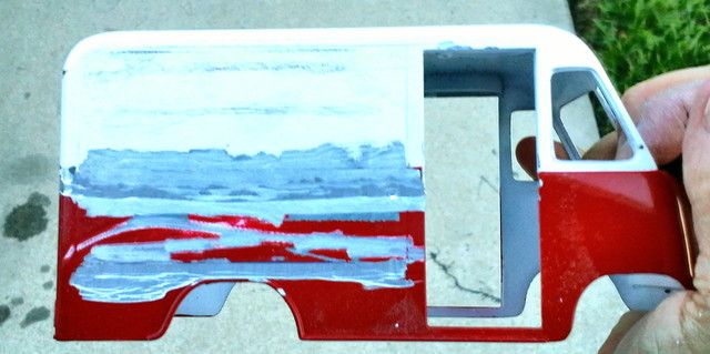

The gap was bridged with brass sheet and secured with JB Weld.  Seams were filled with Evergreen sheet and Perfect Plastic Putty.

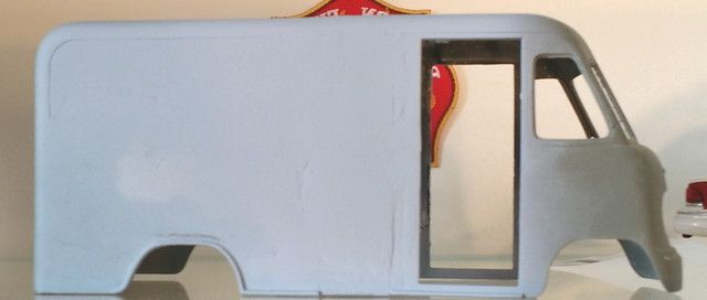

Making some progress on this project!  Fabricated the bottom raised panel with vertical fins to close up the bottom of the grille face.  The diecast comes with this area cut out, so I had to first close up the space with Evergreen strip and putty.  The grille comes from Ken Kitchen at Kitchen Table Resins.  Great quality, fast shipping, and Ken is great to deal with.  The grille did require some modification to fit into the opening.  It was cut, narrowed and glued to a strip of brass to give it strength.  Gaps will be filled in and sanded.
Still challenged by trying to smooth all of the putty and plastic filling the gaps.  The 1:1 truck also had a wide vertical rub rail all around the base.  It is being added with Evergreen strip CA glued in place.  Additional progress not pictured is the floor pan has been cut, and the chassis cut, extended and glued together.  After setting up overnight, I'll take some photos with her up on her wheels.  Lots more to do, but she's getting there.  Thanks for looking!
