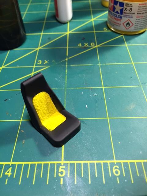

aurfalien Posted August 10, 2015 (edited) Attached is a pic of a seat I had to strip and repaint due to the yellow mishap. Note the black, its 1 coat of the Vallejo Model Color, goes on wonderfully! I'll probaly use Tamiya yellow tonight. Edited August 10, 2015 by aurfalien Quote Share this post Link to post Share on other sites
MsDano85gt Posted August 10, 2015 i thought you were talking about the Rock band velejo lol Quote Share this post Link to post Share on other sites
aurfalien Posted August 10, 2015 (edited) Thanks MsDano. Below is a pic of Taimya + yellow embossing powder. I still have to shake off the excess and will wait a bit, but I've found a bad paint job won't be covered up by powder. The Tamiya went on better. Edited August 10, 2015 by aurfalien Quote Share this post Link to post Share on other sites
