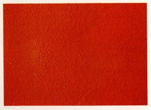

i
i came d across a good reference online , and this is how the model looked in yellow paint.pimples, but not so extreme
Edited by ERIK88

"And I know for a fact that some paints (particularly automotive paints) were not made to be heat-dried"
This is news to me. Can you give a source for this? Body shop suppliers sell and promote many kinds of driers( Heat lamps etc) for speeding the curing of paint work. Time is money in body shops, Anyone here work in body repair daily have any comments on this?
Thanks
Share this post
Link to post
I've been in and out of the bodyshop business for over 40 years...mostly high-end collision and restoration work where quality was the most important goal...and your assertion that "time is money" in the biz, and that materials are developed specifically to speed the process is right on.
HOWEVER, only a fool in the biz fails to read and go by the specific TDS for any given material (technical data sheet). Expecting one to behave like another you may be used to is just plain stupid, and certain to kill your profits.
Specific materials require specific handling and techniques, and making generalizations isn't smart or helpful.
NOTE: The OP's reference photo looks rather like "solvent popping", where solvents (the thinner in paint, NOT the propellant) is trapped under a too-quickly-dried surface from...surprise...forcing heat on paint before it's sufficiently gassed out, or from piling on successive coats before the underlying coats are sufficiently dry. As the surface is hard and impermeable to solvent vapor, the solvent still tries to get out. It forms little blisters or bubbles during its escape.
It's a model. No angry client or insurance company is bugging you to get it done faster. But if you screw it up, you'll still do it over again for free.
Don't rush it.
