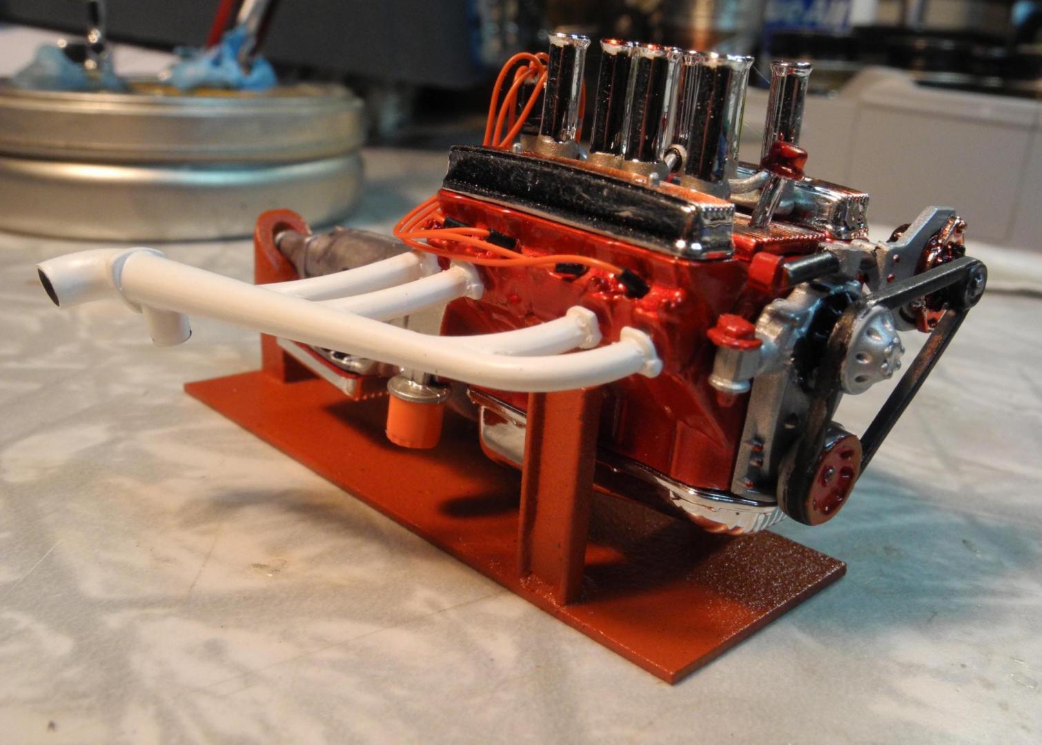

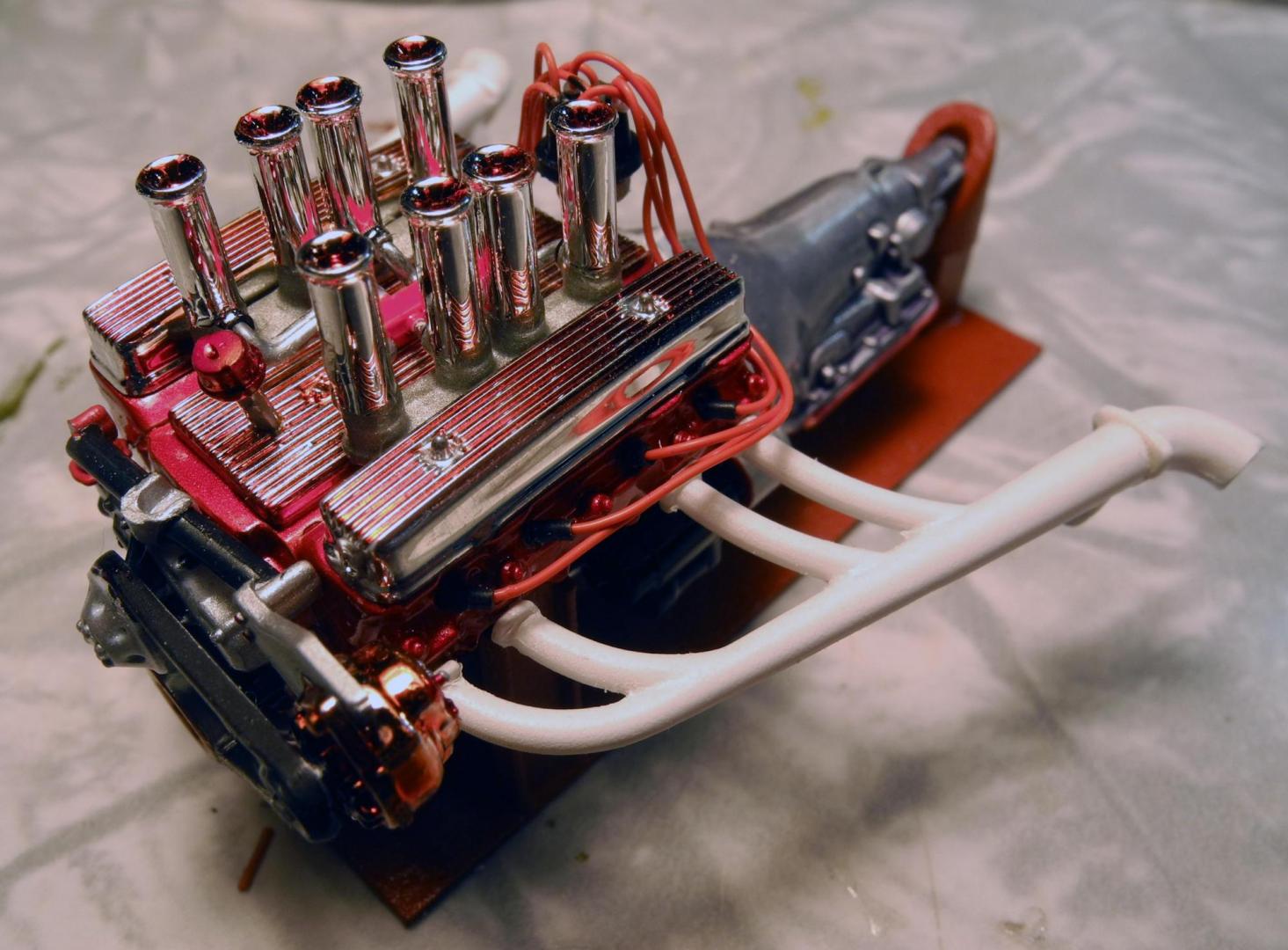

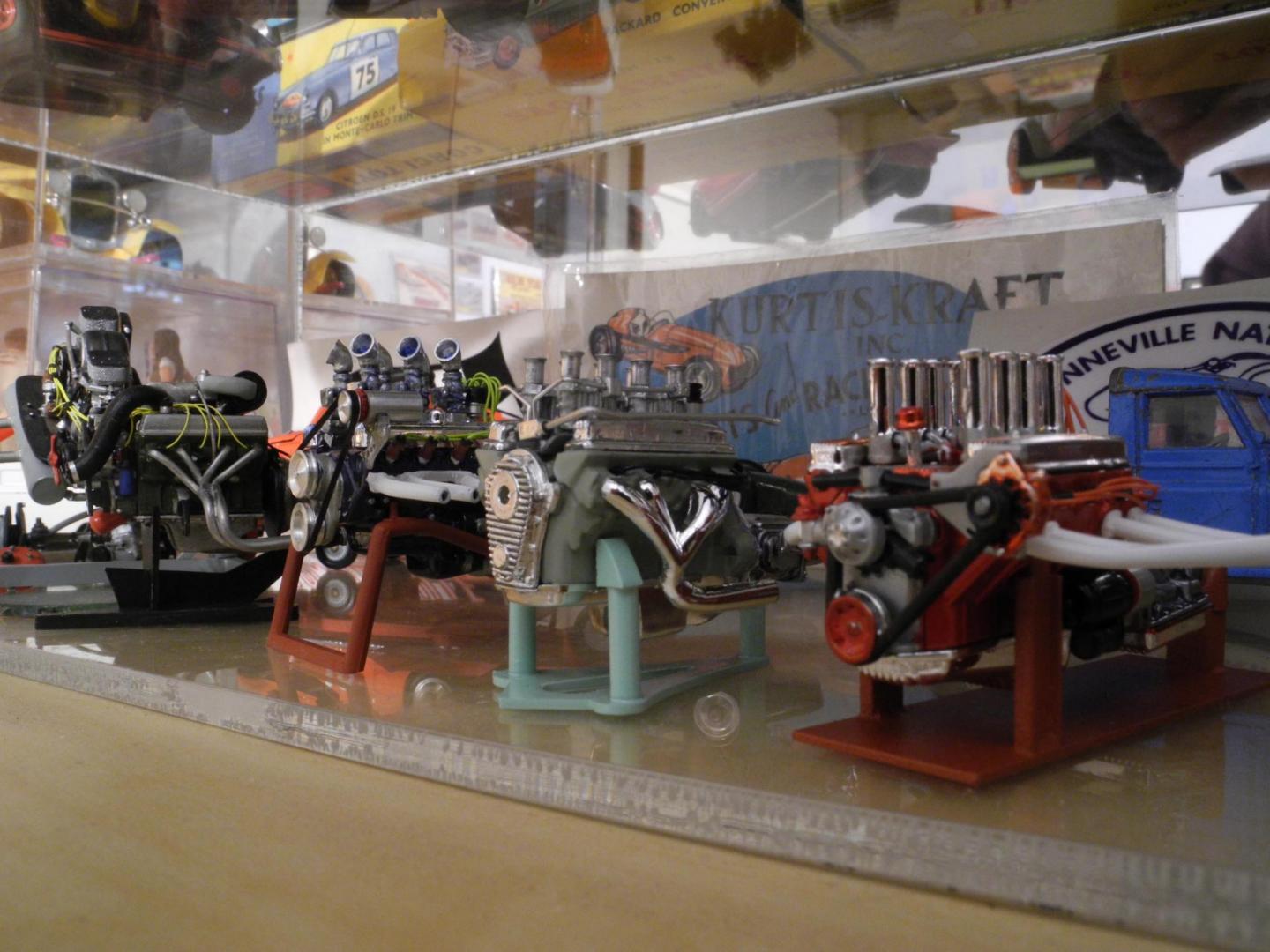

here it is finished posed on a stand I built for it. very nice little engine. next up is a 409 with a Latham supercharger set up. see pic below
building little projects like this help keep me interested.
jb

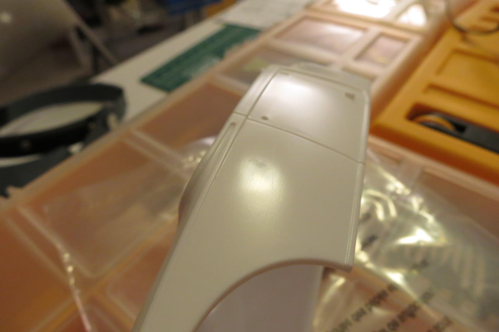

I have spent several hours pouring over this thread, and I appreciate all of the suggestions about rake, engines, and using other bodies.
I looked at using the Revell 31 Model A sedan body from the 3-set Hot Rod kit. May need some work to fit, especially since the body is a bit warped.
But my biggest complaint in comparing the bodies, was I found that mym body had "serious" flaws on each side, just rear of the doors, slightly lower than the door handle. Did anyone else have these same flaws, as it looks like I will have to use some Tamiya white putty on it to fix it up. Not sure my pick "really" shows it well, but look at your bodies and let me know if I am alone in this, and have the only blemished body.29Blemish.thumb.JPG.1e3c6c5c749b70f19b42This side is the worst of the two.

I have purchased about ten of these kits now, and have opened the bodies on four of them.  One of them had a similar type of depression to yours on each side, one worse than the other, but neither as prominent as the one you show here.  In both cases, I was able to file/sand it out without using body putty.  You can see the result in the gray/green '32 Ford Highboy pictures posted above.  Other bodies I have looked at have either no depressions, or much less obvious ones.  If you look at the backside of the body, you can see that there are small feed tags - this is where the styrene is inserted into the body mold.  The depression on the outside is an artifact of that.
The first kit I got (the same one described above) also had some minor sink marks in the Deuce frame rails - the left side worse than the right side. In both cases, they were sandable without putty.  Other kits purchased later that I have looked at, have no discernible flaws in the Deuce frame rails.  .
TIM
Link to comment
Thanks for the feedback. I will try my best to work out the issue, but there seemed to be little rise to take away in order to level out the depression.
I guess at worst, It'll be my first "RAT ROD" body works......
