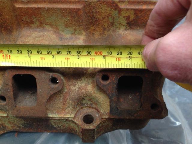

59 Buick Posted August 23, 2015 Share Posted August 23, 2015 (edited) It's great to see this kit, thanks for the hard work to date Tim and your patience in getting it from drawing to production. Can't wait to see what the aftermarket companies produce to support this kit. Here you go, measurements off a 1959 364 c.i. Nailhead , these were taken free hand using a metal tape and phone camera. Happy to use a steel rule if you need more accurate measurement. spacing between 1st and 4th port centres 17 inches Edited August 23, 2015 by 59 Buick Quote Link to comment Share on other sites More sharing options...

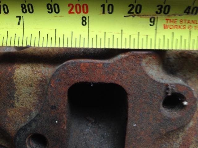

59 Buick Posted August 23, 2015 Share Posted August 23, 2015 (edited) Spacing between 2nd and 3rd ports 8 3/16 inches8 Edited August 23, 2015 by 59 Buick Quote Link to comment Share on other sites More sharing options...

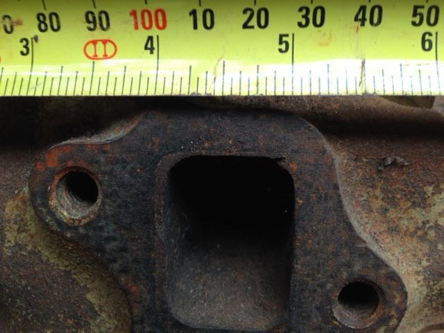

59 Buick Posted August 23, 2015 Share Posted August 23, 2015 (edited) Spacing between 1st and 2nd ports 4 1/2 inches Edited August 23, 2015 by 59 Buick Quote Link to comment Share on other sites More sharing options...
